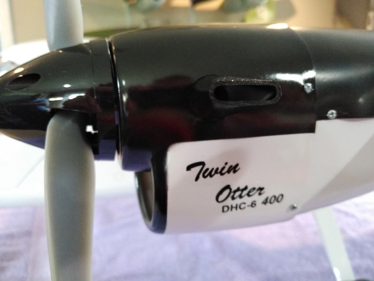

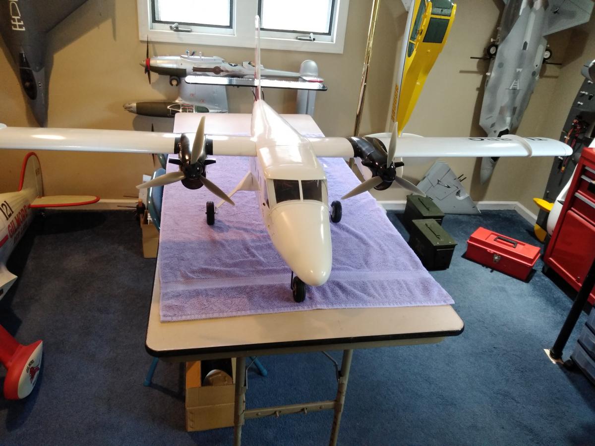

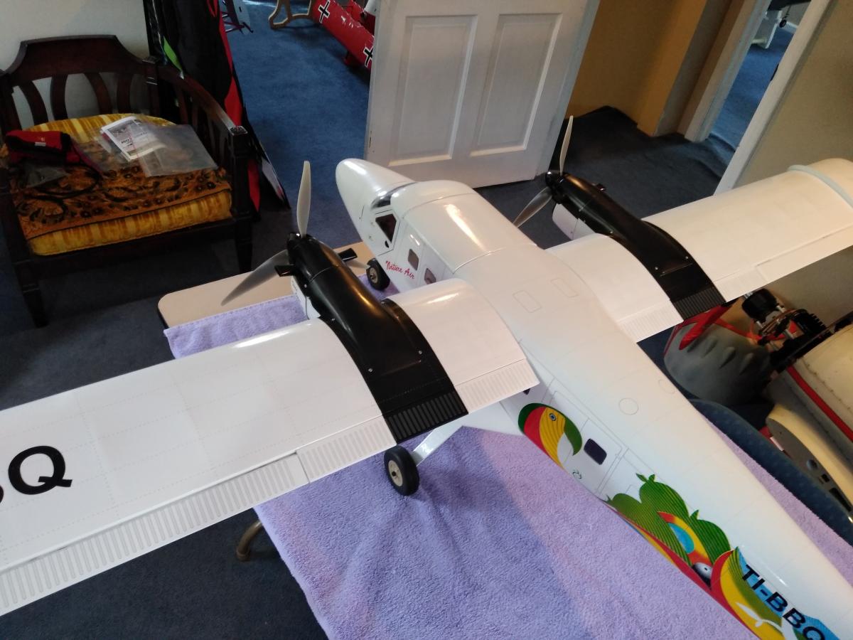

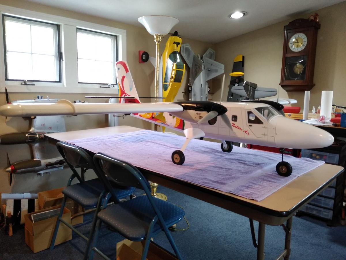

    It's good to see these come to Motion RC. My wife just finished her Nature Air version of this bird. We are still waiting for weather to improve to get the maiden done.
    She went with the Flightline P-38 upgrade 880kv motors on 4S, turning APC 11x7 3-blade props, and Du-Bro 2" 3-blade spinners. She opted to run both motors CCW. She's using the ZTW 65A ESCs with Castle cap pacs soldered in. To make wing the hook-up simpler, she installed Electro-Dynamic 3 servo multi-connectors in each wing. Otherwise pretty much stock.
    Are there many, or any differences between the VQ and Nexa branded versions? Click image for larger version

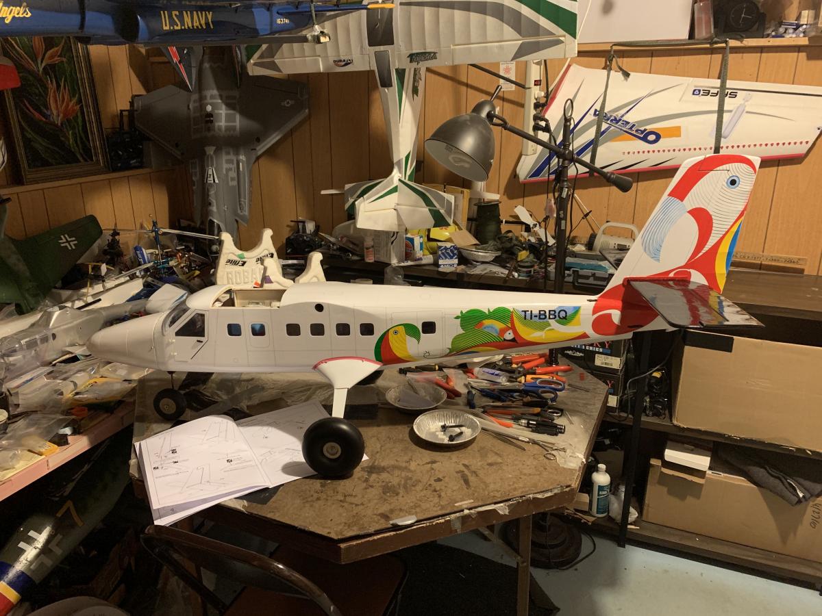

      @Twowingtj Very nice! Yours looks nearly the same as mine, except mine uses the big, spongy tires from the HobbyKing Tundra and one of the stock mains as the nose tire. Alpha asked me how I powered mine in another thread. I'm using the same prop and motors from the Avios Albatross but with 80A ESCs.
      https://hobbyking.com/en_us/avios-al...___store=en_us
      850kv motors running on two 3000mah, 4s Graphenes. Props - counter rotating 10x6 3-blade. Even though my TO weighs over a kilo more than the Albatross, it doesn't have to overcome the friction of skidding along the ground to take off, it's got plenty of power to get up and go. In the air, the TO doesn't seem any slower than the Albatross.
      I would have gotten the Canadian version for sure if it was available from HobbyKing at the time. There's a company based in Victoria, Canada that still makes brand new Twin Otters today.
      I may have Callie Graphics make me up a couple of "Margueritaville" decals for mine.

        Looks good xviper. If the Nexa is as good or better than the VQ, it will be a good addition to the MRC line-up.

          I have a feeling they are the same plane. The specs for wingspan for each is slightly different but I believe one or the other is a misprint. Next time I have mine put together, I'll take a measurement of the wingspan. As most people already know, the HobbyKing product was actually a "VQ Model". The HobbyKing product has been on "back order" almost forever and I doubt they will ever bring it back. VQ Warbirds also lists it but they too, are "out of stock" and I don't think they'll ever get it back either. Nevertheless, the Motion offering is an exceptional value and I have no doubt that it will be a quality item. If I ever sell mine or crash it, I'll buy this one. I'm so confident that this plane and ours are the same that I can say it'll fly pretty the same. I posted up a video in the HobbyKing Twin Otter thread if you want to see how it flies.

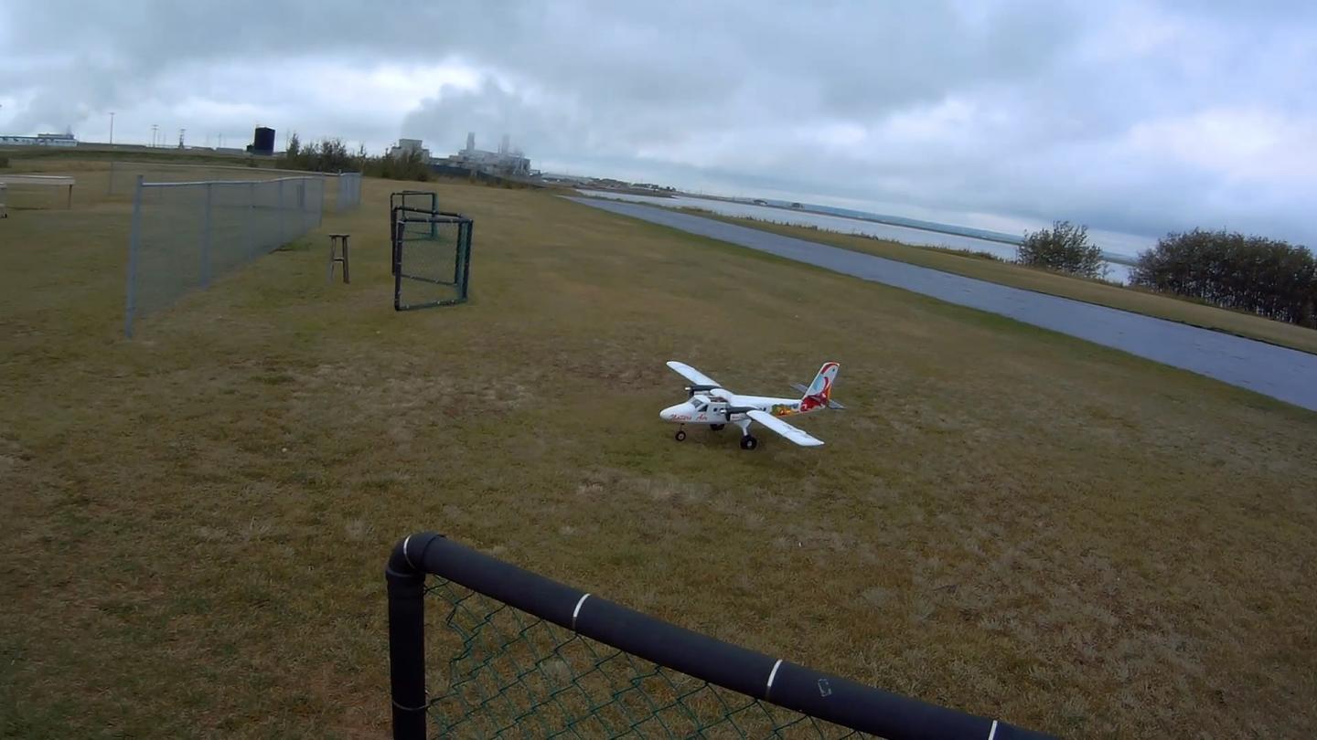

                                      As this is the same plane as the VQ Twin Otter "Nature Air" version, it's been done. I use 2 Graphenes, which are about the same size and weight as non-graphene 4000, 4s. I stack them one on top of the other "longitudinally", but staggered. In order to balance the plane, one has to be slid underneath the pilot seat, leaving about 2/3rds of it sticking out behind the seat. The second battery goes on top (with some non-slip matting in between) and the rear of it hangs past the end of the bottom battery. A fairly long velcro is needed to hold it in place. Depending on how you built yours and the motors and ESCs you use, you may be able to use a single large 4s battery or put the two 4000's side by side with a bit tucked under the seat.
