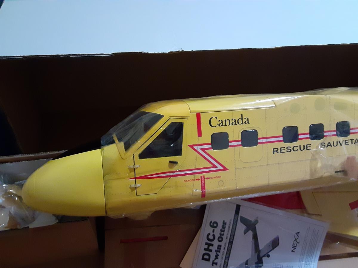

          Click image for larger version  Name:	20211223_233906.jpg Views:	0 Size:	78.3 KB ID:	333160 The nose and engine nacelles are a very different color yellow than the aircraft. Did anyone repaint these parts, with what color yellow?
            That’s weird. Take a part of the plane that’s the right color to your local Home Depot and have them color match it. I have the tropical theme, so the plane is mostly white and the nose and engine nacelles were a good match.

              I may return this bird. I pulled all the parts out to inspect and the coloring on it all is whack. So many different colors of yellow going on here. and none of them match each other. I dont want to spend more money to correct what should be correct in the first place. I wrote a ticket to them on this so I will see if we can work it out but this is disappointing..
                It sure is. I hope you get a satisfactory resolution to this. I don't mind doing a few "tweaks" to any model, but this would be very annoying and unacceptable. I'm wondering if this whole pandemic thing caused a disruption in the paint batches being used to paint different parts in different places in the assembly process. Motion should inspect all shipments of these sorts of kits before sending them out.

                  I could go down to space age paints to have a spray can made up. Its $25 for 5oz of paint. Did this with my Kuluka AL37. Repaint all the parts, they dont match anyway. Landing gear, antennas, windscreen, nacelles, and nose. I will have to sit on this a few days. Like the aircraft but my disappointment is high right now. Maybe a few beers will help.

                    That is odd. I took the aircraft out into my living room and the color is not as bad. My room lighting makes this look horrible. Its still off but not that bad. So i will keep it.
