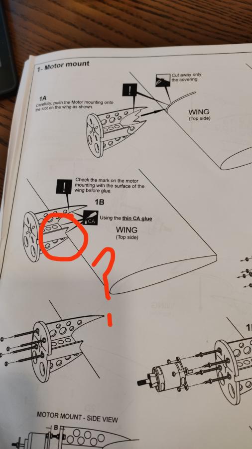

              Hi, I am looking for some helpful advice on how to build my Next twin otter, Canada version.
              This is my first time of building ARF kits of balsa model, so please forgive me if I ask obviously dumb questions!
              I am reading the instruction manual now. I have the below questions:
              1. on fiugure 1B, I need to attach the motor mount to the wing. One thing I am not sure: the wing itself is covered by film. There are two places where CA glue are called. One place is the slot, where a cut-away slot is already made. So here CA is for wood-to-wood contact, I get that. But the place where the mount meets the front edge of the wing, that is where I amn't sure. The wing is covered, so I need to cut away flim here? Or directly apply CA to the contact between motor mount and wing?
              2. there are no places in the manual showing how to route wires. For the motor has three thick wires, plus ESC, so what do I do with them? I think I need to cut a hole underneath the wing, and route wired thry wing. Is that true I have to cut the wing?
              Thank you so much!
                • 8758
                #147
                That whole area where the motor mount goes against the wing will be covered by plastic shrouds, so it doesn't matter how much of the covering you cut away. The part the just rests up against the leading edge of the wing acts as a guide but you can wick in some CA if you want to. The idea is to put the motor mount into the slots and get it all lined up the way you like, THEN wick in the CA glue.

                  #148
                  The routing of the wires is something you must be somewhat inventive about and yes, you must cut holes in the wing where the wires will come out. You need to "fish" them through with a wire or some string. Go take a look at all the "photos" (link near top of this page). Some of the pics will give you some ideas about what needs to be done.
                  xviper, thank you!
