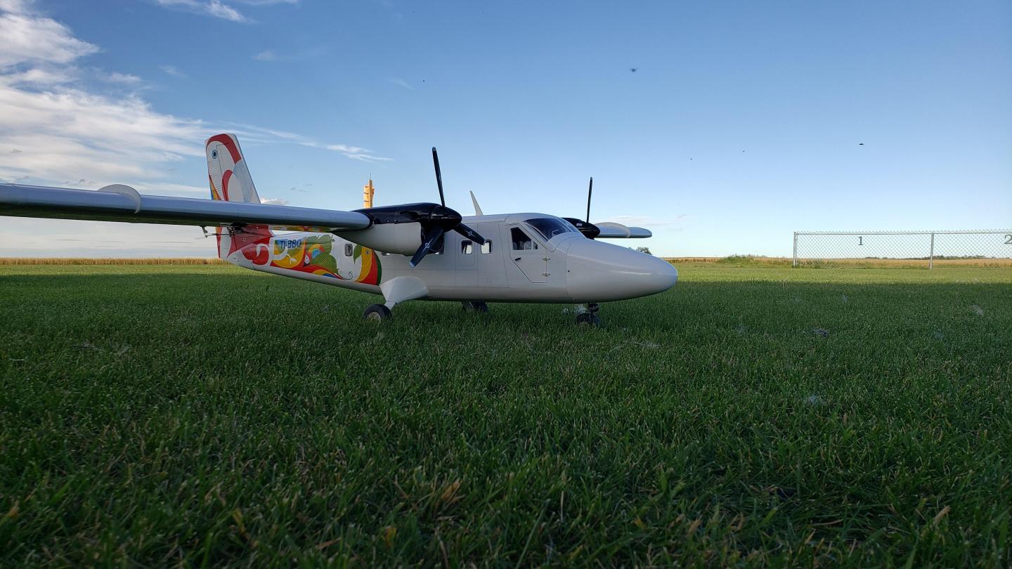

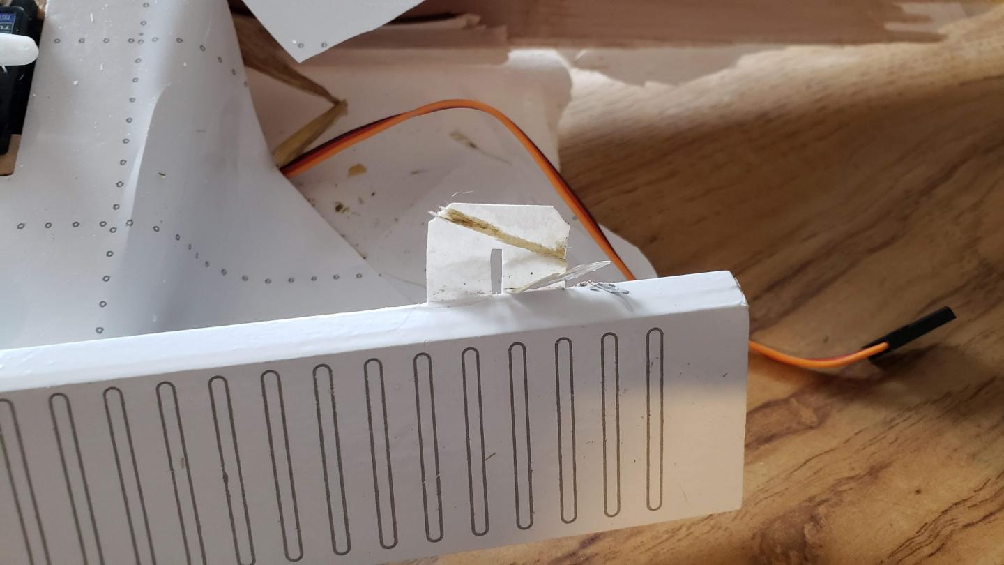

        I had one of these from Hobby King. I shortened the gear to make it stand lower, and mine had a tendency to roll to the left. I thought I had it beat, but on the 2nd flight, it became uncontrollable. Post crash investigation saw the aileron hinges, which had been torn out, had a very thin strip of balsa still attached. I'm thinking that they were working themselves out in flight and thus causing the increasingly uncontrollable left turn.
        I will get another as I did like this plane, but check those hinges! Do a good pull test and make sure they are well seated after the first few flights.
        I also mounted the ESCs on the bottom of the wing, so that the surface of the ESC was flush with the wing surface, at the root by the fuse so the leads to the motor were short as possible, and they would recieve adequate cooling.

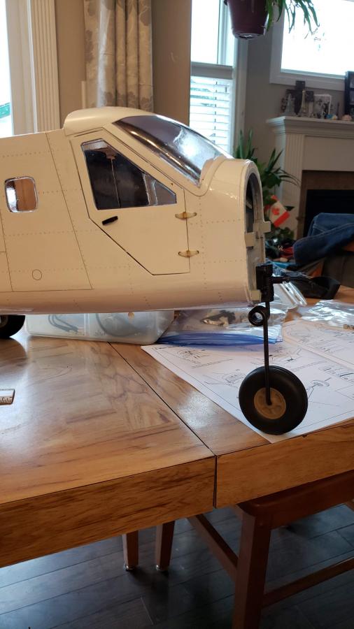

          Here's the before and after of the gear shortening. I think it looks much more realistic sitting closer to the ground.

              One of the post crash aileron hinges, note the very tiny area where the glue actually attached.

                Before the fatal day, it looked really nice.
