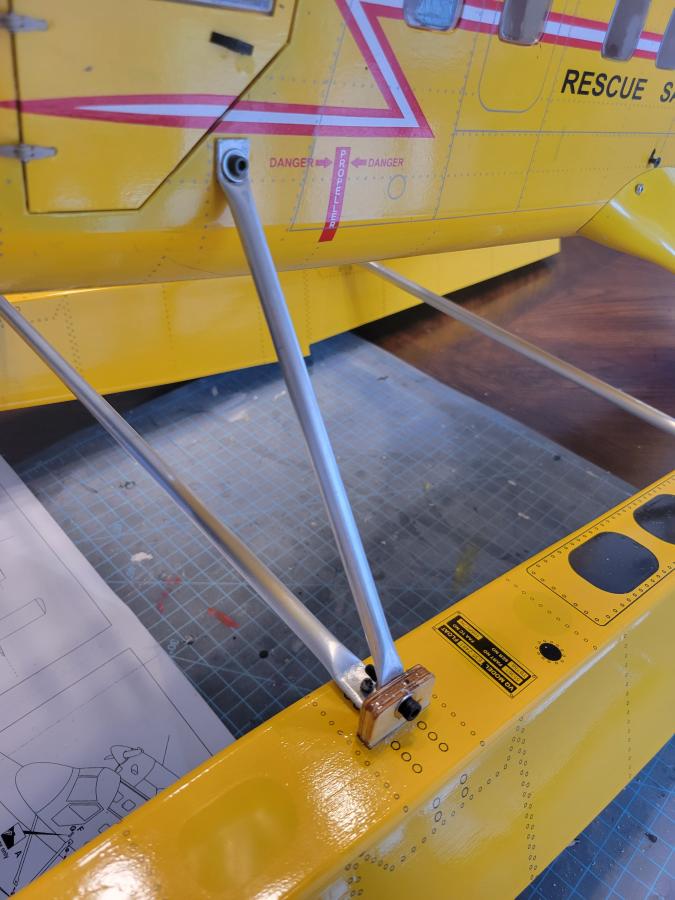

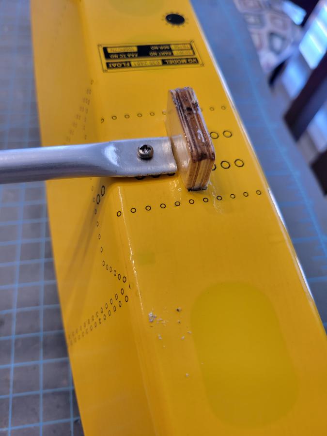

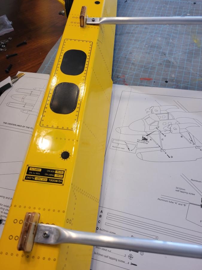

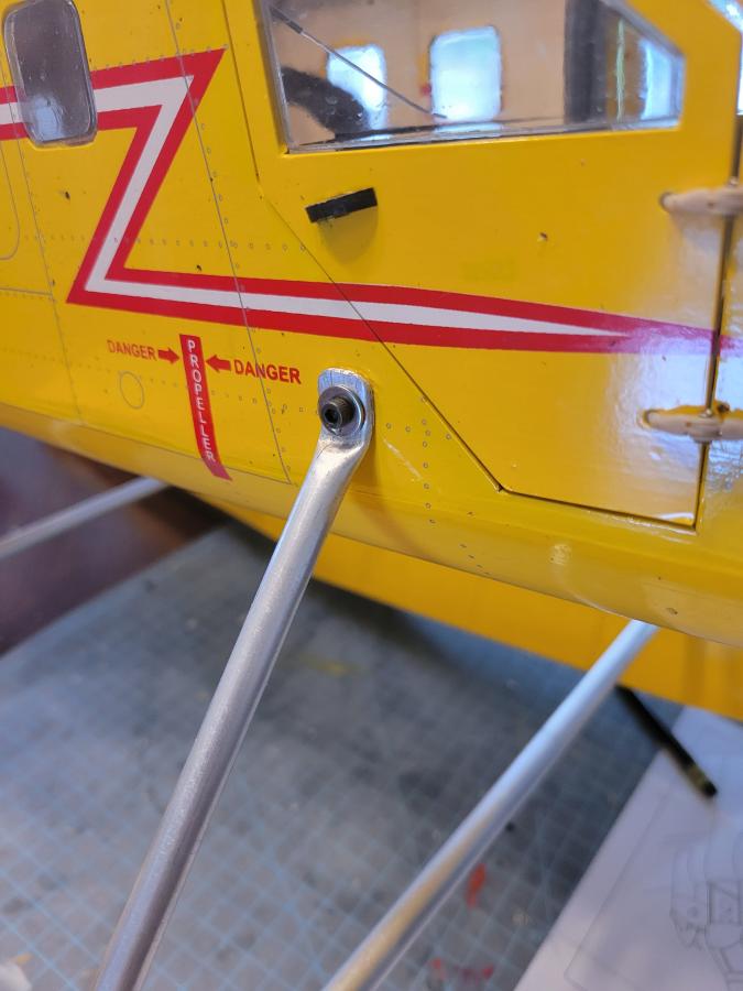

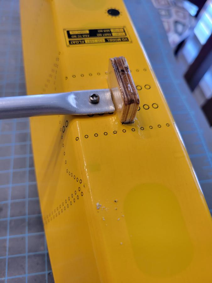

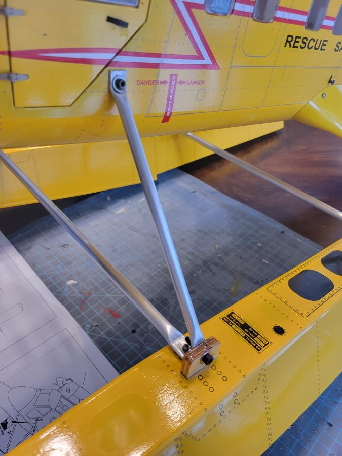

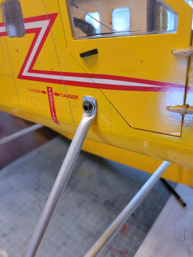

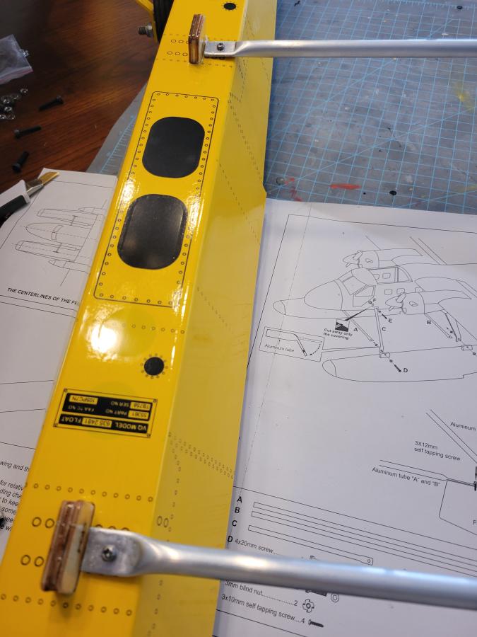

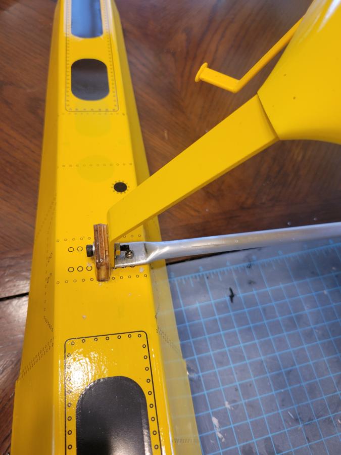

                        Click image for larger version  Name:	20240515_132614.jpg Views:	0 Size:	43.5 KB ID:	403371 Click image for larger version  Name:	20240515_132640.jpg Views:	0 Size:	71.7 KB ID:	403372 Click image for larger version  Name:	20240515_143436.jpg Views:	0 Size:	57.2 KB ID:	403373 Click image for larger version  Name:	20240515_143530.jpg Views:	0 Size:	73.9 KB ID:	403374 Click image for larger version  Name:	20240515_132614.jpg Views:	0 Size:	43.5 KB ID:	403359 Click image for larger version  Name:	20240515_132640.jpg Views:	0 Size:	71.7 KB ID:	403360 Click image for larger version  Name:	20240515_143436.jpg Views:	0 Size:	57.2 KB ID:	403362 Click image for larger version  Name:	20240515_143530.jpg Views:	0 Size:	73.9 KB ID:	403363 Click image for larger version  Name:	20240515_143516.jpg Views:	0 Size:	61.7 KB ID:	403364 I just started assembling the floats for the Twin Otter, so I can fly it on the lake tomorrow and Friday at Joe Nall. I was a bit surprised when looking at the 4 aluminum supports, and then page 3 of the instructions. These ARE NOT plug and play! For some odd reason, Nexta makes you flatten the ends of the round aluminum float supports that connect the floats together (about 2 CM) and then drill the holes for the self-tapping screws that connect them to the top of the floats.. Okay, that's not too bad, just squeezing them flat in a vice and drilling small holes., no biggie.
                        The 2 aluminum struts that connect to the fuselage are a bit more challenging These two supports are flattened on one end, but not the other end, so you will have to flatten the one end, but then you need to bend the ends to the correct angle to connect to the fuselage and then the end that connects to the float. I guess my issue is why Nexta puts the burden on the end-user to correctly flatten the ends of the tubes, drill the holes, and then bend the ends to the correct angle. One wrong measurement or bend, then it won't be symmetrical. I called MotionRC this morning to ensure I was reading this correctly, and they said that's just how Nexta does it.

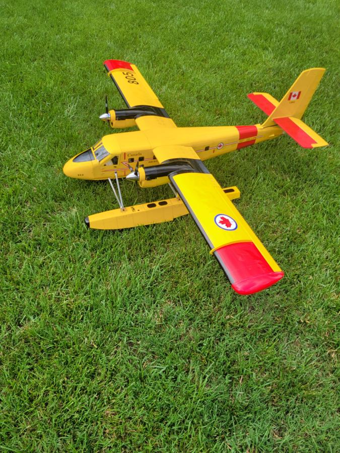

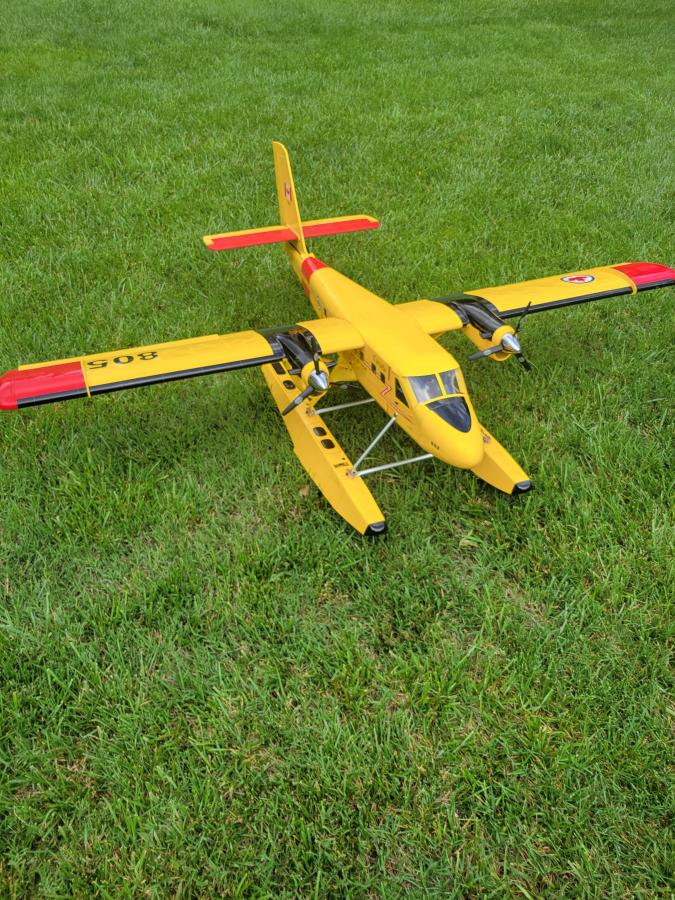

                              I found out how to program the differential thrust, and it works perfectly! Unfortunately, a few months ago I was doing a nice big loop and while inverted at the 11:00 position, the magnets on the left motor broke lose and it went into an unrecoverable spin. I had to wait a few months before the ARF kits came back in stock and I just put it together This time, I put Eflite Power 25 motors and 60A Avian ESC's in it. I got 3 flights into it so far and all seems good! I fly it on two 3700mAh 4S batteries in parallel.
