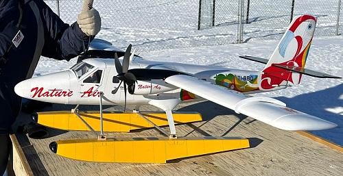

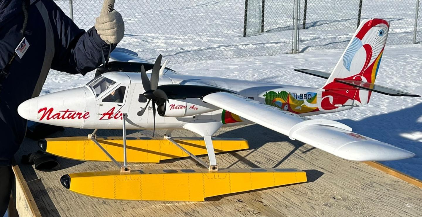

        Agree with Evan regarding the RX. If you insist on using that AR620, then do a really good range check from every possible direction. IE, with the TX being ~100' from the plane and with someone holding the plane and turning the plane 360* (right side up and on its nose) while all the sticks are worked. Make sure your assistant is mindful of the propellers. Depending on if your flying site has any dead zones due to proximity to high power lines or other forms of interference, I prefer to use a RX that can accommodate a satellite RX as well, with at least one antenna going to the outside of the plane. On mine, I have one antenna sticking straight out the top at rear of the battery hatch.
        Since my last post here, I have converted mine to 6s, using the 5-blade Scimitar props from the Eflite EC1500. I run a single 500mah, 6s LiPo. I also have differential thrust as I fly this plane only in winter off snow/ice and have floats.
        Insofar as the throws are concerned, my % may not mean much for your application but I'll tell you anyway. It all depends on which hole in the servo arm you are using and which hole in the control surface arm you are using. This plane is quite heavy for its size and roll authority can be sluggish, so I maxed out my AIL throws to 125%, 30% expo. Elevator is at 100%, 30% expo. RUD is 125%, 30% expo. You can choose lower rates for your mid to low switch positions. For flaps, I've also maxed those out for landing flaps at 100% and a bit of ELE compensation at 10%. Go half that for take off flaps and 5% ELE comp. Note that this plane really does NOT require flaps for take off or landing. Using flaps for landing requires some finessing of the throttle during final.

                • This thread spans 5 years and even my own tastes and flying style has changed with this plane. When it was on 4s, it was more than adequate and very satisfactory. However, as I started to fly more powerful planes and EDFs, I flew this plane more aggressively. Even then, it was "OK" on 4s. When I decided to keep it for good and fly it mainly in winter on snow/ice, I converted it to 6s and added counter-rotating 5-blade Scimitar props from the Eflite EC1500, along with differential thrust. With floats, it is very "sporty" and the diff. thrust is needed for turning on snow.
                  As a balsa "kit", it is within the realm and responsibility of the owner to survey every aspect of this plane and determine where and in what way to complete the assembly the best way possible. Insofar as the hatch is concerned, I used additional rare earth magnets to make for better contact points and I ensured that all magnets were glued in very well. I ripped out the ones that were already there and re-glued them to be sure. In nearly 6 years of flying, the hatch has never come off.

                      • When it was 4s powered, I used 2 x 3300mah Turnigy Graphenes mounted longitudinally. One was on the bottom and shoved as far forward under the seat. That left about 2/3rds of the battery sticking out behind the seat. The second one was on top, hanging partially off the rear of the bottom one. A piece of shelf liner kept it from slipping and both were held down with a velcro strap. Now that it's been converted to 6s, I fly it with a single 5000mah CNHL LiPo mounted laterally behind the front seat.
                        Mine now has floats and it's used as a winter snow/ice plane only. It will be coming out as soon as the snow pack is thick enough and hard. It gets the summer off.
