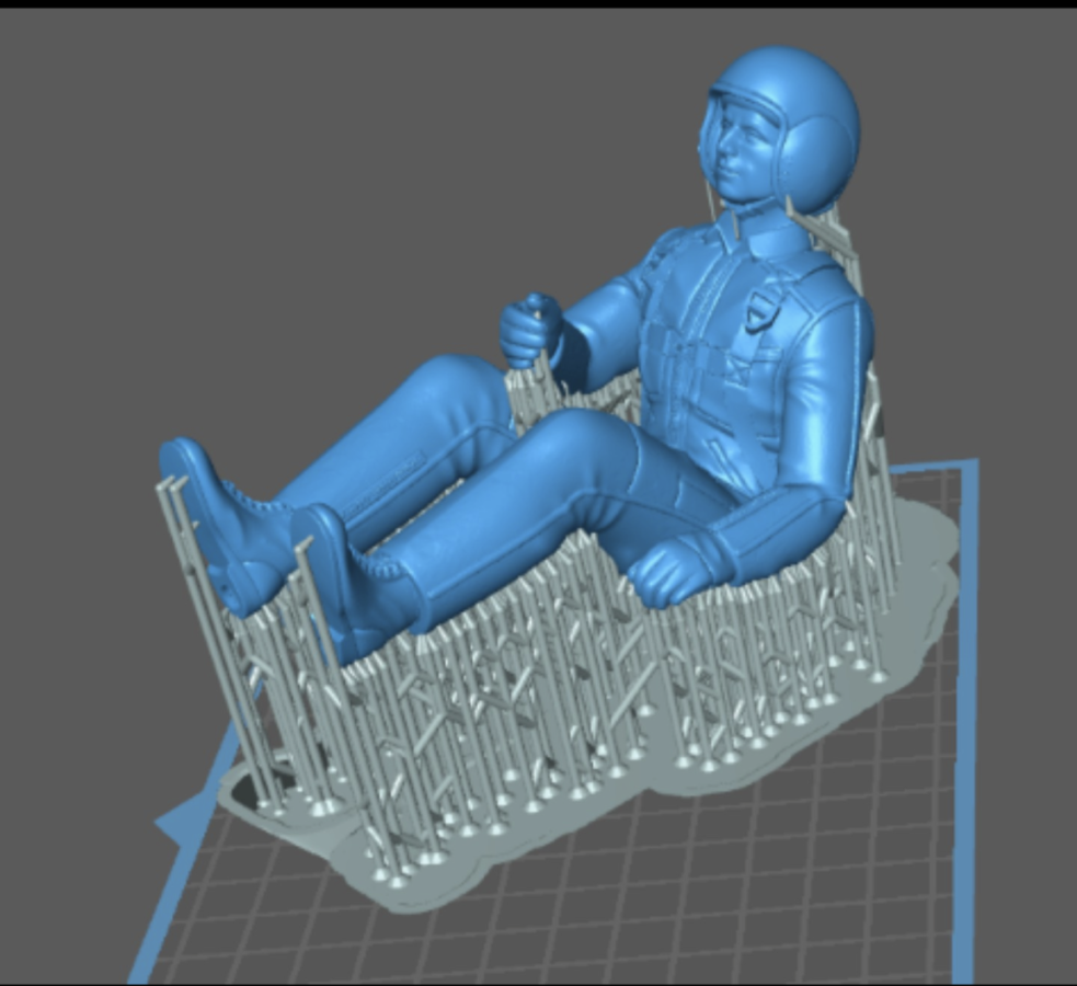

          I'm printing this guy right now. Not as fun as Bob and Doug or Bill and Ted.

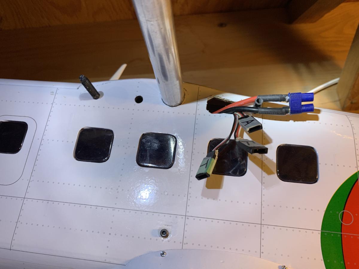

                  This first picture is of the fuselage where the wing attaches. You can see the 3 sets of JR plugs that go to the RX and the EC3 power connection that goes to the batteries. You can see the big plastic thumb screw poking through at the front of the wing mating surface. It's permanently glued in from the inside. In the middle is the stock wing rod. You can leave that loose so you can easily remove it but I glued mine in, so I never leave it at home. At the rear, you can see the stock wing location peg (CF rod), also glued in permanently. Far below the main metal wing rod, you can see the installed bolt where the wing strut gets attached. I keep it there so I don't lose it.
                  PS. The reason why I can't reach and turn the plastic wing screws is that I made a balsa tray to hold my AR636 RX. The tray makes it impossible for me to access the thumb screws. If you install your RX in any other location, the thumb screws won't be that much of an issue.

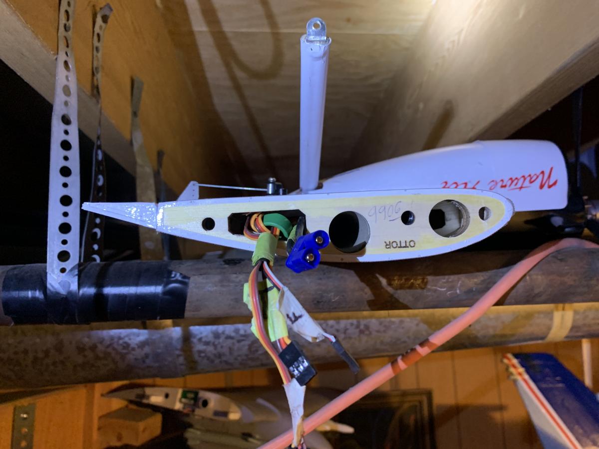

                  Next, you can see the wing side, with the matching JR plugs and EC3. You can see the wing strut that's installed into the engine nacelle.
                  Click image for larger version  Name:	IMG_3995.JPG Views:	0 Size:	100.6 KB ID:	332844

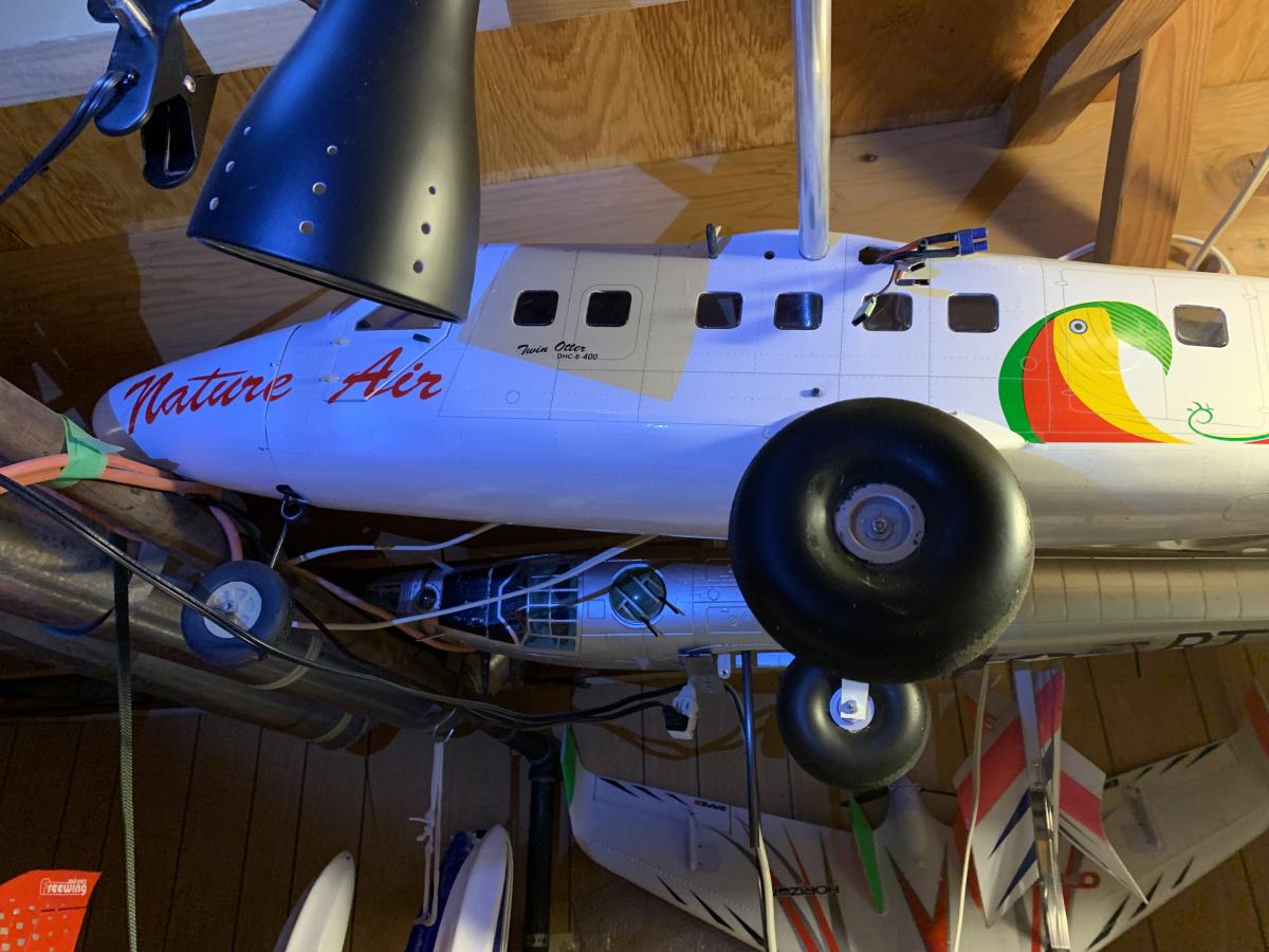

                  Lastly, just a picture of my "balloon" tires and nose tire.
                  Click image for larger version  Name:	IMG_3996.JPG Views:	0 Size:	124.4 KB ID:	332845
