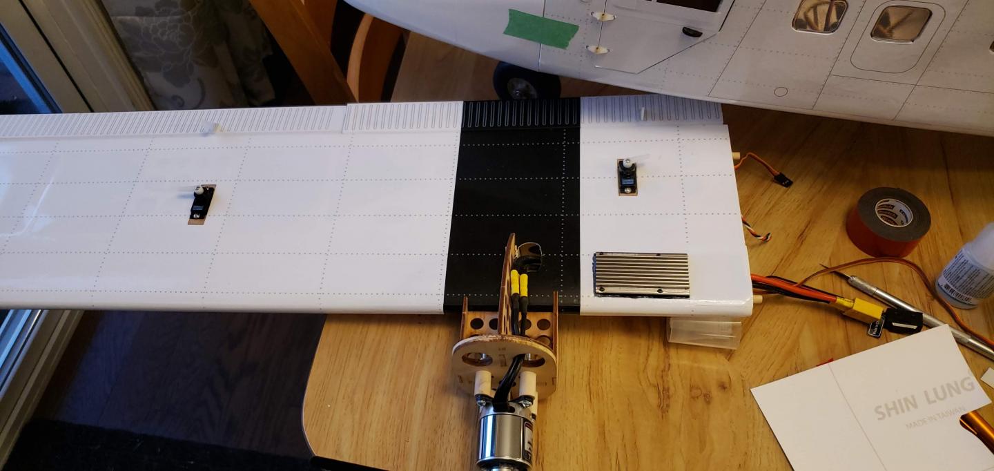

    The ESC mounting in the wings

    I also mounted the ESCs on the bottom of the wing, so that the surface of the ESC was flush with the wing surface, at the root by the fuse so the leads to the motor were short as possible, and they would recieve adequate cooling.

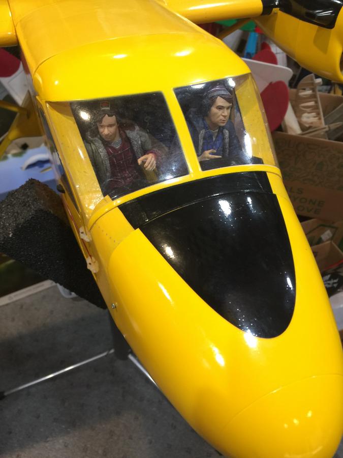

    OK - Who let these guys in my Otter Eh? Plane came out nose heavy. Must be the beer they stashed under the seat (and in the nose, and behind the instrument panel)
    Just kidding, haven't balanced it yet but I'm still going to check for empty's)
