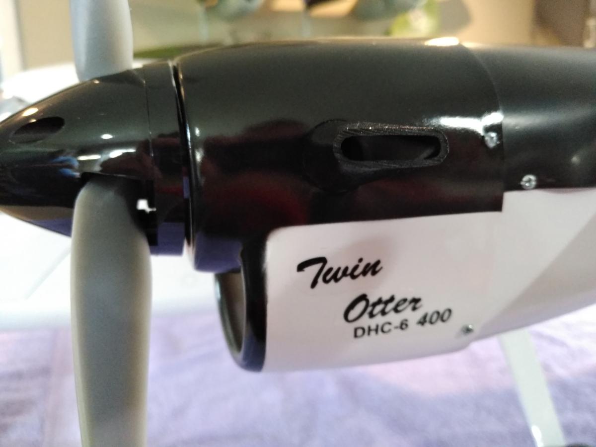

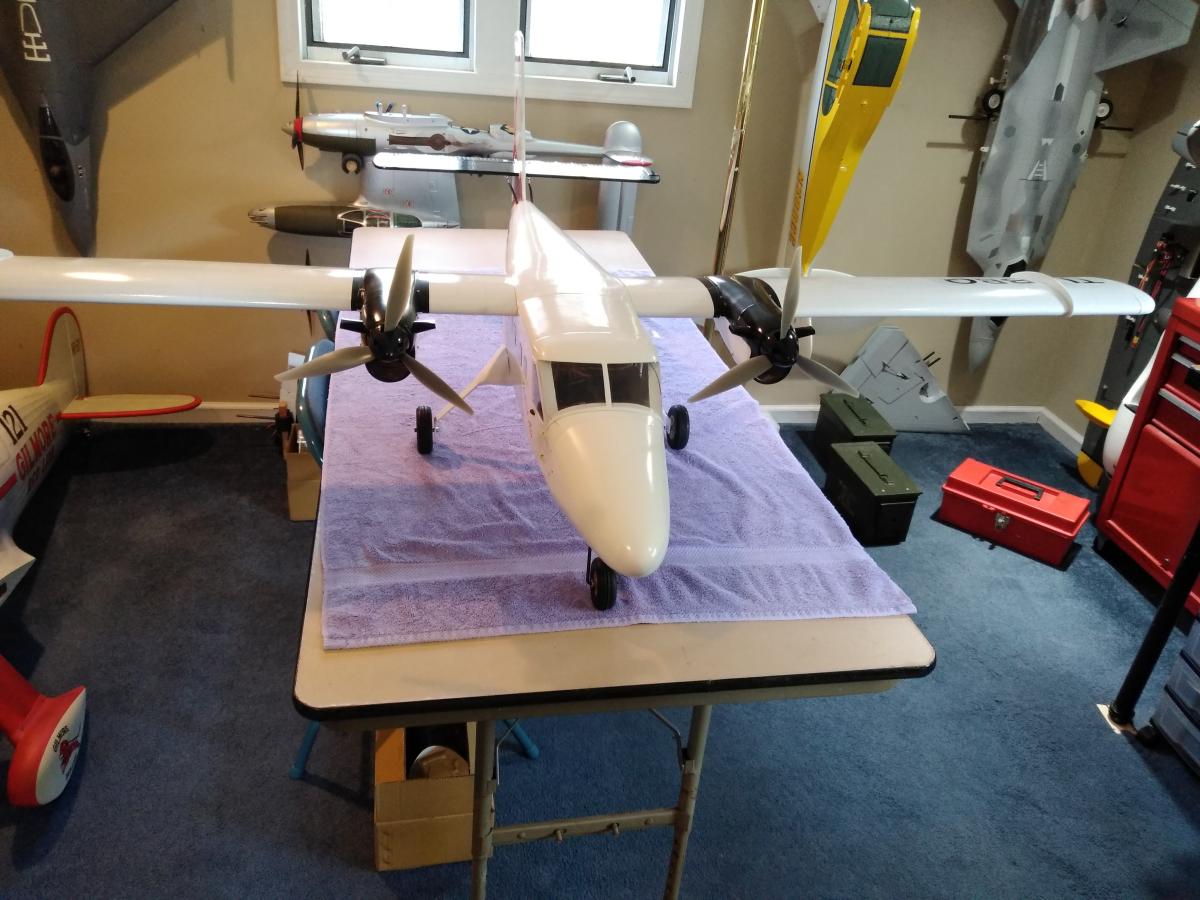

    Gilatrout My wife loves flying hers. She has the Nature Air version. Same plane, just different scheme. A rock solid flyer. Both of her motors are turning CCW with no tendency to pull left on take-off or during flight. It does like to land with flaps.
    She's running APC 11x7x3 props on 4S and pulls around 40a - 43a WOT static. Full throttle is rarely needed, except during big loops etc.
    She went with APC props because MAS prop hubs were too thick for the prop shaft/DuBro 2" three-blade spinner backplates. APCs are more efficient anyway. They look decent on this plane too.
