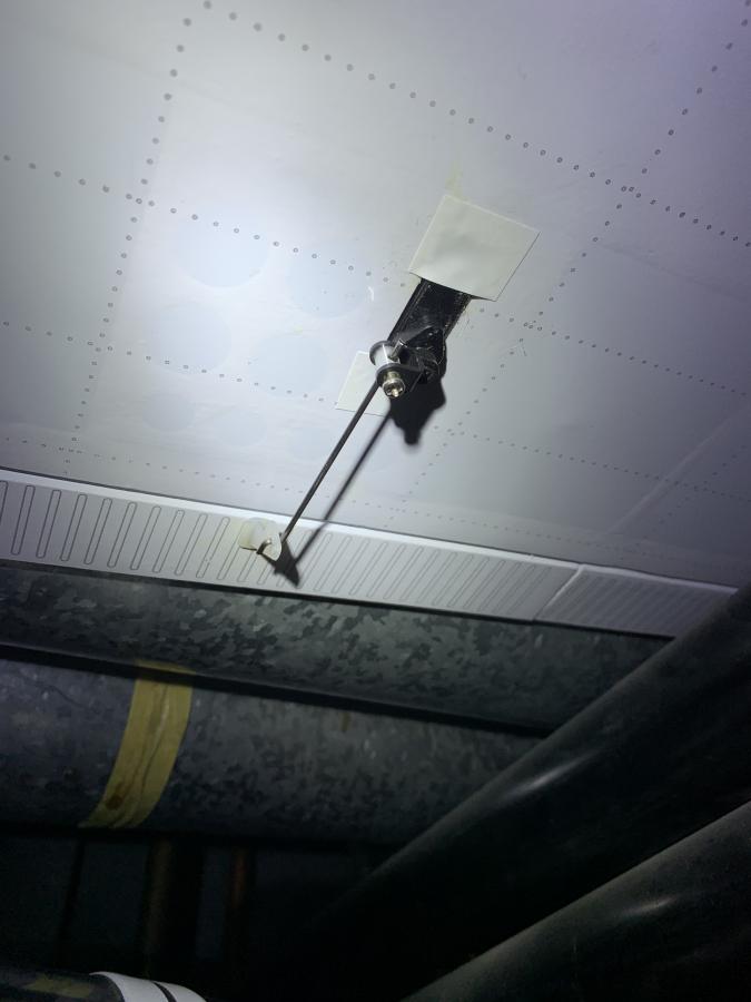

    Finally got back working on my Twin Otter. Did a first full check of all the avionics (OK - Servos). Discovered two issues with the right elevator servo (yes, I'm using dual servos).
    First, I had an intermittent in the Y cable so that had to be replaced.
    Second, I noticed the right servo wasn't centering so I thought the servo was going bad so I pulled it. then I tried to remove the push-rod. I was amazed with how much force I needed to pull it out. No wonder the servo wasn't centering. When I looked inside, right where the rear most window is, the push-rod tube makes approximately a 5 or 10 degree bend. The supplied 0.070" push-rod didn't like that bend and started binding in the sheath right around the rearmost window.
    All wasn't lost. I replaced the steel rods (two elevators so both push-rods needed to be the same) with my trusted yellow Sullivan push-rods. Yes, I know that is not the ideal fix and a lot of builders hate them but 1) it was the simplest fix and 2) I've been using these rods for years and as long as I had them secured properly, even with gas models, they were very reliable.
