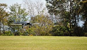

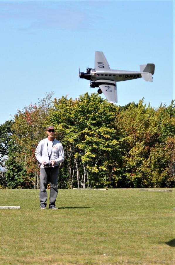

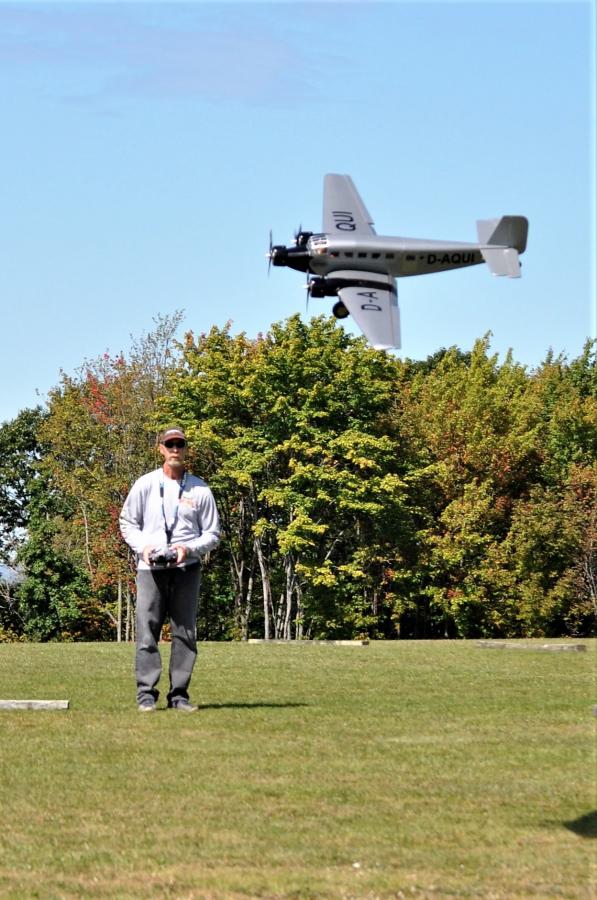

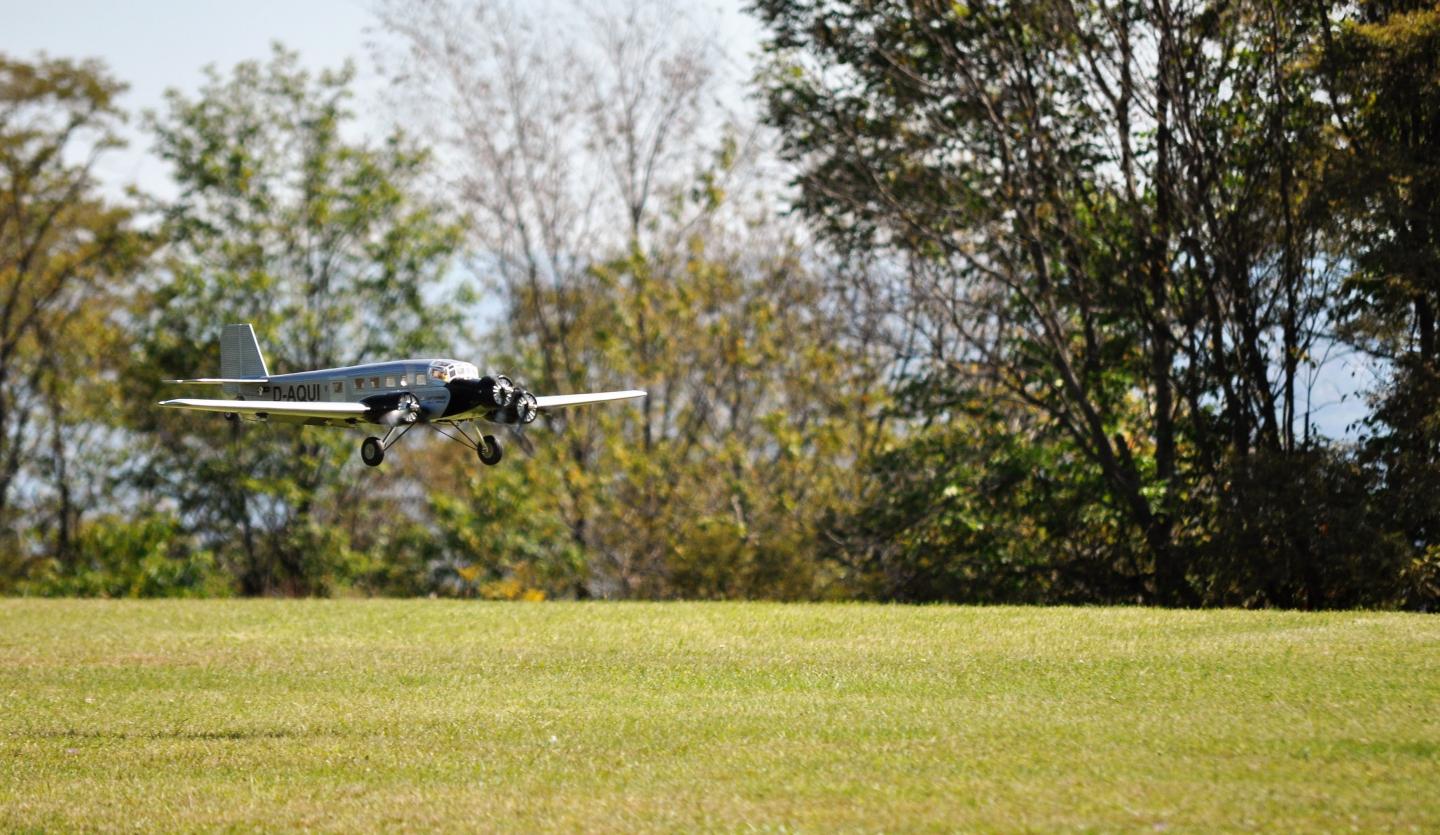

          Looking at the pics that Alpha posted I will say with very high confidence that this is the same VQ model that I owned prior to the Inferno :persevere:
          ps Chuck........you and TJ beat me to the Pfeil but not on this one. :face_with_hand_over
          Photo proof ................at my ex clubs field doing a full flaps show pass for the club photographer.

            Danggit! Scooped by Charlie! You liked the Ju-52 and would recommend it? For $210, I don't see how I could go wrong. I probably already have all of the electronics needed to outfit her in my hobby shop; So, the final cost will probably still only be $210!
            What spin direction(s) did you use for the props? Outboards reverse of the Center motor, or all three spinning the same direction?

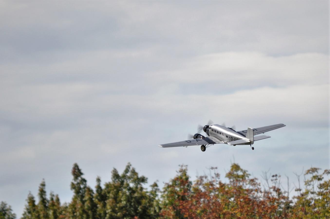

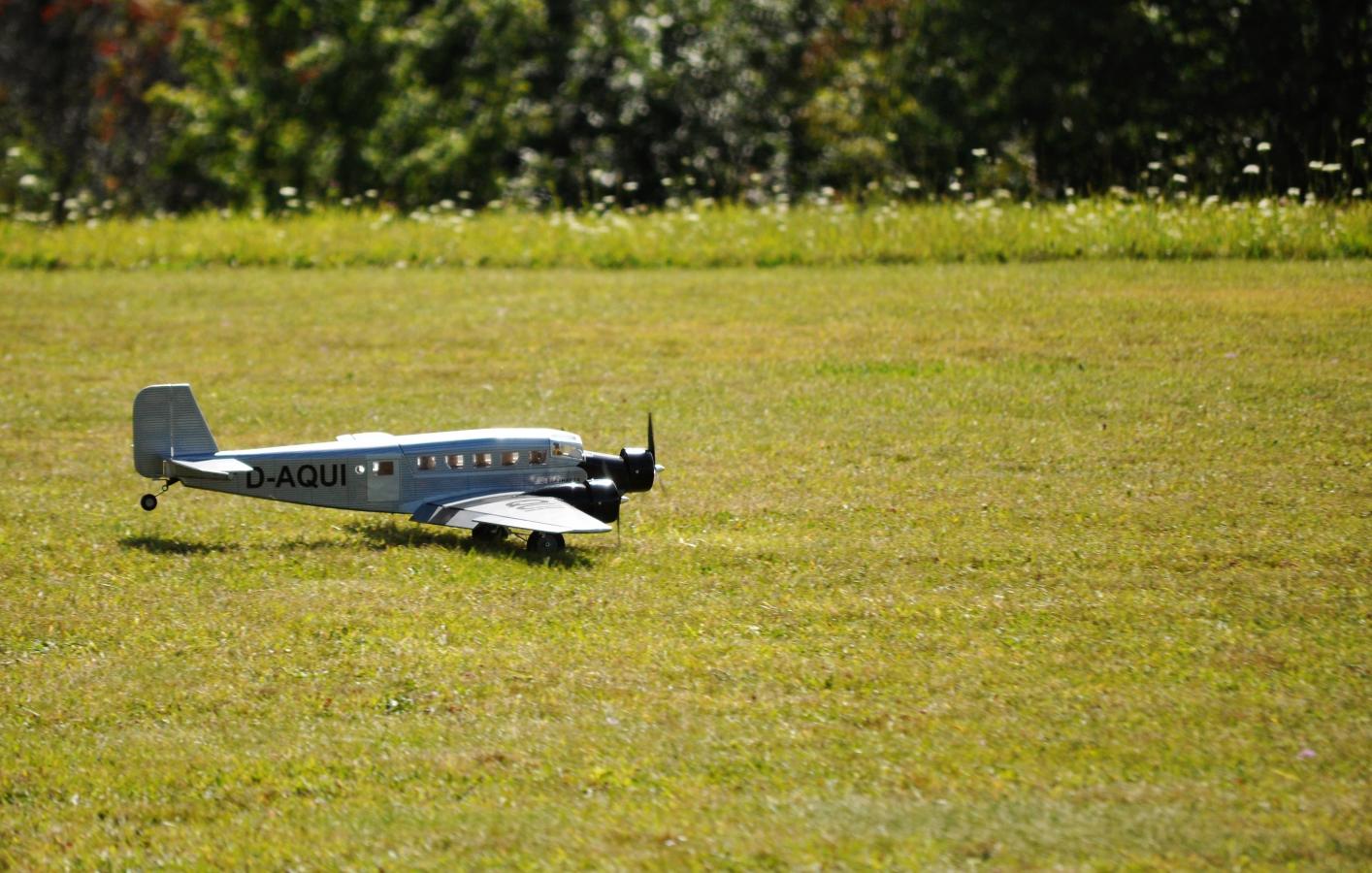

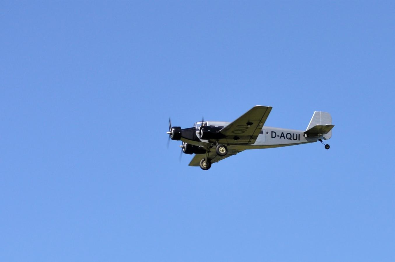

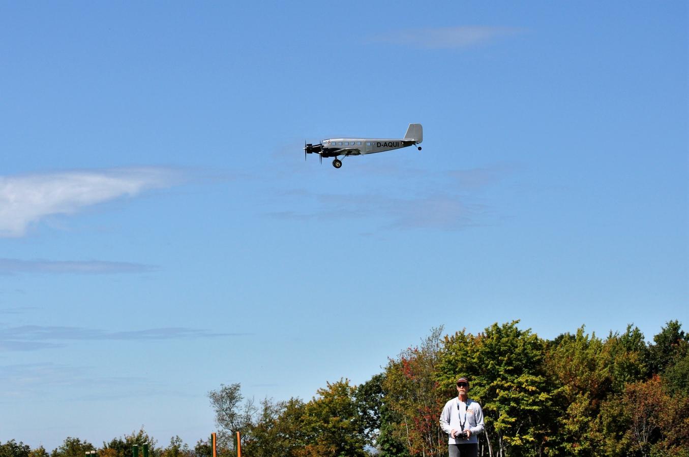

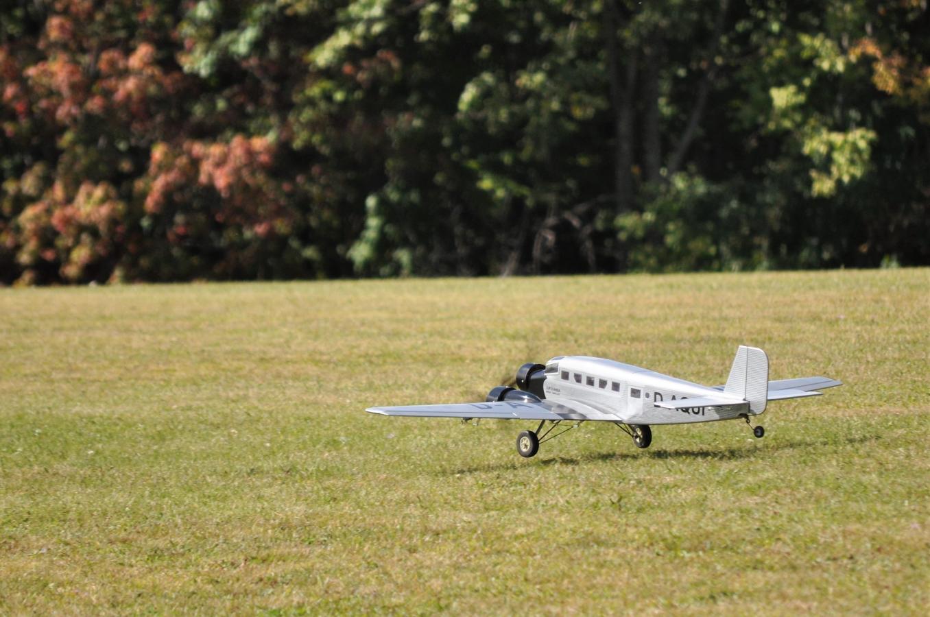

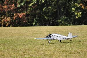

                WOW, digging through my receipts the dates indicate that I built this spring of 2016. Bought the airframe from Hobby People for $160 :smirk:
                Here's my set up thoughts to the best of my recollection based on review of my old archived instruction manual(yep, kept all those even from the birds lost)
                I ran it on 4S power using a single 4Ah brick with all three ESC's tied in parallel. All three ESC were placed in the belly of fuselage where the wings connect and ran motor lead extensions from them. All three props were standard rotation MAS 9x7x3. There was no need for counter rotation of the outboard motors because the complete cowl/mount for the motors had a several degree factory offset to the outboard sides. At that time I was into FMS motors heavily but they didn't have a motor that I could use so I went with my first time use of Hobby King motors. Used the NTM Prop Drive 28-36 1000kV which is now discontinued but was replaced by the V2 PROPDRIVE 2836 1000kV with same specs. They also require the NTM Prop Drive 28 Series Accessory Pack and the nut bullet looks somewhat scale.
                I looked at the now recommended FlightLine motor but unfortunately Motion STILL is not providing motor specs so can't really give a true assessment whether they can haul the 3 blade load.
                I used 16g servos for all control surfaces. The main gear is a spring loaded oleo that I shorten about 1/2 inch because it was just to tall in stance. Still had plenty of prop clearance afterwards.
                The control surfaces were set to my standard warbird configuration of 15 degrees max deflection for ELE and AIL. The flaps were 15 degree takeoff and 30 degree landing. The rudder was on a low/high rate of 15/30 degrees. The cockpit area was spacious and allowed the brick to be placed without issue to achieve the CG of 90mm which was about right in the middle of the range called out in manual @ 88-94mm.
                Flight characteristics require that a pilot should be comfortable with rudder coordinated turns and you don't want to be slouching it on final base turn for landing because of those wedge shaped wings.

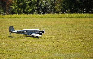

                Once on final go with full flaps and she settles in rather nicely. Here's some shots of my takeoffs and landings
                (click on each pic for a nice large view)
                Click image for larger version  Name:	DSC_9037.jpg Views:	0 Size:	150.0 KB ID:	253817Click image for larger version  Name:	DSC_9041.jpg Views:	0 Size:	69.3 KB ID:	253818
                Click image for larger version  Name:	DSC_9058.jpg Views:	0 Size:	39.0 KB ID:	253819Click image for larger version  Name:	DSC_9094.jpg Views:	0 Size:	97.9 KB ID:	253820
                Perfect full flaps 2 point touchdown
                Click image for larger version  Name:	DSC_9124.jpg Views:	0 Size:	202.1 KB ID:	253821Click image for larger version  Name:	DSC_9129.jpg Views:	0 Size:	183.0 KB ID:	253822

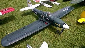

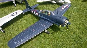

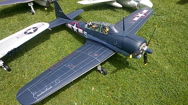

                                Originally posted by Oxotnik
                                Thanks, Charlie. As I'd said in an earlier post, I only have one reference point for VQ warbirds, and that was their 59" FW-190A. I ended up really disliking it because the gear stance was horribly wrong and the cockpit/canopy had some really bad scale issues, too. I'm not usually an overly critical scale person, but I kinda am on the FW-190s. I'd also thought seriously about the VQ MC.205, but it looked to have similar scale issues; so, I've decided to pass on it. I've heard really good things about some other VQ warbirds, especially the Dauntless. I'm really looking forward to getting a Ju-52. I wish that Motion was bringing the splinter camo version, but I'll take the Lufthansa civvie version. Trimotors are cool! :-)

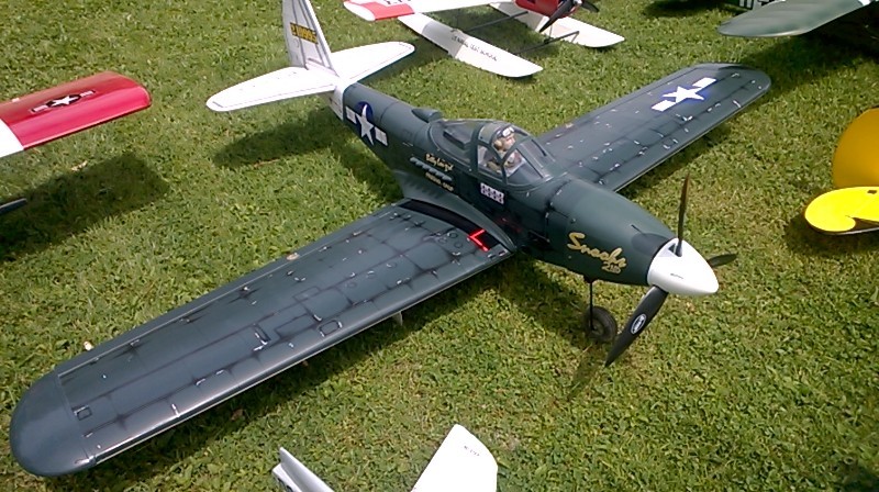

                                I owned both the VQ Dauntless(1540mm) and the P-39(1580mm) also.
                                My only critiques of concern for those were the dihedral was inaccurately lacking and the wing joining plywood spar splicer was brittle crap.
                                The Air Cobra now comes with retracts and flaps whereas my version was fixed gear and no flaps.
                                I think most likely the new rendition of the Cobra is on my check list if Motion brings it in.
                                Click image for larger version  Name:	WP_20150524_007.jpg Views:	0 Size:	160.5 KB ID:	254195Click image for larger version  Name:	WP_20150524_010.jpg Views:	0 Size:	145.8 KB ID:	254196
