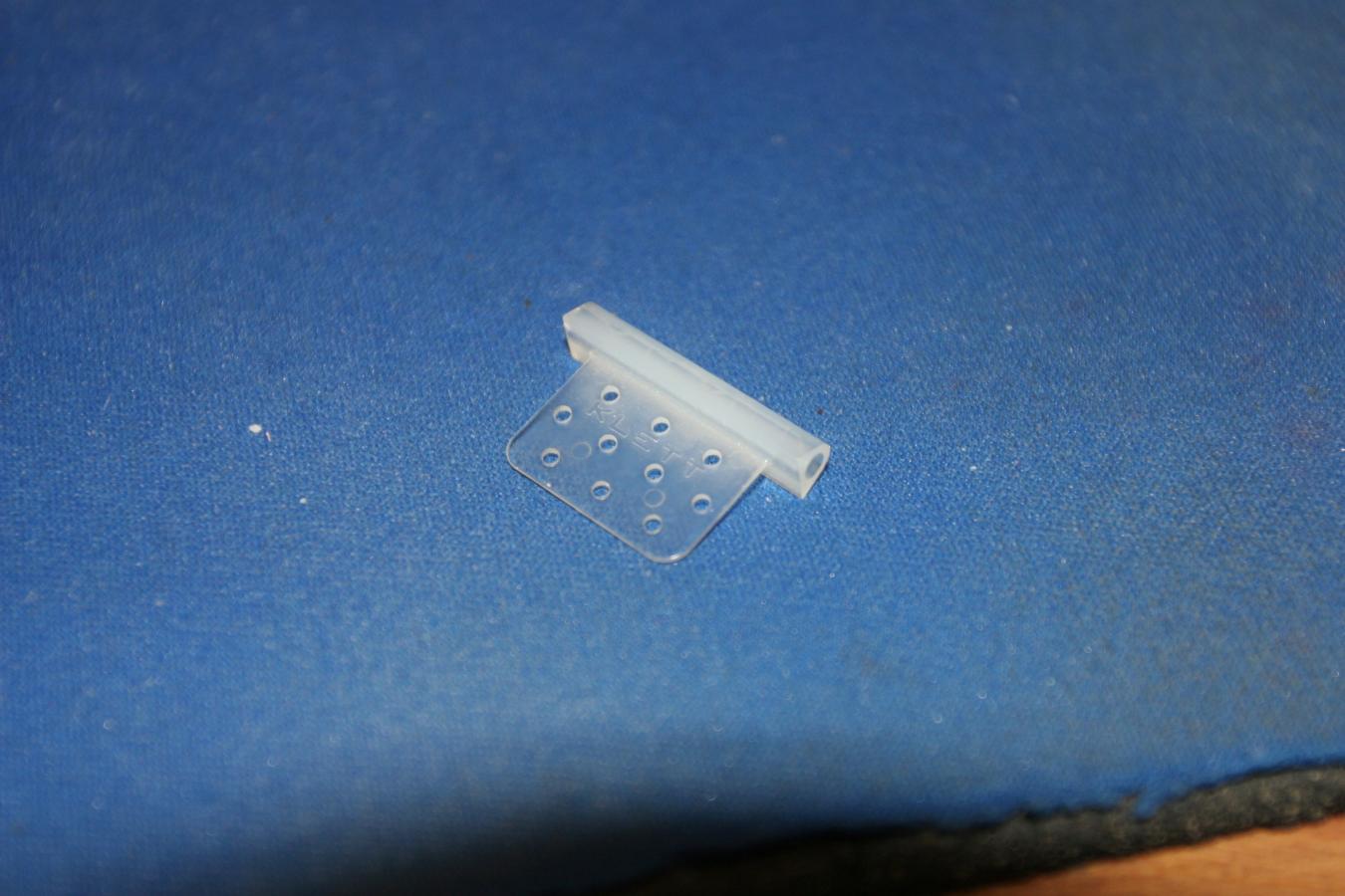

                                          #120
                                          Originally posted by airotroy
                                          I bought the Freewing 9G MD31093-300 servos. Hoping they work ok in the air. They all have centered ok on the table. I'm waiting some thin CA to finish the tail section. The rear wheel assembly came with a "horn" that appears to be too thick to insert into the rudder so I'll shave it down so its thinner and will fit into a slit in the rudder. Also I'v had a heck of a time with the gear assembly. The front and rear wire support channels werent cut deep of wide enough to accept the wires so I had to cut and dig them out. After doing that and using some of the "flat metal" hold down straps they sent me in place of missing nylons, I cant even get close to getting the Alum tube strut to fit in the front wire support after attaching the other end to the linkage device thats on the wing. Any advice would be appreciated. Thinking about painting the rudder and cowls yellow so I can see this thing easier in the air. Like others had to build a servo support for the rudder and elevator servos.
                                          See if you can find these for the rudder attachment. They are called aileron horn hinges. I took one and cut it in half. Only requires an X-acto knife slit to install
