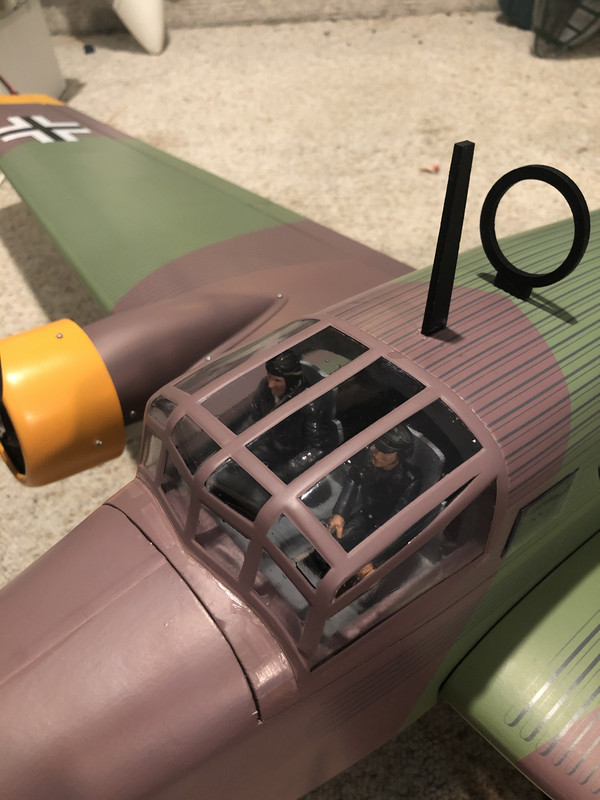

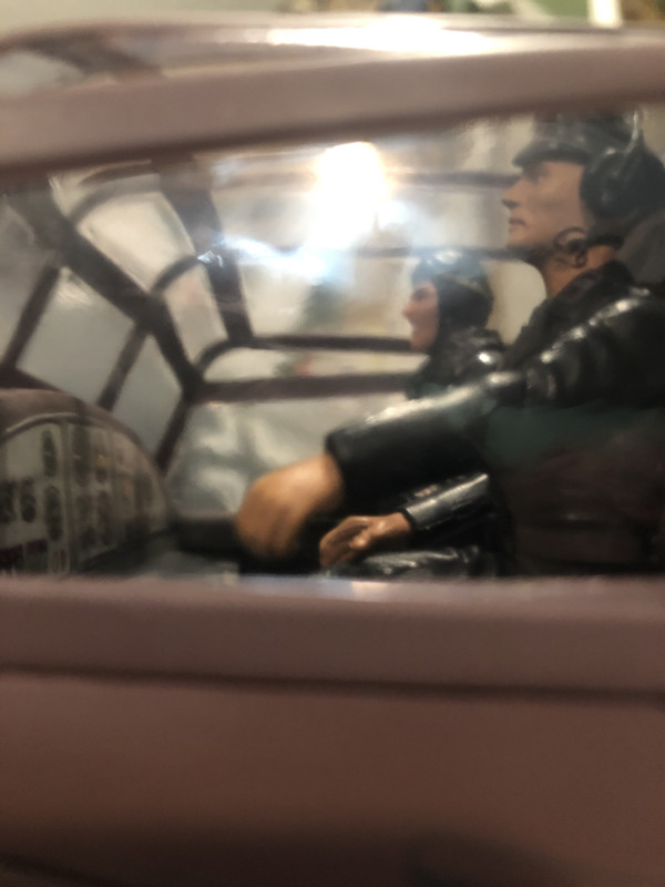

                    The struts to my Ju arrived today, and they’ve been installed. My Tante Ju is now fully operational. The 1/18 Ultimate Soldier pilots have turned out well. I out a tank commander in the left seat (I liked the service cap and earphones) and I put the Stuka tail gunner on n the right seat (painted his white coat Luftwaffe blue-grey).

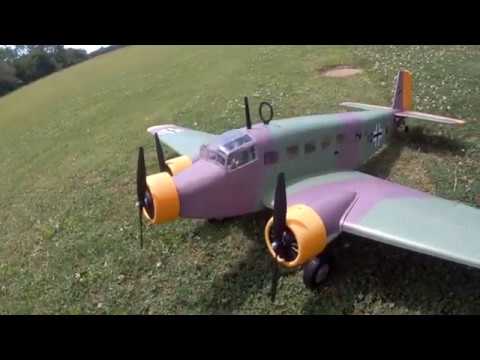

                                    Maidened my Ju-52 today. It flew very nicely. It was a bit squirrely on the ground; it took me several attempts to get her running straight enough to take off. She flew really well. I love the sound of the 3 motors running.
                                    Warbirder
                                      #58
                                      Oxotnik Congrats on the maiden Chuck. It boogies right along doesn't it. What do you think caused the squirliness onthe ground? Maybe torque x3? Not lacking on power, that's for sure.
                                          Tony, I don't know. As you know, the tailwheel is mechanically linked to the rudder, and, visually, the tailwheel is well aligned with the rudder. I've got pretty good take-off technique for tail-draggers, where I ease into the throttle, get her running straight, get the tail up, then pour on the power. The Ju was weird. It felt like it was yawing one way with the tailwheel planted, but then yawed the other way when the tail wheel came up. The Mains are straight. Maybe the suspension in one of the Main Struts is compressing during the takeoff run, inducing a yaw. I have a full throw on my rudder (I always like a lot of rudder) and have expo set at 30%. Maybe, I need to run the rudder expo up another 20%, to see if that damps out the overcorrection. I'm still puzzled. On the second flight yesterday, I had to abort the first takeoff run, but successfully got her in the air on second run. I'm still pretty baffled about what's going on during the takeoff run. In the air, though, she's flies like a dream. 4S with these 2836-1000kv motors has plenty of power. After a 5 minute flight, I was still around 50% battery, and I'd mostly kept the throttle around 75% for the flight. Charlie's recommendation for these motors was really good.
