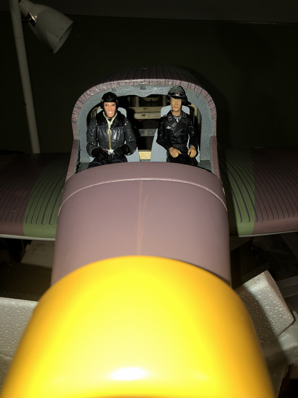

          Before I reattached the canopy, I snapped a photo of Fritz und Heinz. Fritz, the piloten, originally commanded a Tiger II before joining the Luftwaffe. He was allowed to continue to wear his Tank Commander uniform. Copiloten Heinz originally served in a Ju-87, before being reassigned to the right seat of the Ju-52. He doesn’t look too happy about the reassignment.

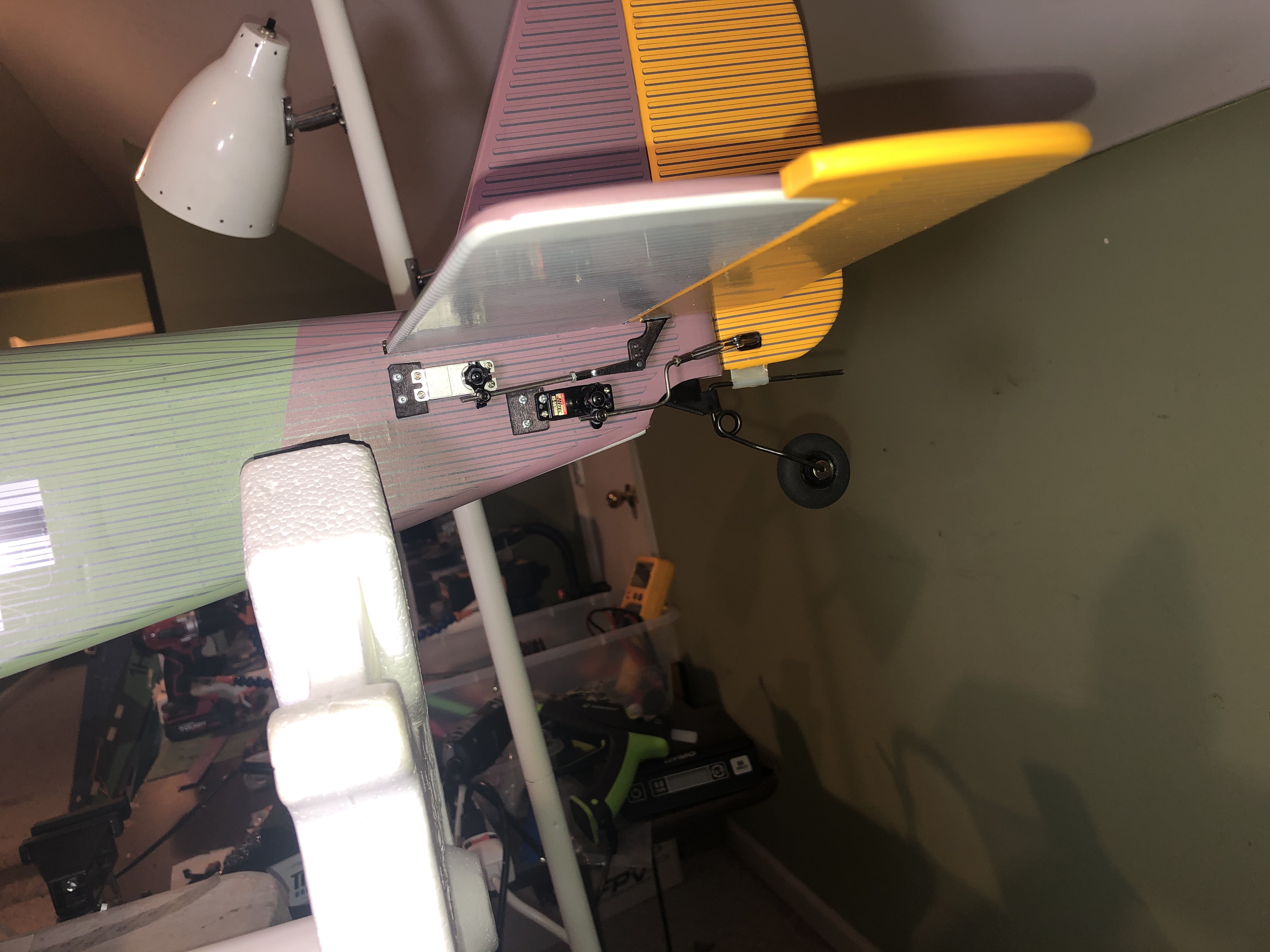

            I've finally got my replacement Splinter Camo Ju-52 assembled and balanced. I'd mentioned it on the last page, and everyone flying an ARF should know it, but be sure to balance you ready-to-fly Ju-52 before flight. I ended up adding another micro servo under the horizon stab, so that both halves of the elevator are controlled by a dedicated servo (I hated the U-bend piano wire for attaching the two elevator halves, on my first Ju); so, another 12g of tail weight. I ended up need 4.5oz of lead on the Center Firewall to pull the CG up to the center of the recommended CG band. Anyway, just a public service announcement... :-)
            Oh, just thought of one other thing, relative to adding a second elevator servo... The rudder and one of the elevator servos will be on the same side and the control arms and push rods get really close together. I had to make a big S Bend in the Rudder Pushrod, to avoid the elevator pushrodd and control horn on that same side. Initially, I was a bit worried that the S Bend may flex around those bends, but the push rod is plenty thick enough that the rudder forces aren't going to deform that pushrod at those bends.

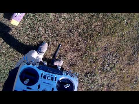

              Maidened my replacement Tante Ju today, plus 3 or 4 flights. This was the last Ju-52 flight today. I figured out why I'd been having so much trouble with the takeoff runs. I'd been letting the tail rise too early. I kept the tail planted while she gained a little more speed, and when I did allow her tail to slowly rise, she was rock steady!!! Now, I'll have to stop calling her my Bad JuJu-52. :-)
