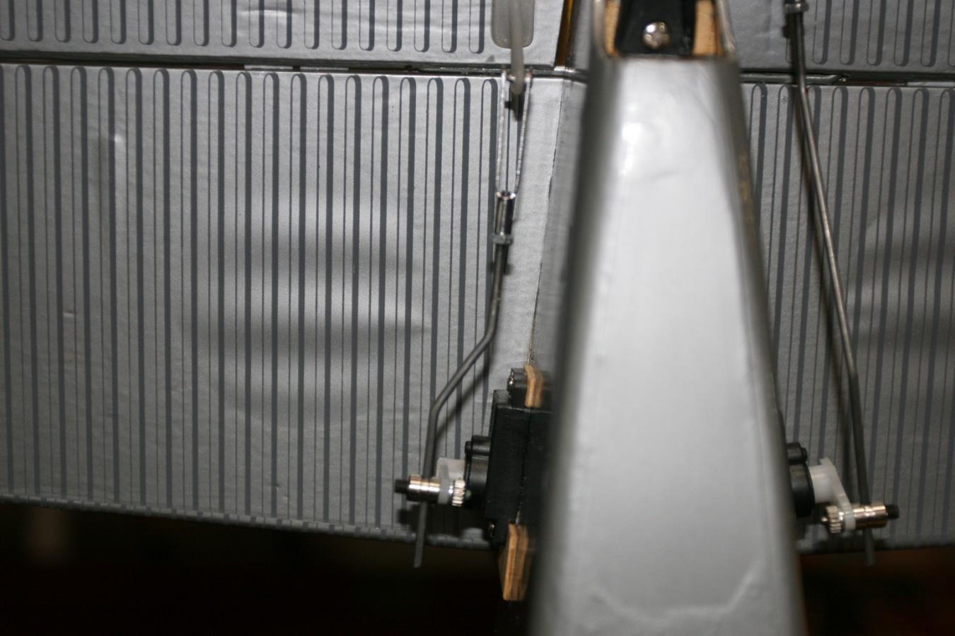

    I'd managed to lose one of the nylon straps that hold the strut supports in place. I shaped a chunk of balsa as a replacement. I like the tie-wrap solution better. I'll probably swap out my ugly balsa block for a less-conspicuous piece of tie-wrap.
    Edit (7 hours later): Found the missing nylon strut strap. Merry Christmas to me.

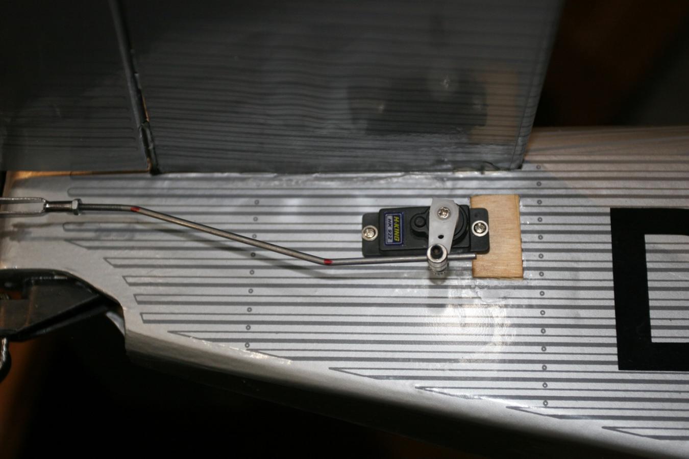

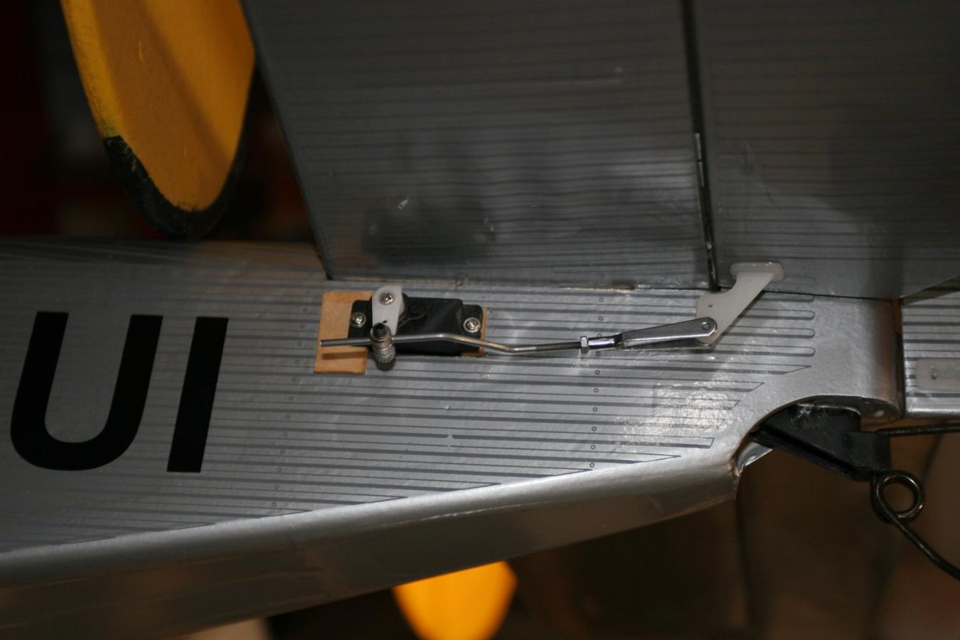

                  My servos are installed in the forward most openings and as it turns out, that is the better place (and it was dumb luck that I didn't use the rearmost openings). Even though the fuselage is wider there, the small servos still bottomed out against each other (if you see the picture of the elevator servo, you'll see a second shim in the other side of the servo). Thanks to Oxotnik , I saw the fix he used for the excessively wide servo opening (just have to paint mine silver).
                  As for the flap servo, there are a few options:
                  The easiest way - buy a servo reverser or buy a servo already modified from Servo City (the reversers I've seen run from around $10 to $20; Servo City has a standard fee of $10 to have the reverse option done in the actual servo)
                  The cheaper technical way - "IF" you are VERY comfortable soldering and very comfortable doing it with small components, the servo mod is really easy and involves swapping just two pairs of wires; motor and potentiometer. If you are not comfortable doing it, either find a buddy who is (a 6-pack is a recommended payment 😊 ) or do the above. I am pretty comfortable doing that kind of close work so I reversed my own servo.
                  The least frustrating method - install the servo with the pushrod and mark on the flap where you want the horn. Now you have a decision to make. The area the horn is installed appears to be a plywood material. If you elect to use the supplied horns, you will need to cut a rectangular slot. It will be time consuming to do as you don't want an oversize slot. Two drilled holes and an X-Acto keyhole saw should do it. An easier way might to just use the classic 3-screw horn.

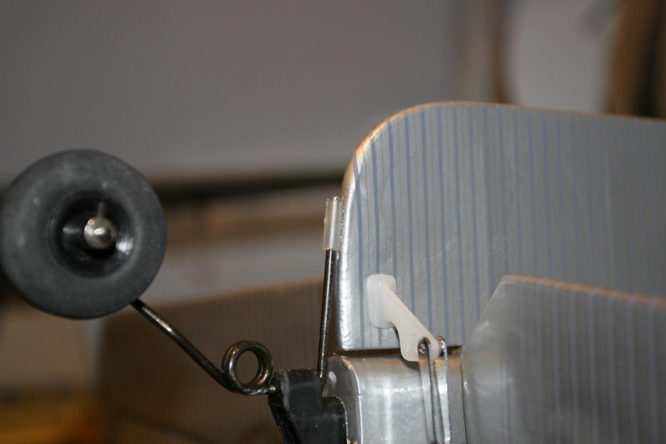

                    One more item that is worthy mentioning and that is the attachment of the tailwheel rod to the rudder. The parts they supplied I was not comfortable using as the tab was, in my opinion, way too wide. I had an old strip aileron bearing on my box of misc parts which I cut in half and trilled the overhang (see picture). The tab is only about 0.025" thick which makes it an ideal fit (simple X-Axto slit in the rudder material, a little CA to hold it in place - Done).
