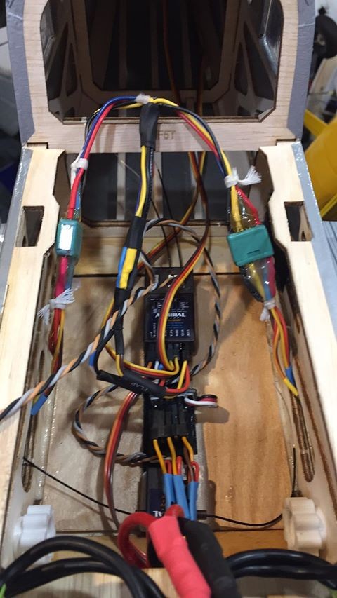

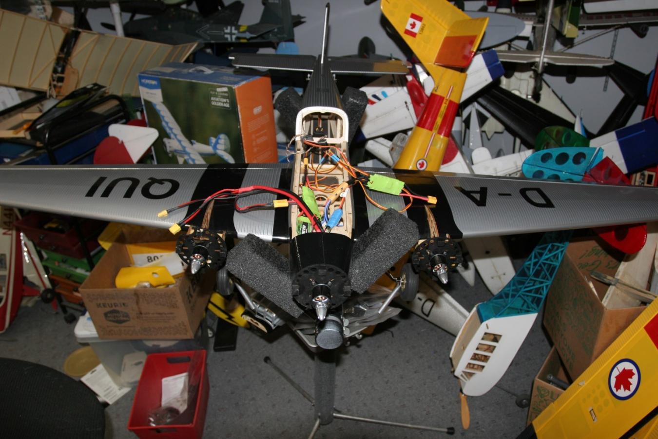

    I'd say i'm about 80% there. Got the receivers yesterday and finally got all three motors talking to each other. Bit of a challenge with these ZDT Mantis ESCs. Did exactly what the manual said to do for calibrating the throttle. No action at all. Had to do a full factory reset on each one. Once I did that, each one came to life and when I ran all three, perfect synchronization (meaning they all started and stopped at the same time). Not many new pictures; just a few of the power set-up. Using triple connectors for motor disconnects and fabricated the triple power cable complete with a Castle 10A UBEC.
    I see you had the same challenge I had with the center motor. Thank the maker for magnets and needle nose pliers (and self locking nuts). Now that I have the motors installed, it's time to tackle the cowls. Have you cut out the spaces in the faux pax cylinder inserts for motor cooling? If not, the trick is use a new X Acto blade for each one. It's time consuming but since summer is here, I don't want to risk overheating the motor. I'm still wrestling with how I'm going to keep the three ESC's cool in the enclosed fuselage. Would like to have the wing ESCs in the nacelles but there just wasn't enough room.

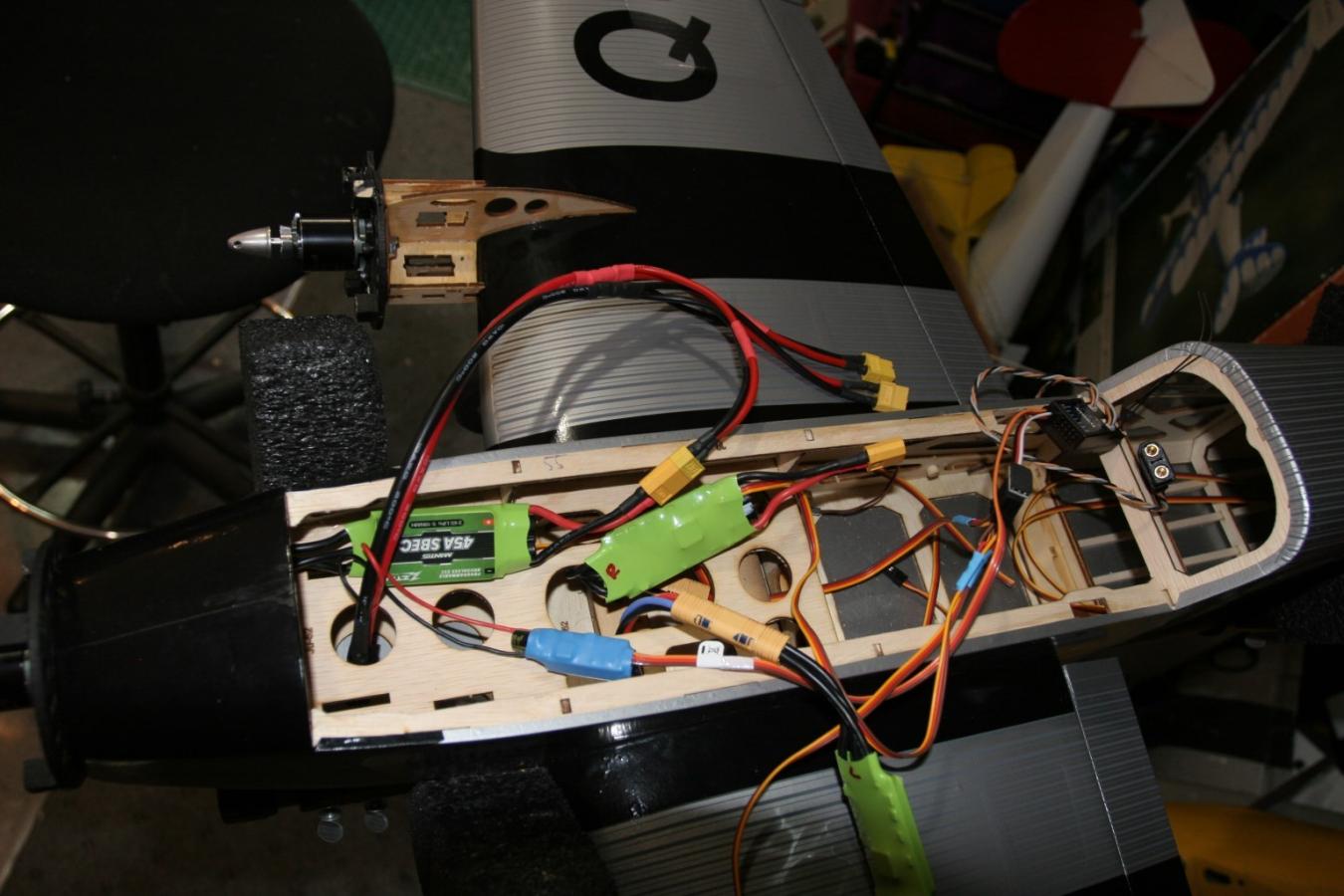

      Just now getting the wing servos set and all the little pieces put together for linkage. Like you trying to figure out how to keep the esc's cool. Will prob cut out openings in the dummy engine insert to keep motors cool. Of course I'm missing some of those 3mm set screws for the gear material. Not looking forward to the soldering job for the 3 ESC's to 1 battery plug. By now you should have yours pretty much done and maybe maidened ?

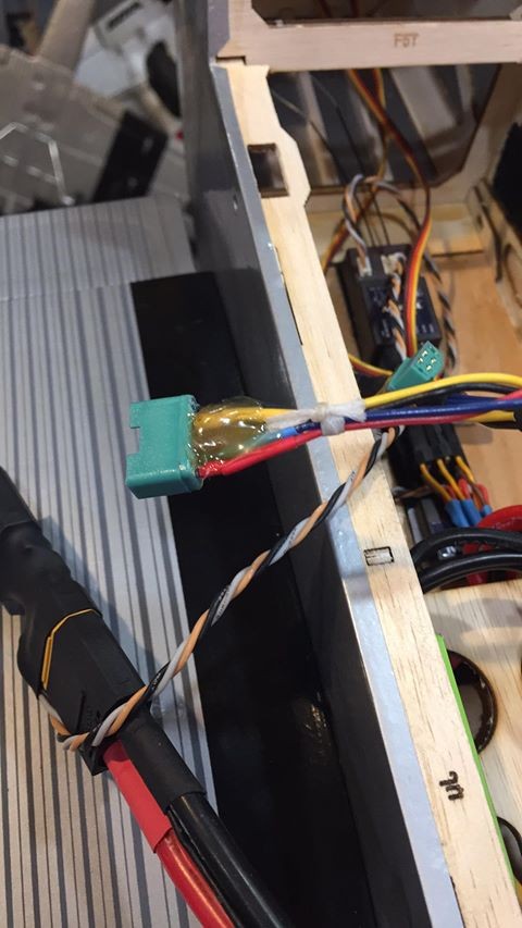

        My consultant job has been keeping me pretty busy and we are renovating our air museum in Camarillo (I'm a volunteer there 2 days a week). Over the last several weeks, very little got done on the JU52, not to mention the Twin Otter that I bought at the sane time (still waiting for aileron servos for that one). So much for my issues. Here's a simple solution for wiring the ESCs.
        Get a piece of brass tubing, approx 1/2" to 5/8" long. The diameter should be just big enough to fit the stripped ends of all three ESC red leads. File a notch in the center of the tube, approx 1/3 to 1/2 way thru the diameter. This notch is where you will feed solder. Thoroughly clean the ID. Slip the three red ESC leads in one end and your single red lead that will go to the battery in the other. If you don't have a jig to hold everything, make one as there is a lot of wire and you will need a fairly high power soldering iron (I used my Weller soldering gun - 140 Watts) and things will get very warm. Heat the center and feed the solder in the notch until you see it flow at each end. Cover with heat shrink sleeving. Repeat for the black lead.
        I've used this method many times and it does make a clean junction.

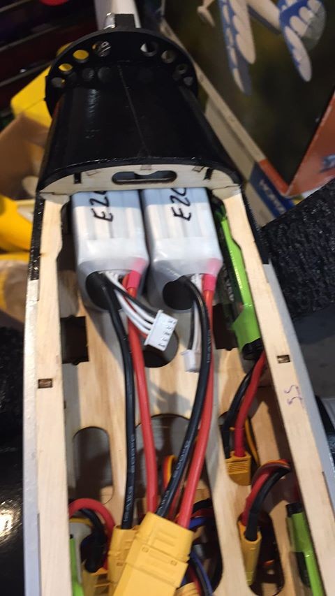

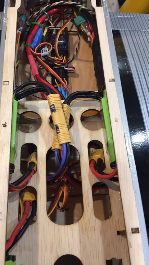

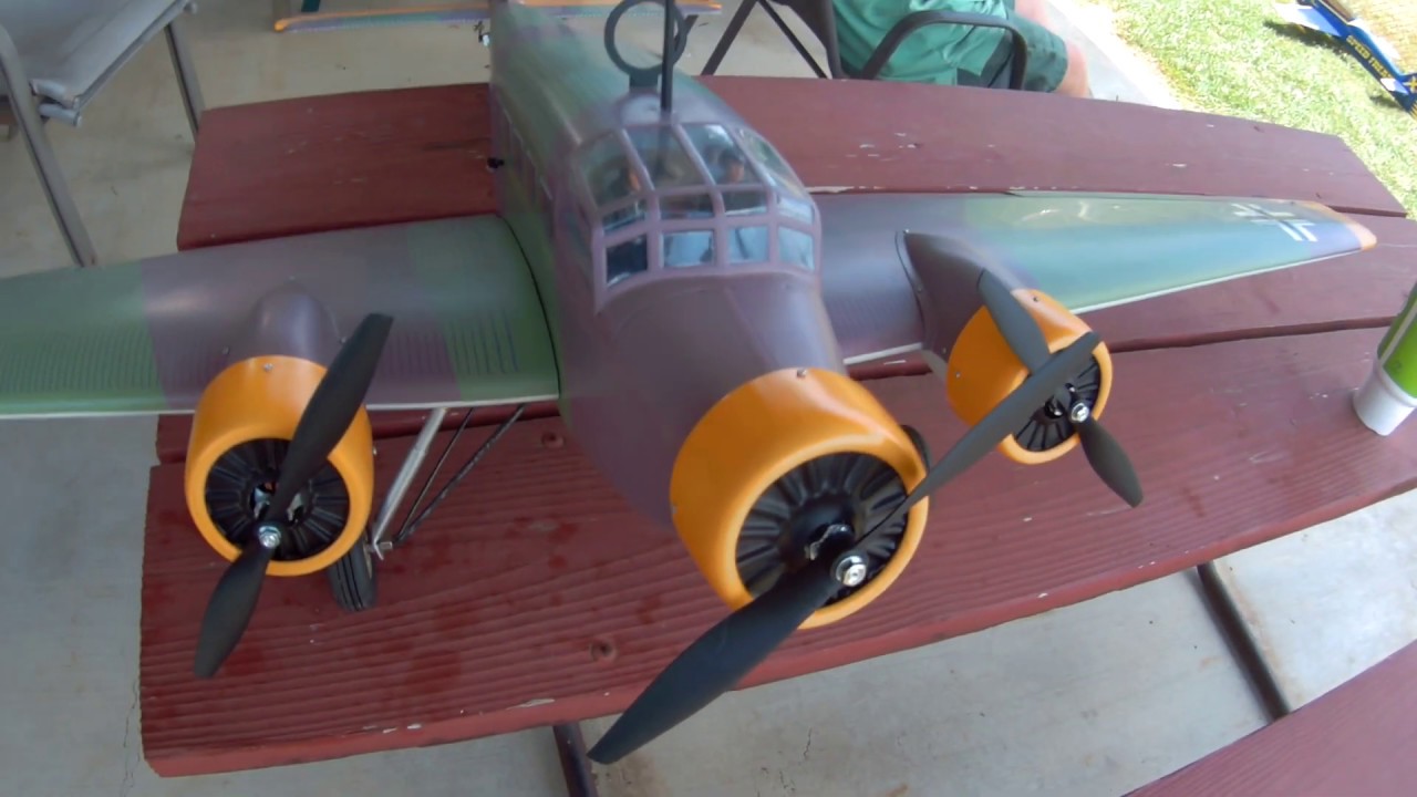

          A little more progress on the JU-52. Proud to say, all the wiring is finally complete (and everything actually works; smoke test proved it), Bought a Admiral Rx with telemetry (my first Rx with telemetry). Because I'm using XT-90 connectors on dual 4-cell batteries (dual in parallel to get double the mAh), I had to replace the XT-60 connectors on the voltage unit with XT-90's. Bit of a pain but successful as it avoids having to use adapters. Also a first is using 6-pin MPX connectors to make field assembly of the wings easier and less of a chance of screwing up what effector (servo) goes to what channel. The last things to do now are to install the wing fairings for the cowls and the engine cowls. After that, it's "weight and balance certification." Still need to test the motor/ESC for the best prop. Definitely will be using a 3 blade. The question is for the motors I have. 9-6 or 10-5. It all depends on how many amps the motor sucks up.
          One last thing. I replaced those horrible 45mm plastic wing attachment screws with steel 30mm hex bolts. I 3-D printed some short serrated knobs for them and they are a lot easier to screw in with the limited hand space available.
