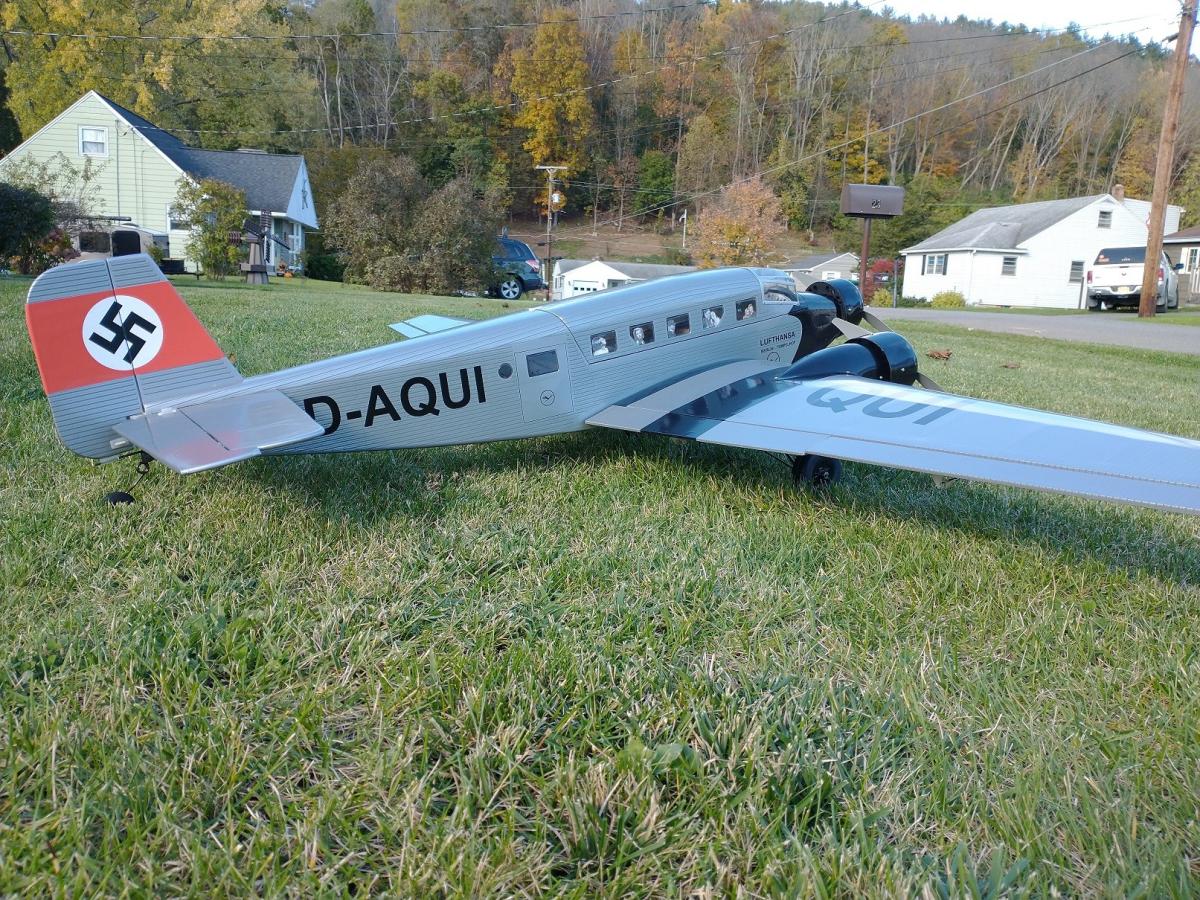

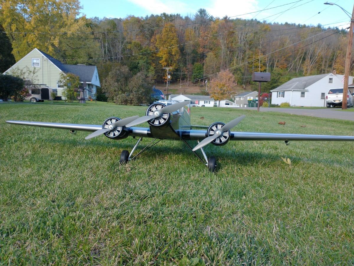

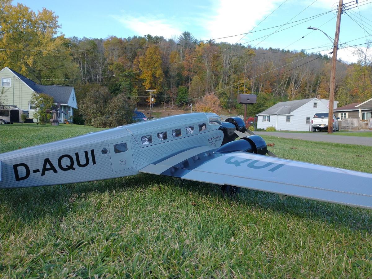

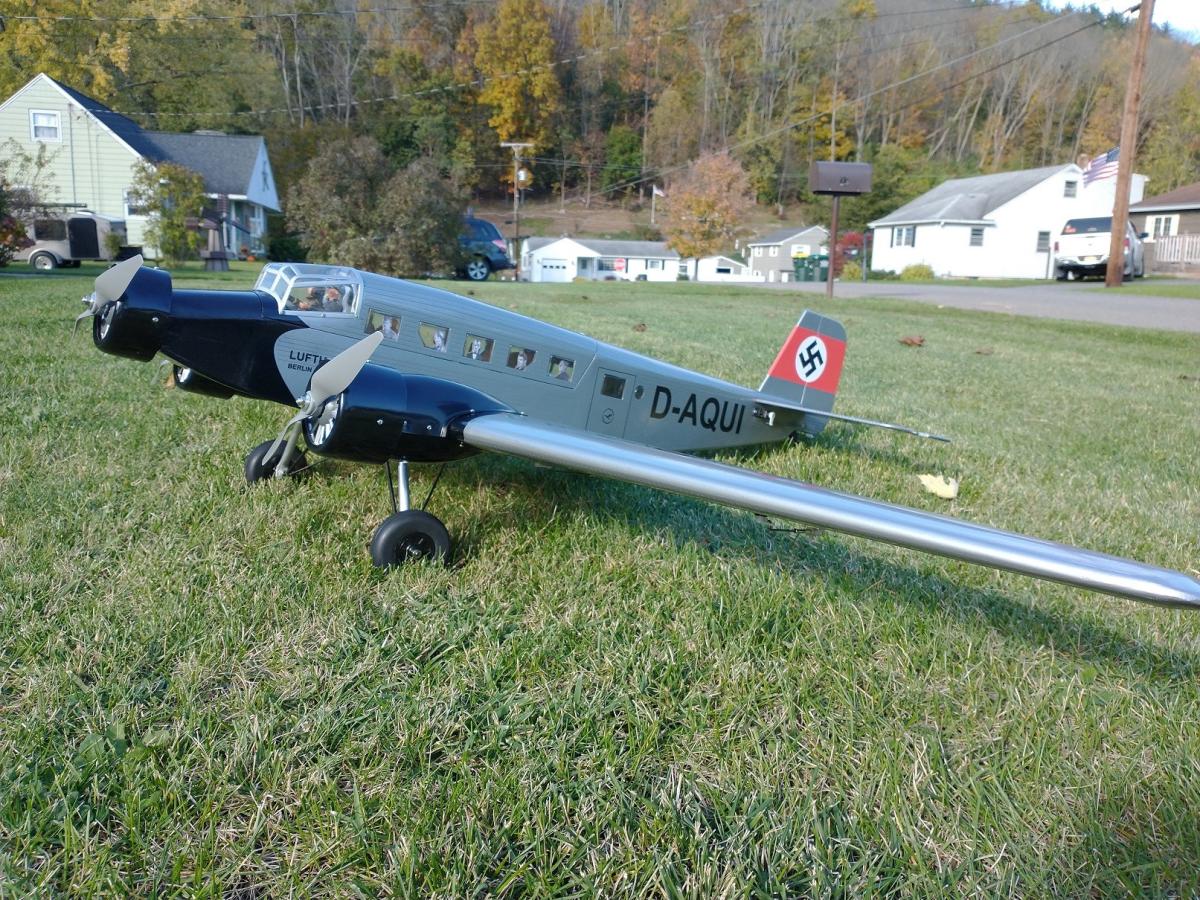

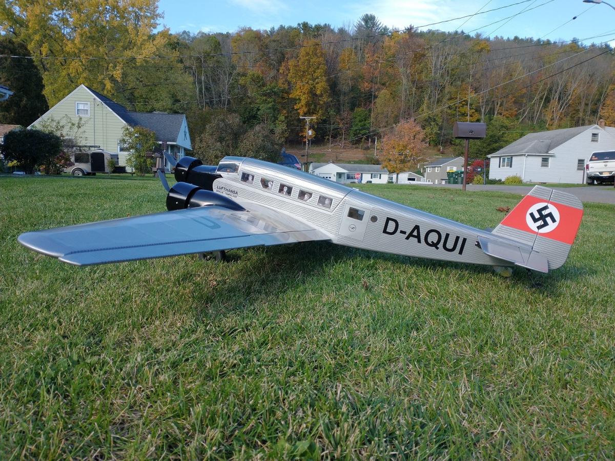

        • My Nexa Ju-52 is finally finished and ready to maiden. Now all I need is some decent weather. Passengers aboard include (but not limited to) Frankenstein and his Bride, Jimmy Stewart, and Amelia Earhart. Went with the early pre-war livery.
