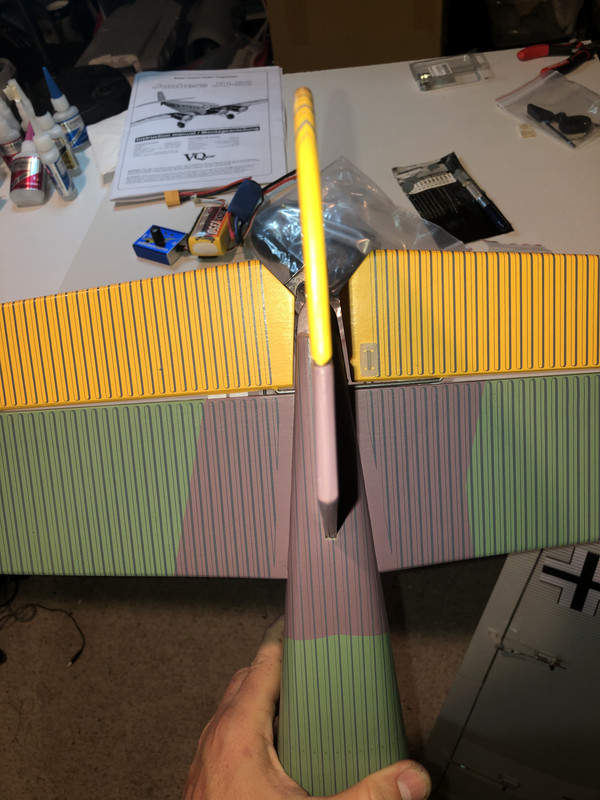

    I'm quite far into the assembly of my Luftwaffe Tante Ju. The assembly has been very easy. The printed corrugations on the covering are fantastic. When I first opened the box, I had to take a double take, because at first sight, I thought that the the corrugations were real. The only thing that I haven't liked has been the assembly of the split elevator. A piece of U-bent piano wire is used to connect the elevator halves. You have to drill the holes in each elevator half for the U Wire. The fiber hings are already glued into the elevator. The ends of the U Wire needed to go right where the hinges are. By offsetting the U Wire and finessing it a bit, I was able to get it attached, with both halves of teh elevator ALMOST being level. I was cursing through most of that work, mad that each elevator didn't have it's own servo. Then, after I'd gotten the H Stab and Elevator fully installed, and went to install the servo, I discovered that there was actually a mirror cutout for a servo on the other side of the fuselage, and I could've done individual servos, after all. <cursing, again>. I managed to get the elevator halves aligned closely enough that I didn't want to cutout hinges and cutout the U Wire. So, I've left it as one elevator running the split elevator. If I would've realized that two servos were an option, I woud've gone that route. If you've got the channels available and aren't worried about the extra tail weight of an extra servo, I'd suggest that you seriously consider doing dual servos for the split elevators.
    Wings are fully assembled (less the motors) and rudder and elevator are assembled.
    Oh, one other suprise...
    I'm using EMax ES9256HV servos (19g Micros, 48 in*oz (3.5 kgf*cm) torque at 7.4v), I know that these servos are overkill for this application, but my LHS store owner made me a deal on them that I couldn't pass up). The servos were almost too tall for the aileron slot (the bottom of the servo is pressing against the top covering (no sheeting in this location)). The real surprise, though, was that the servo slots for the rudder and elevator servos are too long for these servos. I had to cut a piece of light ply, to tighten up the slot. It works though.

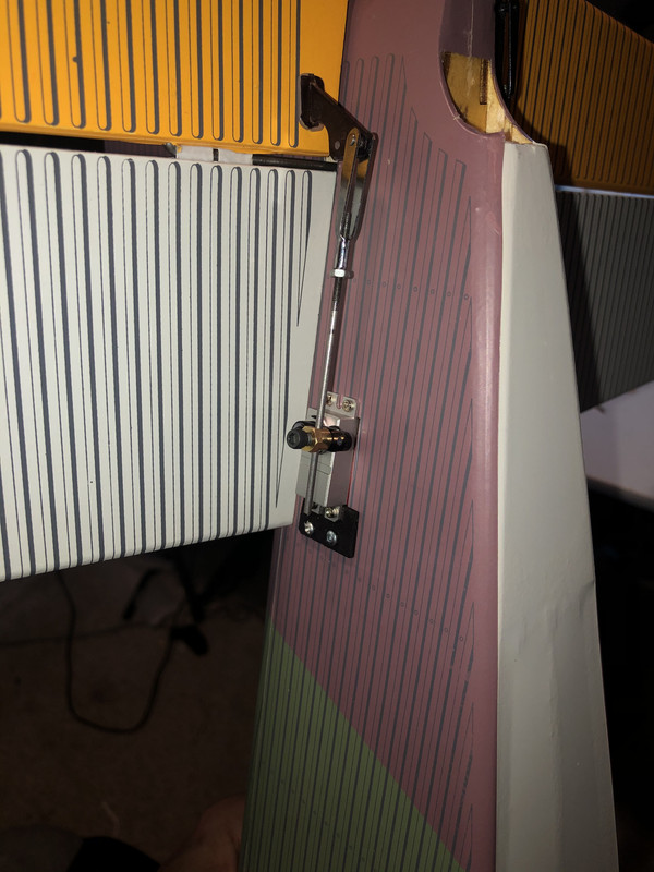

    Photo below shows the U Bend Piano Wire, offset to fit around the fiber hinges in the elevator.
    Photo below shows the piece of lite ply that I cut and Sharpied black to over the end of the gap in the elevator servo slow. Had to do the same for the rudder servo on the other side.
