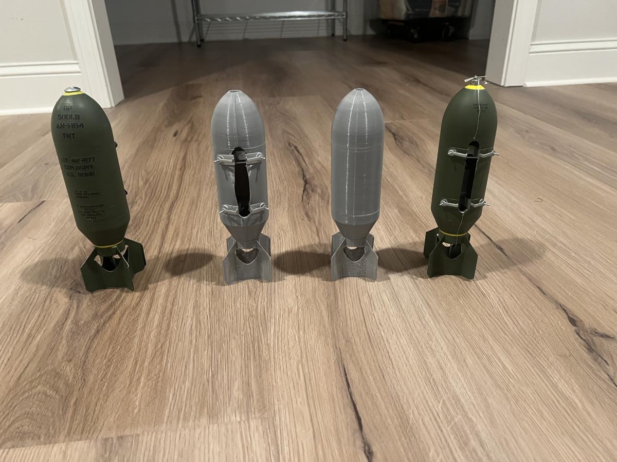

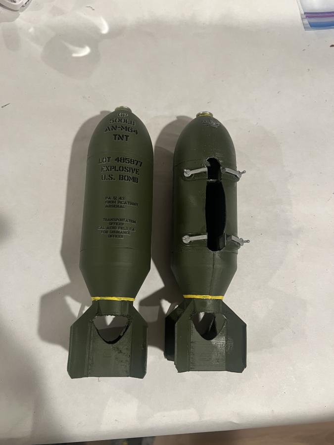

Below are a couple pics of my work in the past couple of days. One pic shows the under-development TPU bombs (silver) with two earlier PLA bombs. The other photo shows the TPU bombs painted as I will fly them tomorrow. I had to open a slit in the bombs so that they could slide into the stock Flightline wing pylon. The material of the bomb is so thin that it is very pliable but fits well onto the pylon and does well in drop tests on the bench today. They are substantially lighter than the PLA bombs, weighing under 2 ounces each.
