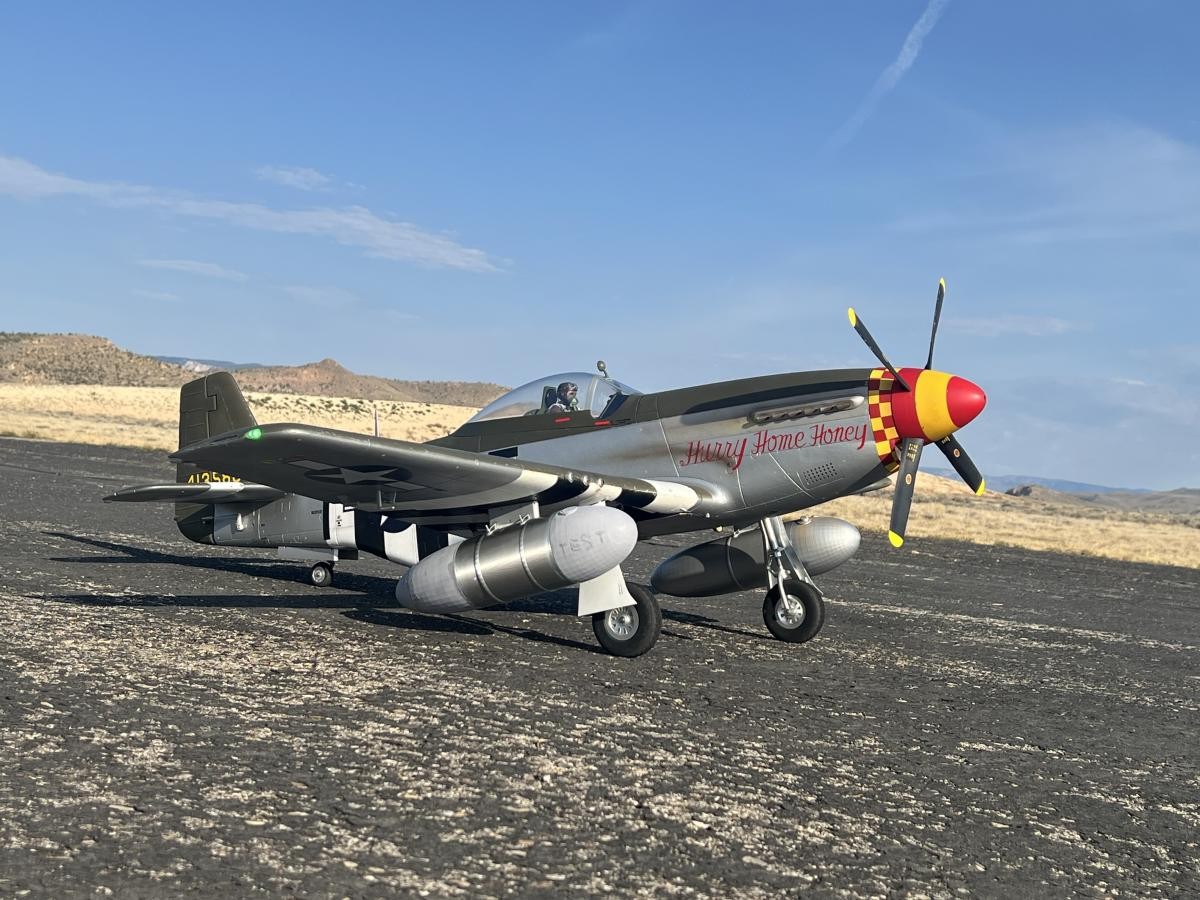

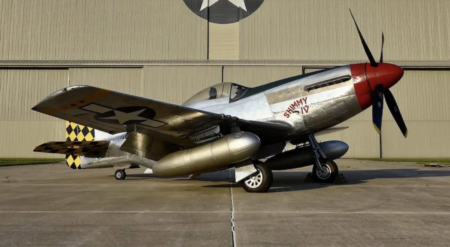

              Dave, I was just wondering from your latest photo if your tanks aren't a tad too big in diameter?
                Good question. We took measurements from a accurate model that had these tanks, and that's what they were when scaled up. But that will be one of the things we'll revisit to be sure they are the correct size before we proceed further. They do look a bit oversized when compared to your pic.
                Thanks for the input, we'll examine this to see how to proceed on with this project. A bit smaller would be good as less drag and less weight.

                  Hi Nuts-n- Volts: I did check the size of those 110 gallon tanks that we fabricated. The Flightline P-51D 1.6M airplane is 1/7 scale. The real 110 gallon drop tanks were about 100 inches long and 21 inches in diameter. My model tank is 14.4 inches long (versus real scale 14.28 inches long) and mine is 3.3 inches in diameter at the widest part (versus 3 inches for the real thing in 1/7 scale.) So it is slightly larger than scale. I think it might have "grown" a bit during our planning but it's not terribly far off. If we get some printed, we'll make sure they are 3 inches in diameter and about 14.3 inches long, per scale.

                      Thanks so much, Nuts-n-Volts! The current setup printing I have done works out fine, but the drop tanks just can't take the brunt of hitting the hard desert ground. However, the earlier rectangular drop tank designed by Dan Gross and then fabricated by Craft Cloud was more than up to the task of surviving the drop to the ground to reuse the tank again and again. It was tested again yesterday on my FMS P-47D Hairless Joe and it worked great.
                      So, I hope to work with Dan to make the corrections to the STL that you brought up about the diameter of the tank and a couple of other minor tweaks, Craft Cloud can print up a few of them and we can be assured they will survive the demonstration drop.
                      I appreciate your observations on the too-large diameter of the tank we came up with, and that was very helpful to changing this to look exactly the way we want it to, and properly in scale as well. When you pointed that out, I had to agree with you that it needs a little adjustment.

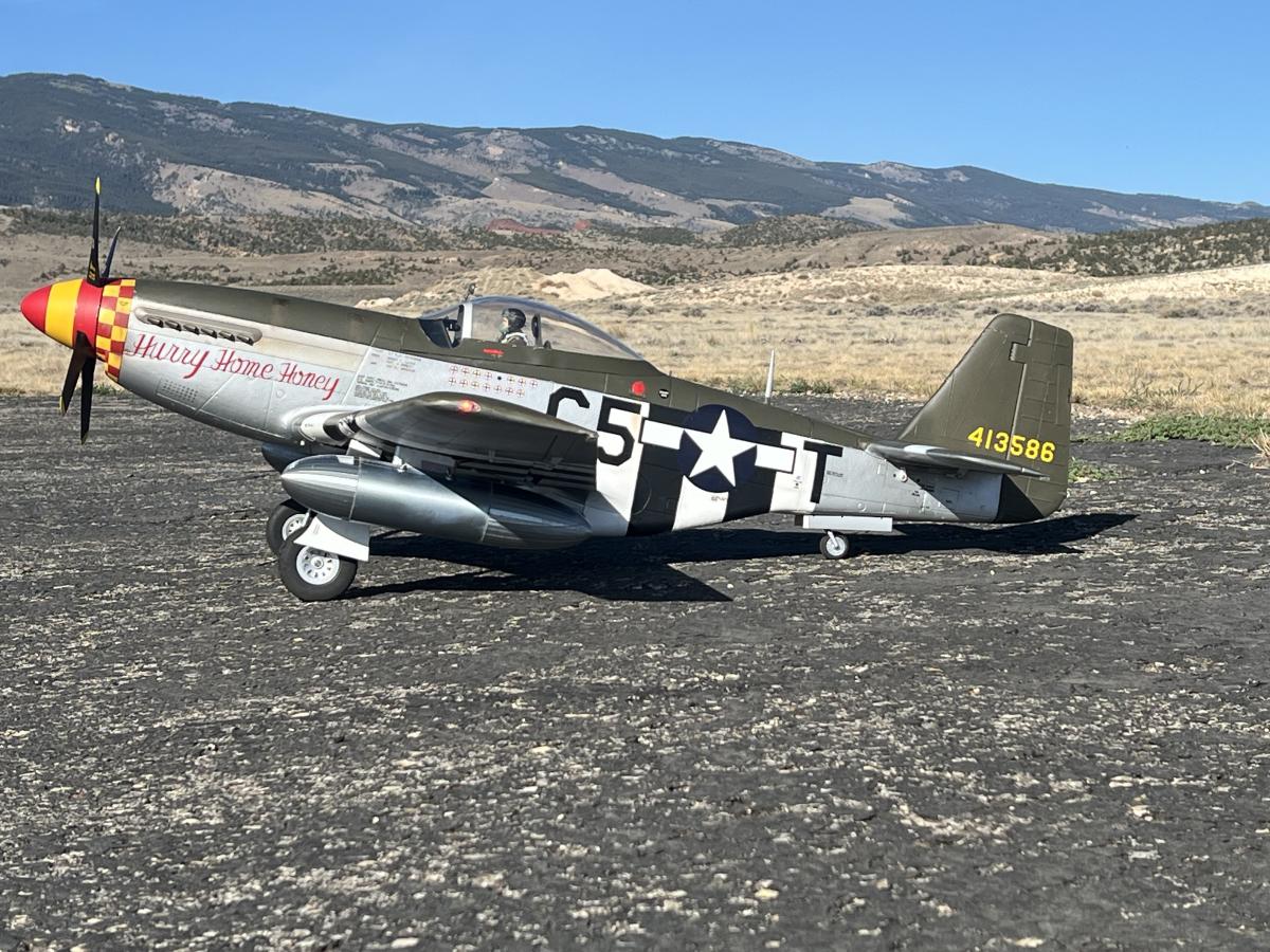

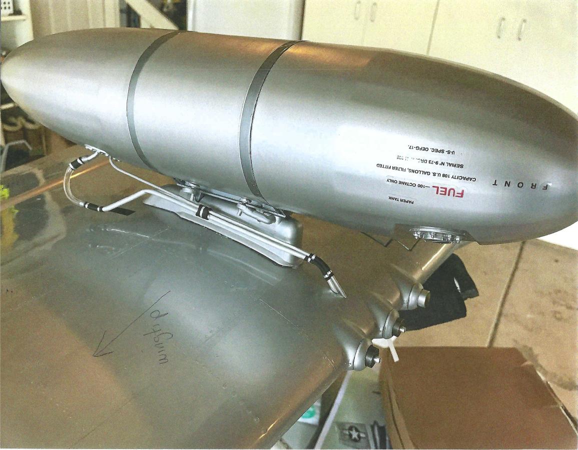

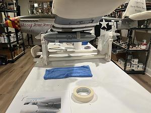

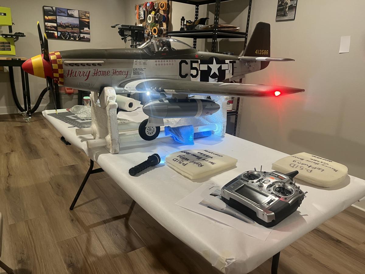

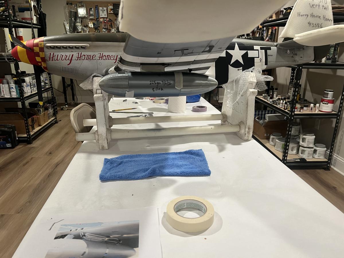

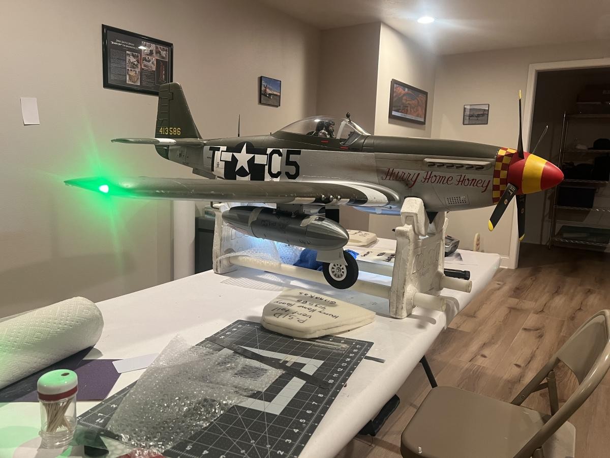

                        Nuts-n-Volts made an astute observation when Danger Dan and I put some of the 110 gallon drop tanks together in a 3D printed form. They flew fine three times, but were weak when landing on the ground and usually fractured. Nuts-n-Volts observed that the diameter, not the length, looked a bit too big. I hadn't even considered that, but when he mentioned it, I looked at it more closely and then measured the tanks. Mine were too large by 1/2 inch in diameter at the "fattest" part. They should have been 3 inches in diameter and 14.28 inches long, for 1/7 scale that the Flightline 1.6M P-51D is. They were actually 3 1/2 inches in diameter, and that makes a Big difference!
                        So, Dan made me some adjusted tanks that are now spot on, dimensionswise. I did some testing in my shop just now and have the tanks loosely put together with tape, and tested CG with the tanks on and off, and seeing how well they drop away from the airplane onto foam cushions on my work table. Everything worked out great. So, I will run a few more tests and weather permitting, I'll do a drop test with these tanks. I won't bother to paint them or put the final details on them until I know that they will survive the drop to the ground, but I am encouraged that their thicker shells will keep them from breaking. We'll see.
                        I'll attach some pics. On the CG tests, I decided to move the battery forward on its tray about 1/2 inch when the tanks are on. This is because the CG of the tanks when attached to the airplane is about 1 inch behind the markings on the wing by the manufacturer. They balance great there. And when I tested the CG with the tanks off, the slightly forward CG is not a problem in the balancing of the airplane after the tanks are released and the plane brought back in for a landing.
                        Kudos to Nuts-n-Volts for pointing out my error on the original tanks, and I think these will look better and more scale. Besides, it was a fun exericse in modeling!

                          Dave, 1st, those new tanks are looking spot on! Great work and I hope, think they will survive the ultimate drop test.

                                looking at our new iteration versus the pic of the real deal, it looks pretty darned good!

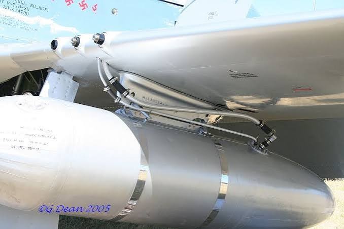

                                    Below is a real photo of a contemporary P-51D showing the air and fuel lines that connect the 110 gallon drop tanks to the wing tank. The second picture, (taken upside down) is the same scale tubing and a printed 110 gallon tank that was, and is, part of a display at the Mighty Eighth Air Force Museum in Pooler, GA, near Savannah. That model is a 1:4.5 scale CARF kit. The person that fabricated the 3D tank was the most incredible 3D modeler I have ever come across, and this he did in 2018! He worked for a government contractor and did all sorts of classified and non-classified projects for the govt. I built and painted the plane and did the detail work of the plumbing for the tanks and airplane. The small section of clear tubing on the model represents glass tubing that was used to ensure that they got a clean separation of the tank from the wing when they had to punch them off in combat situations. Mine is just clear flexible vinyl tubing for that part. The real airplane in the photo didn't go to that level of detail, I guess.
                                    Click image for larger version  Name:	images (2).jpg Views:	0 Size:	42.8 KB ID:	452465 Click image for larger version  Name:	Photo_2026-08-12_140547.jpg Views:	0 Size:	133.4 KB ID:	452466

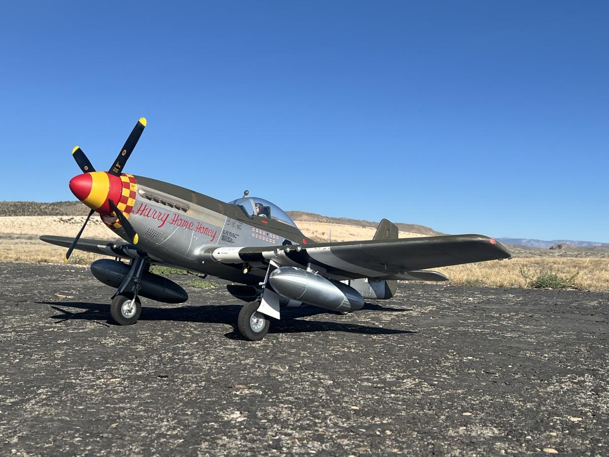

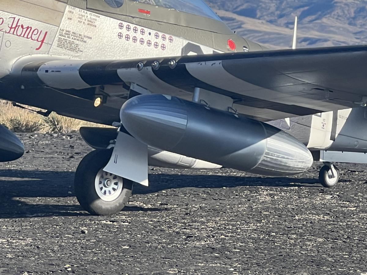

                                      I took HHH out to the field to hopefully test fly the new printed 110 gallon drop tanks this morning. Weather was beautiful. The tanks came out very well, I think. Dan Gross did a sterling job with the design and I was able to get them ready for mounting to the airplane. I use the same mounts that the OEM 75 gallon foam drop tanks and the 500 pound bombs that I printed up from an STL that I bought.
                                      Unfortunately, after doing a series of test taxi runs up and down the runway with them attached, one tank would stay on ok, but the other one would drop off whenever I went over a small crack or bump in the runway. I tried a few ideas using a bit of masking tape to make a little better fit so they would stay on, but they were just too heavy. They weigh slightly over 8 oz. each, and the OEM drop mounts on the wings just aren't up to holding that heavy a weight.
                                      I decided I had to "punt" using the present setup. What would be ideal would be a custom foam scale tank and that would work fine. Possibly even making them with thinner walls might take enough weight off of them that caused the problems this morning, but then you have problems with damage when they hit the hard ground.
                                      So, I have the correct size, a well -designed and accurate drop tank, and maybe I can come up with another solution for getting a lighter version of these tanks to be able to be dropped in flight to a safe landing. I'll attach some pics at the field this morning. After I decided a test flight with these tanks that could very well come loose in flight and spell disaster, I did a couple of flights without any ordnance for some fun. It is a great flyer!

                                        If you could determine how the tanks are landing(hitting the dirt) you might be able to make those aeras strong and less in the non-crucial area. Just my .02.

                                          Good point. The weak points were when they landed on one end or the other. That caused breakage of the tank at that point. We went in with reinforcing those forward and end piece cones internally, and I'm hoping that will fix that problem. It they land flat, they usually aren't damaged.
                                          The main issue right now is the OEM wing mounts that we hang the ordnance on. There is a clip at the forward end of the wing mount, and that is the only place that keeps the bomb or tank attached to the plane. That is no problem for the very light OEM teardrop-shaped foam tanks and the 500 pound bombs I printed up which are much lighter and smaller, but the big 110 gallon tanks like I tried today are very long, and attaching to that single mount way in the front portion of the tank. It's just too much for that mount to hang onto the bar on the bomb or drop tank to keep it attached until commanded to release.
                                          Weight (of the large drop tank) is definitely a problem right now. The OEM wing mount is really well designed, for lightweight ordnance. But I'm going to work on a lighterweight version of the big tank, and that would be a solution, I think. I'm very happy how the actual tank came out, and it could always be a static display, or attached to the wing mount so it flies with the plane without dropping inflight. Lots of possibilites. But I still hope to get it to work.
