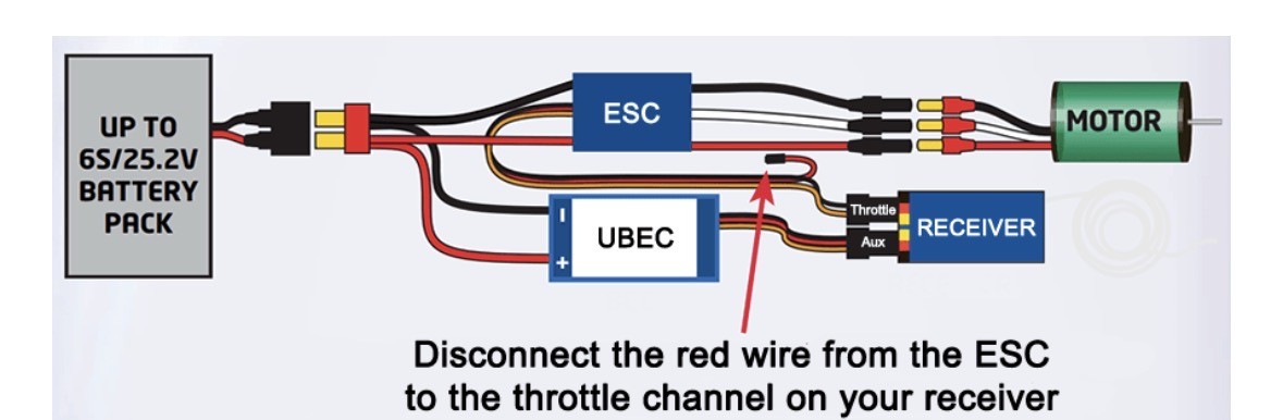

Question-With the stock ESC (built in BEC) providing power to the RX via the throttle lead, what precautions / wiring changes, if any, plugging in a separate BEC into the RX? Or…do you just allow them to both run in parallel,per se?
-GG
7A, does not say if there is a burst or if that is the burst. I assume that is a constant rating and they don’t list a burst but would assume at least 10A.
If you are not trusting the stock ESC and adding a separate BEC I would go bigger, 20A and maybe one with dual output leads.
