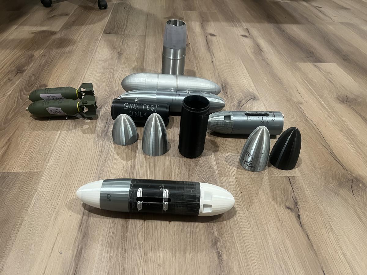

          Been working hard on coming up with a droppable, scale 110 gallon tank that can be released in the air and come down (hopefully) undamaged. There have been several test iterations of this concept recently, starting with tanks that were carried and dropped successfully, but were too large for scale. That has been corrected, and Dan and I working together, him on the computer designing these parts, and me printing, testing, and putting them together for eventual flying. We're not there quite yet, but I hope to do a test fly and drop later this week with P-51D HHH.Finally got the CG of the long and fairly heavy tanks to line up with the CG of the wing. That was no small accomplishment. We'll see when we do taxi and hopefully flight tests how they do. We take heed from lessons learned with each disappointment or failure. That helps develop better results later.
          Below is a picture of the various iterations in test that we have been working on. In the back are parts of the original "too large" tanks, and in the foreground is the current test article along with a twin being fabricated now will try the taxi/flight test drops later this week. The reason for the mulitlple colors of the tank, is that I ran out of my preferred silver filament, and had to do with what I had lying around until a replacenent spool comes today. (they'll all get a grey primer and silver coat, anyway!) But we got the weight down substantially by a couple of ounces or more by thinning the walls as much as possible and I"m hopeful they'll be successful this week.
          Assuming that goes well, continued testing in the shop and in flight, and then painting and detailing for the final product.

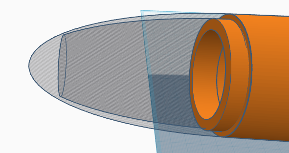

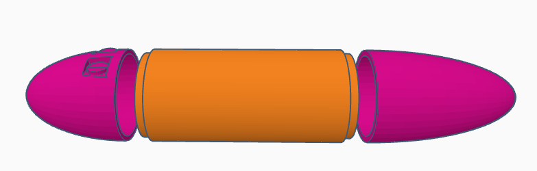

              These have been a challenge for sure. We realized that (uniquely for these large flying pieces) you have to take into account their CG and how that aligns with the aircraft's CG. The walls are now 3.0mm thick and the ring thicknesses (the pieces that allow the fore and aft sections to mount on the center section)have been reduced in thickness substantially as well.
              Click image for larger version  Name:	Screenshot 2026-09-05 152250.png Views:	0 Size:	86.7 KB ID:	452578
              It's a trade off between strength and weight a fine balancing act, but the learning curve went way up with this project Click image for larger version  Name:	Screenshot 2026-09-03 183240a.png Views:	0 Size:	21.8 KB ID:	452579

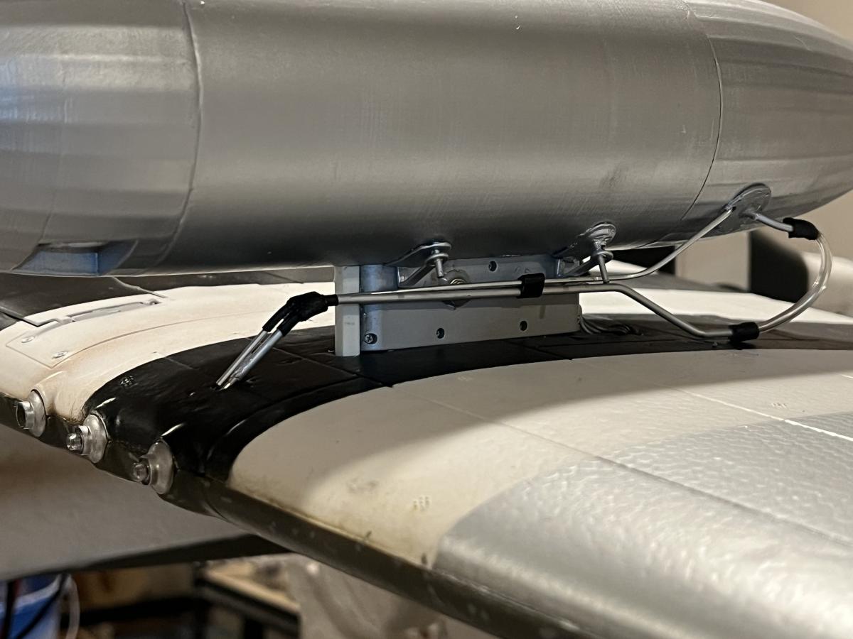

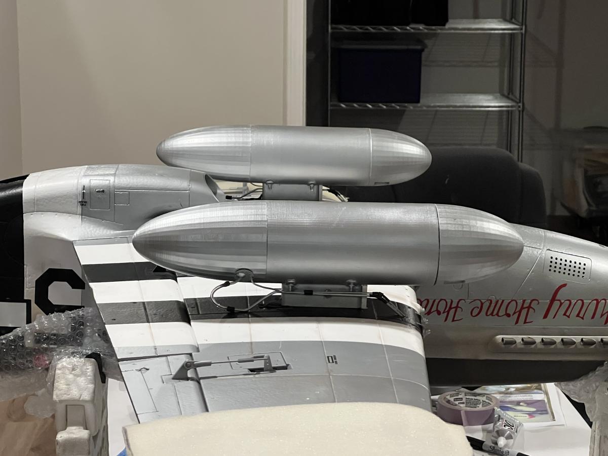

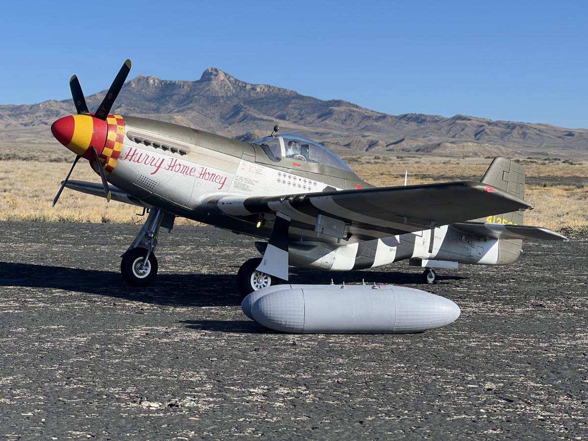

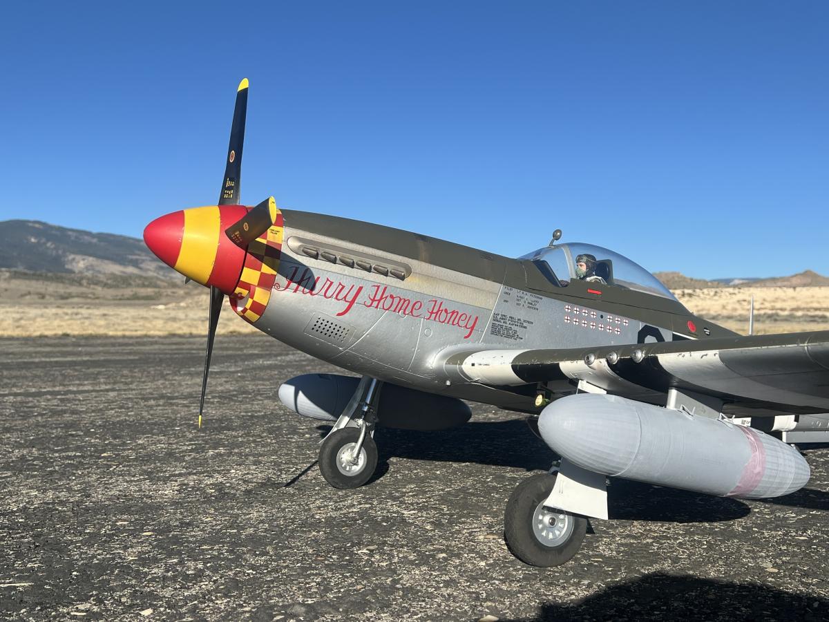

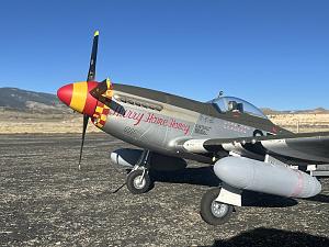

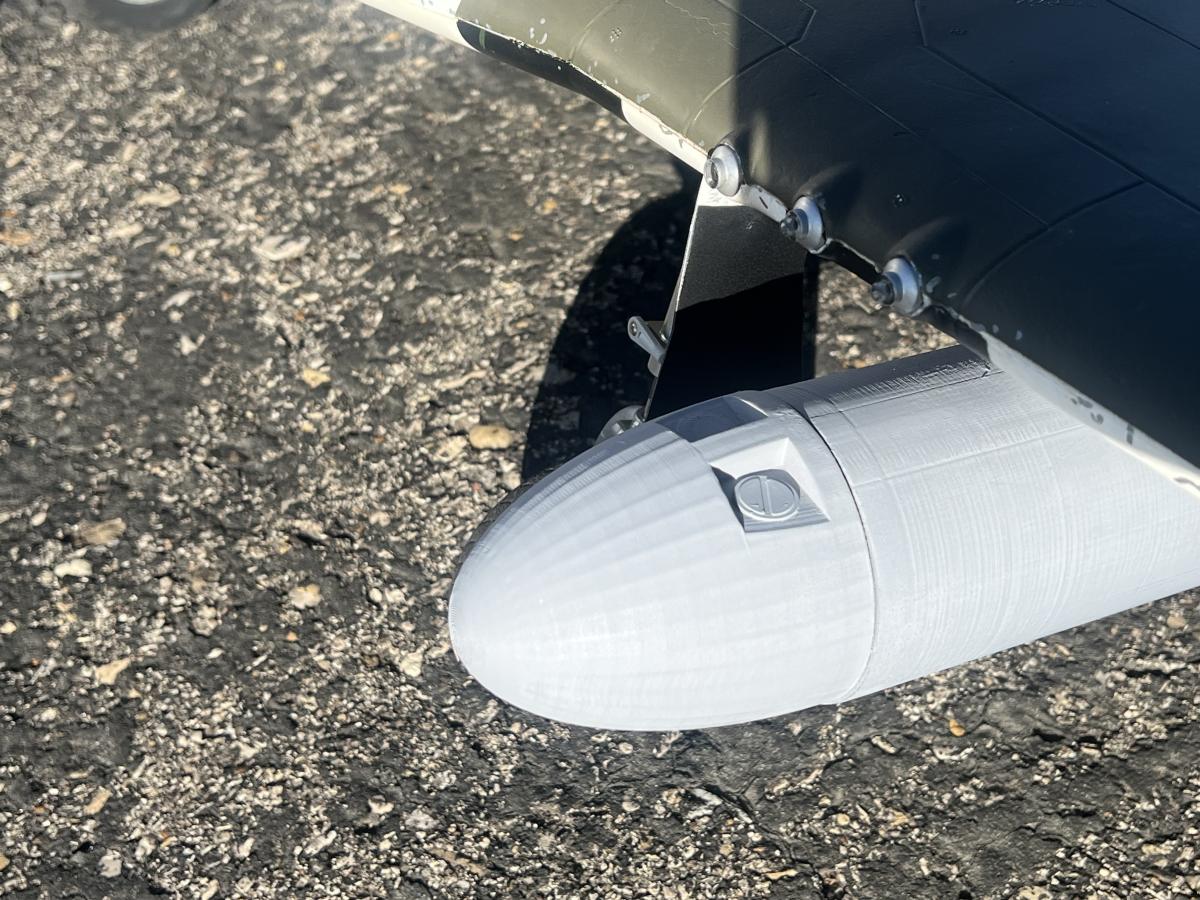

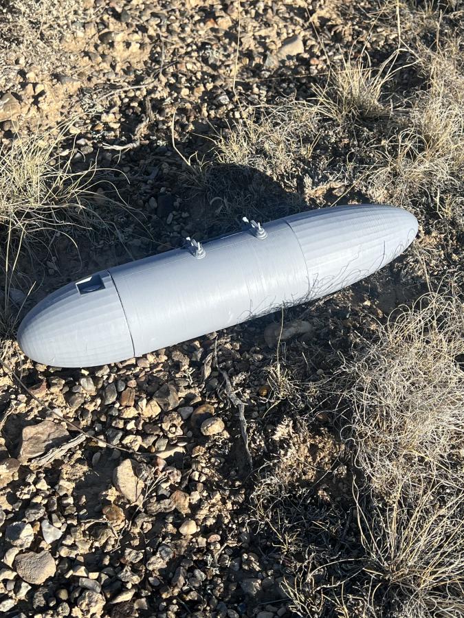

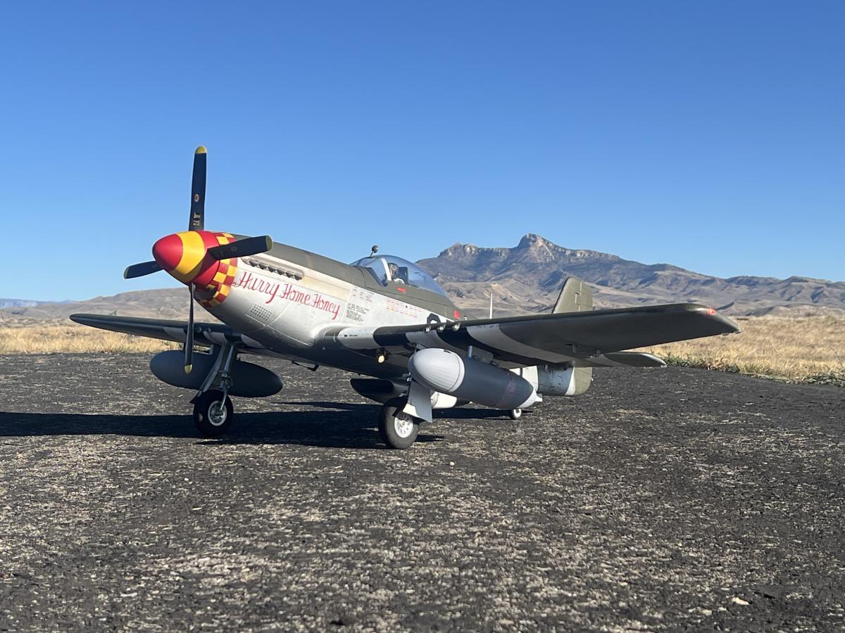

                    Had a great morning testing the new 110 gallon printed drop tanks this morning! First flight, I flew the aircraft clean to get warmed up for whatever was going to happen. No problems there. Then, I mounted the tanks, did CG tests of the airplane without and with the tanks installed. Each tank weighs about 6.5 ounces. Tested the drop mechanism, It can release the tanks in about one second in an emergency. Both tanks were painted in a primer grey for this test. Final finish will be silver.
                    Last time, I couldn't get the tanks to stay on the pylons during taxi on our rough runway. So, no flying that day. The solution was to adjust the slot on the tank that the pylon slides into, and that moved the CG of the tank right with the CG of the wing that is noted with raised letters in the foam from the manufacturer. I figured that should probably solve that problem. It did.
                    Taxi checks passed with flying colors. Then it was time for the moment of truth! Acceleration was normal with the extra load, and it lumbered into the air after takeoff and actually had a fairly good climb rate. Did a few circuits over the airfield and everything looked good. So, I came around again for a fairly low pass at medium power and released the tanks. They "jumped" off the pylons together, went unstable and did a bit of slow spinning until they hit the ground. I continued my flight with the clean airplane and eventually made an uneventful landing.
                    I made a quick walk to see how the tanks did through the drop and landing. One of the tanks had a slight scuff of dirt on the nose, no damage whatsoever. The other tank landed without damage, although the tail section came loose at the joint with the center section. I should explain that this tank was an extra one that had problems in the printing, where the centering rings to mount the nose and tail sections were molded off center and those parts were also off of center a bit. In the interest of getting a test flight underway, I sawed off the offcenter bottom ring and did a butt joint with E6000 glue to make it fairly centered on the tank. This is the joint that failed on landing. The rest of the tank was undamaged. This is probably the only flight I plan on doing with this tank as new ones without this problem are being printed now with perfect alignment.
                    A second flight was made with similar results. There is a piece of lavender tape that kept the aft section in place after breaking loose on the first flight that I discussed above.
                    So, in conclusion, I think the project was an unqualified success overall, and I'll start working on finishing the second new tank and paint and detail them for completion. I'll probably fly the finished forms at least one or two times before I call this project good. I still have the OEM 75 gallon teardrop tanks and the 500 pound scale printed bombs which work fantastically.

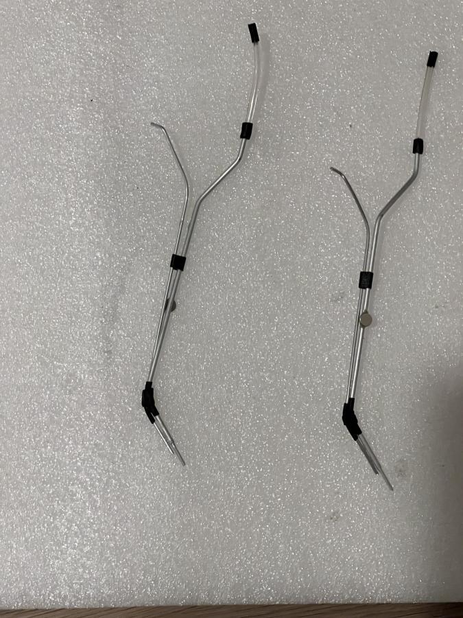

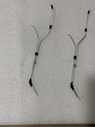

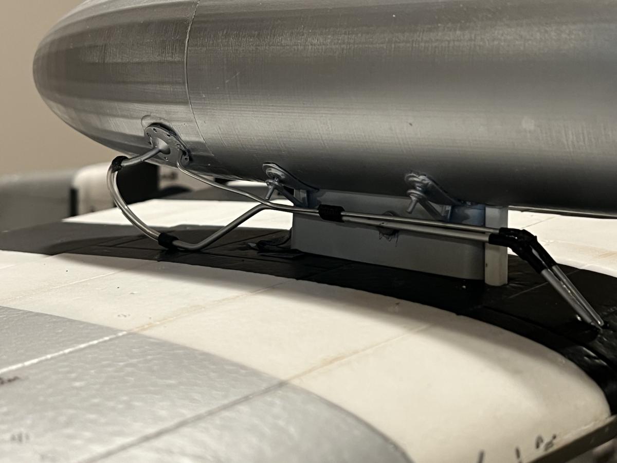

                                  Spent some time working on scale details for the 110 gallon drop tanks. This is piping that fed from the drop tanks to the engine of the P-51 on longhaul missions to Germany and other destinations. They also had a 85 gallon fuselage tank behind the pilot, and the wings had two wing tanks of 90 gallons capacity each.
                                  This plumbing for the drop tanks had a section of glass tubing that ensured that the drop tank would not hang up on the airplane once released. I used a section of small diameter clear vinyl tubing for this simulation.
                                  I'll attach a few pics of the details of the scale piping that can fly with the airplane and tanks, but due to its very fragile nature, I will most probably use them as static display items. Got 33 flights on HHH so far.
                                  Cheers
                                  Davegee
