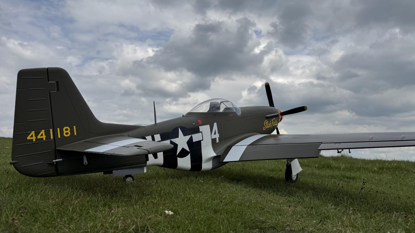

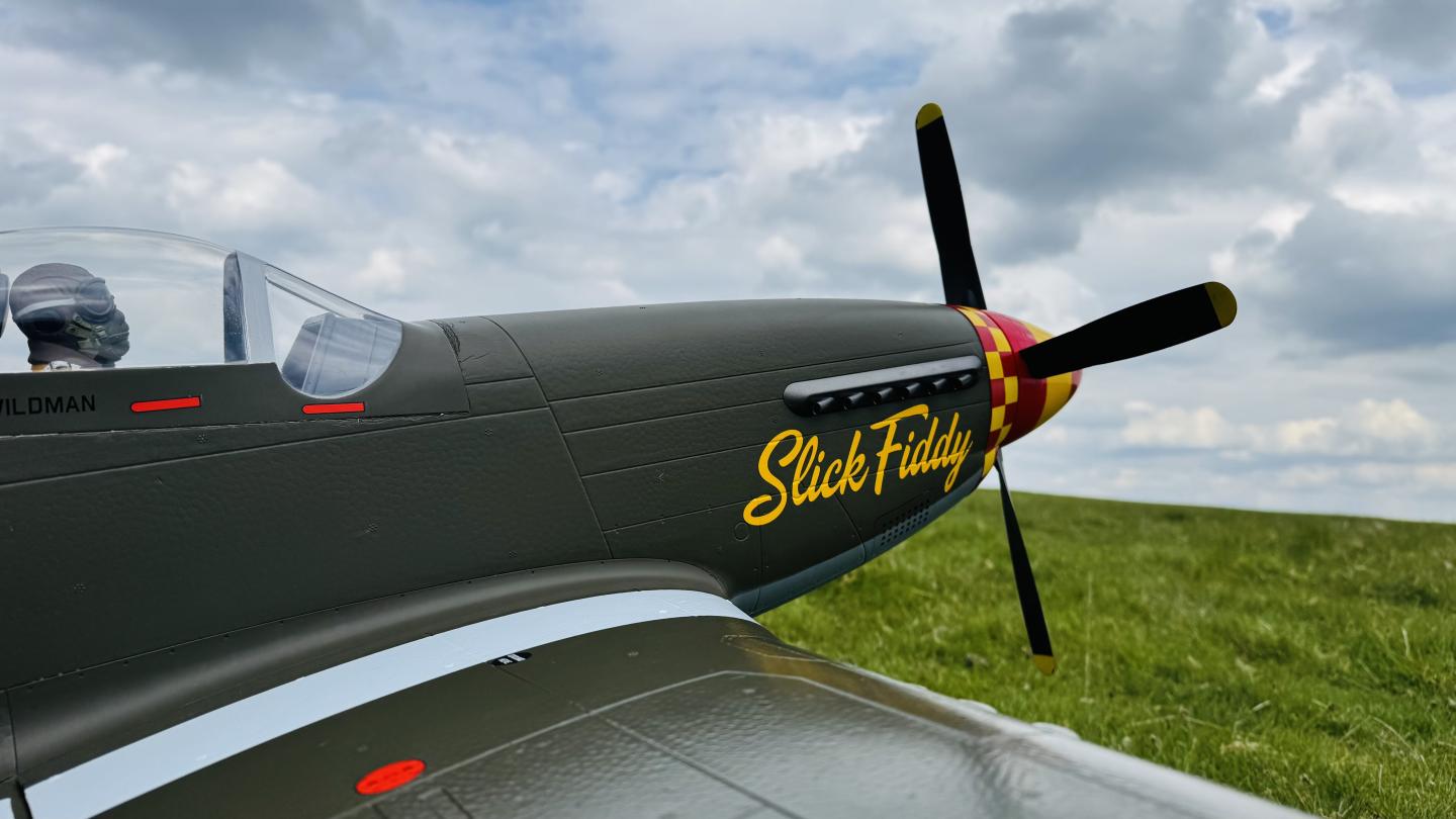

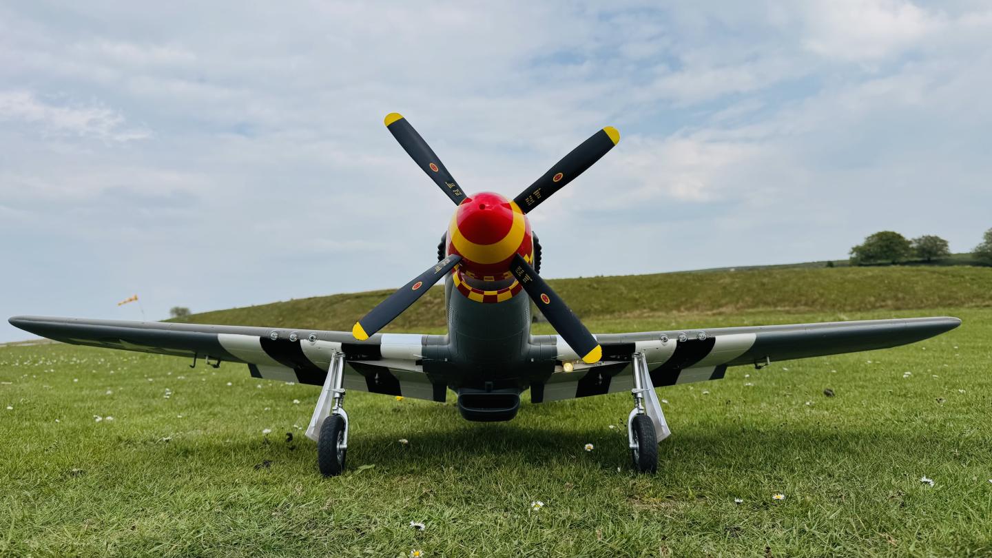

          Loving this bird! 27 flights and over 3 and a half hours airborne. Using Hoovo 6S 5200's I'm getting on average around 7:30 with some left in the 'tank' for a go-around. Custom graphics by Callie, going to do some weathering eventually.
          Just incorporated gear door droop after motor shut down, flap droop and elevator droop. Nice little scale details.

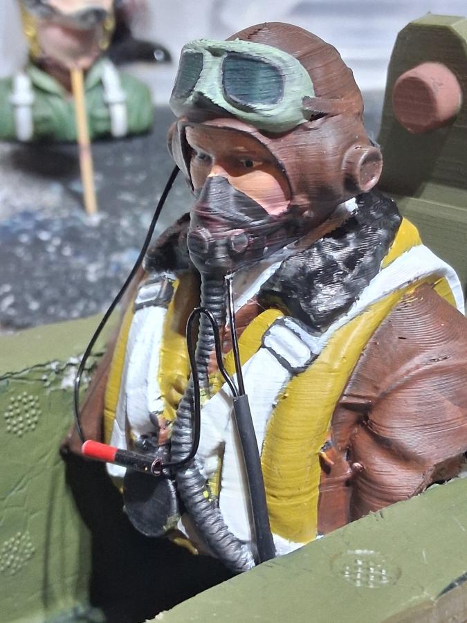

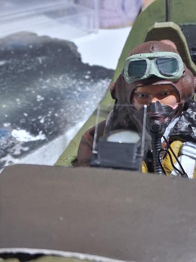

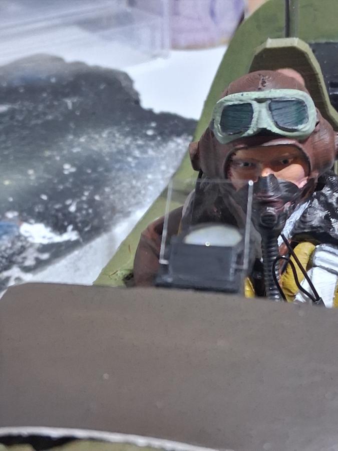

                DaveGee just got his and we're working on a pilot. The bust I think we'll end up using will be an upsized version of the one I have in the P-51B. He just fits so well.
                BTW, the gunsight is my N9 design.
                Click image for larger version  Name:	20260530_093940.jpg Views:	0 Size:	91.0 KB ID:	449683 Click image for larger version  Name:	20260530_093946.jpg Views:	0 Size:	59.2 KB ID:	449684 Click image for larger version  Name:	20260518_131706.jpg Views:	0 Size:	105.7 KB ID:	449685

                  Grossman,
                  Your Pilots are fantastic. Outstanding Craftsmanship. Bob is still on flight status.
                  Best Regards, Rex

                    Grossman56,
                    Is that the Max Grueter P-51 pilot bust?
                    Looks great regardless, Danger.
                    Best, LB
                      • 7430
                      #430
                      Yes, the Max Grueter bust, the shoulders have been shaved slightly so he is a nice tight fit.
                      Dave went with a different pilot that I found on CG Trader, he has separate arms and a full body, so he cut him at the waist.
                      The pilot was originally made for a 1/32 scale Revell P-51 model kit that he enlarged. It's not bad either, I have him in the basement drying after the black coat application.
                      You can check him out here.

                        #431
                        Grossman56,
                        Thanks, Danger.
                        I have the P-51 pilot in full figure, just hadn't seen the bust only version.
                        Diggin' all the extra details.:star_struck:
                        Best, LB

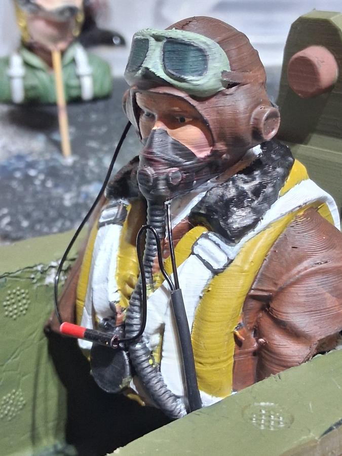

                          #432
                          Dave just sliced off his lower end.
                          The print is a little rough but doable. Is there any way to increase the resolution?

                              #434
                              (Dangerous Dan)
                              Dan,
                              1. Post processing FDM prints with acetone works wonders, though some detail can be lost if you go too far.
                              2. Reduce the layer height in Prusa Slicer
                              3. Slow the print speed which can also help reduce artifacts in the prints.
                              I have all of these things and each has it's own effectiveness.
                              Best, LB

                                    #437
                                    (Dangerous Dan)
                                    Hi Dan: I just saw your post on 19 June. I don't know of a way to make the print resolution better. There might be some way to do that, but I don't know how to do that, if it is even possible. Can you make it work as you have it now?? I think it is still probably better than the OEM bust that comes with the kit.
                                    Thanks,
                                    Dave
                                      • 4873
                                      #438
                                      davegee.
                                      You can decrease the layer height in Prusa Slicer.
                                      More layers better resolution.
                                      See below.
