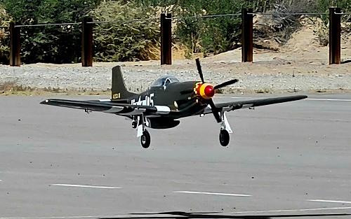

            #225
            Click image for larger version  Name:	3201454009421947701.jpg Views:	0 Size:	178.3 KB ID:	446883 Oh what a great Easter Sunday this was!
            I have almost 40 flights on the plane now and I can say that it just keeps getting better!
            How many warbirds can you say that takeoff and landing are the two favorite things to do lol.
            I too do wheel landings with about 25% throttle on final chopping to about 10% as I cross the threshold
            then……
            Yet another…..
            smooth like butter landing😎
            she makes you look so good!

              #226
              Nice photo Gz808...I agree.
              And the best thing is that she doesn't go crazy when you don't make the best landings. Even the touch after a bounce stays under control and "mostly' very straight. Roll-out after a smooth butter landing is uneventful for experienced tail dragger pilots.

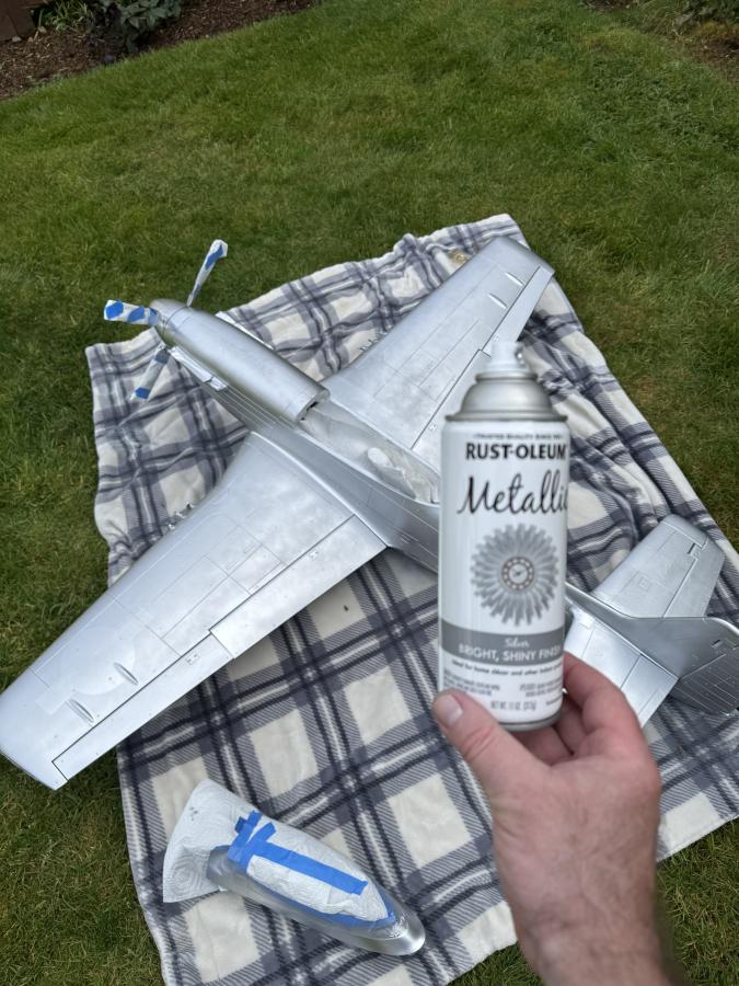

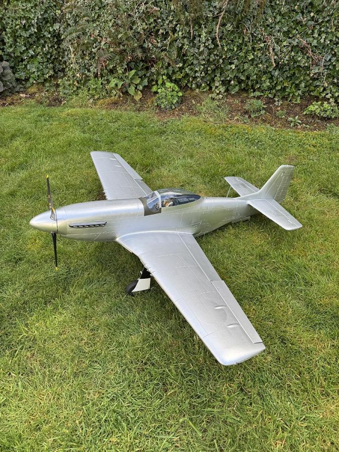

                #227
                This paint is perfect for what I was looking for. Thanks for the suggestions gents. I tried masking off the nose and invasion stripes but the paint peels on both so she’s going to start out with a clean metallic aluminum finish to start.

                        #231
                        Thank you but I already bought a Rustoleum Yellow...May not be exact, but close. I don't like canary yellow...More of a mix of orange in with the yellow for me.
                        I can't say enough how pleased I am with the results of the base coat! After Callie's decals and my final touch ups, I will hit it with Polyurethane.

                          #232
                          Pretty…You may want to get the opinion of others on painting a polyurethane overcoat on a metallic luster paint. Especially, if you intend to polish the metallic to a shine.
                          I have some reservations about the outcome not being what you’d want unless it is sprayed on. Even then, I have concerns. But it’s a gut feeling. I’ve never done it.
                          You may want to polish to a shine and omit the poly overcoat.

                            #233
                            G Guy how would you polish foam.. just asking.. if your purpose is shiny. Just clear it. Always learning

                              #234
                              Also polishing silver. Can make it patchy. Or blotchy

                                #235
                                I use car detail spray.

                                  I'm not sure how to polish the metallic acrylic paint to a shine?
                                  • GliderGuy
                                    • 1416
                                    #237
                                    Experiment.
                                    - Take a scrap EPO part and paint it with the metallic paint.
                                    - Let it dry extremely well
                                    - Buy some fine grit auto body compound
                                    - Apply elbow grease polishing with soft cloth
                                    - Finish off with auto body detail spray
                                    I’ve only polished full scale sailplane wings.
                                    -GG
