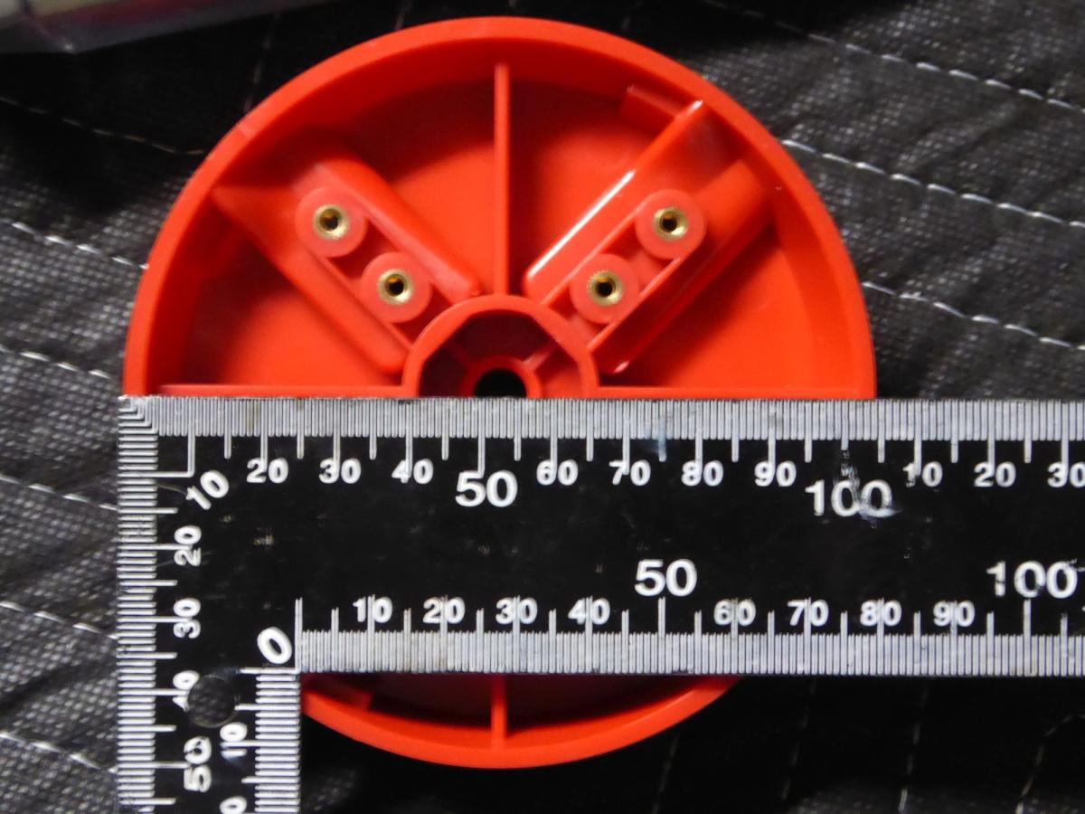

        Next time someone has this plane out and handy, could you give me the diameter of the prop base plate (next to the cowl), please. One option to inject some zest into my old FMS 1700mm P-51 is to use this new FL P-51's propeller and motor. Since the motor is a bit higher KV than what's in the FMS and the propeller seems to be much more stout (metal reinforcement plate), much higher pitch and designed to spin at the given KV. However, if the base plate is too small or too big, I'll take that option off the table. (Not that these parts are available yet anyway.)

            Xviper - base plate diameter is right at 102 mm +/-
            about 4 inches
            -GG
              • 5385
              #86
              105mm from the other site.
                Prop base plate picture with ruler - about Click image for larger version

                  Perfect! Thanks everyone.
