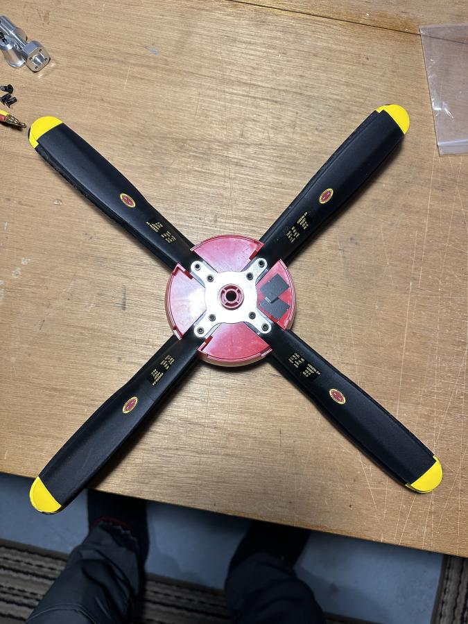

    Great job viper. Looks original
    Thanks, I really hope it was worth the effort. I just wanted a bit more oomph in the performance dept. The only major visual difference (to my eyes) is the width of the blades. The FL blades are quite a bit narrower than the FMS ones.
ID:	446588 FL on top of FMS.

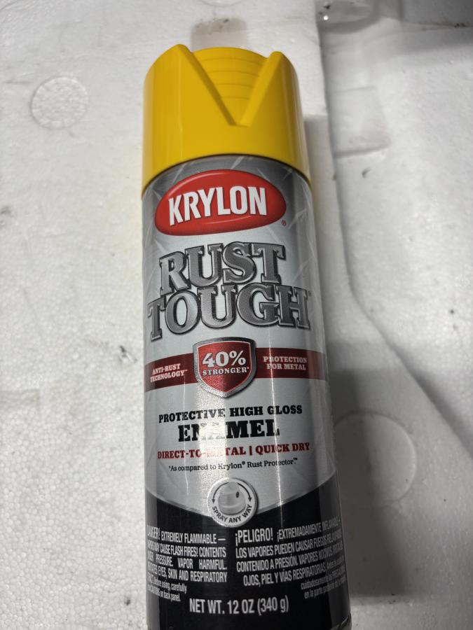

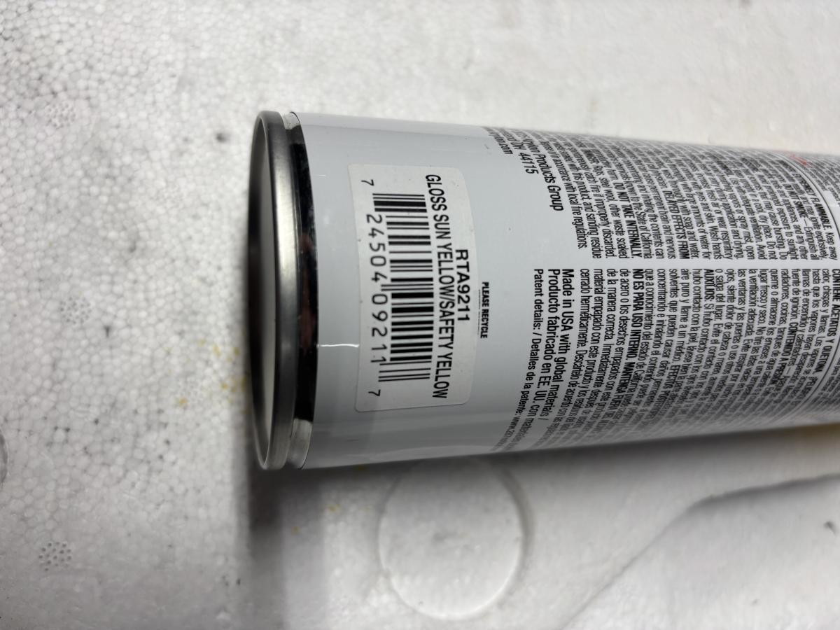

      Lifetime supply for perfect FL P-51 prop tip paint match…
      Click image for larger version  Name:	IMG_0432.jpg Views:	0 Size:	121.3 KB ID:	446610

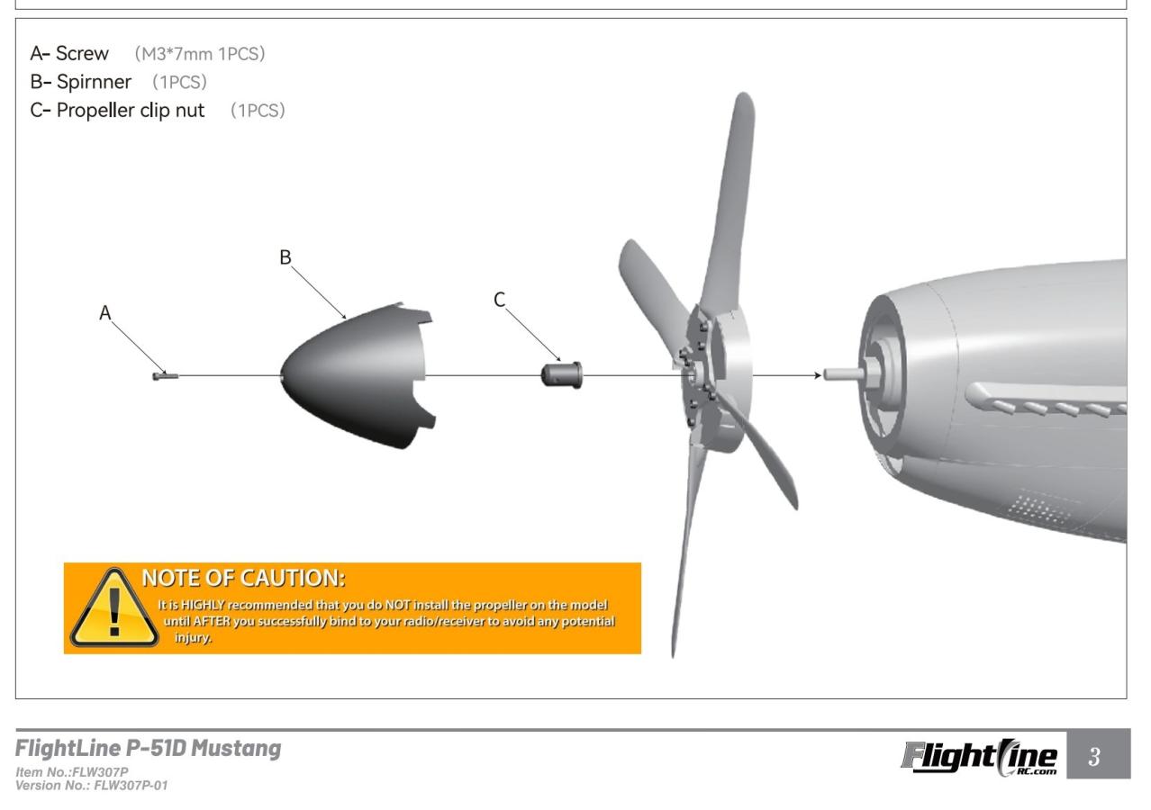

        GliderGuy sorry for the delay but I updated the manual as per your good suggestion.
Name:	Screenshot 2026-04-01 084545.jpg

          Good deal, and thanks for doing that.
          Potentially MUCH safer, now, for this powerful motor/big prop combination.

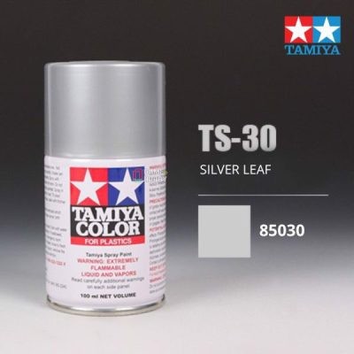

                              The FL P-38 silver match is TAMIYA TS-30 silver leaf.
                              You know what that finish looks like.
                              There may be a better option for a polished aluminum-like paint, but the TS-30 is pretty good, and it re-paints/repairs very well.
                              -GG
                                #195
                                -GG
                                Thanks, however that's lacquer-based. Would it be EPO foam safe?

                                  Can't speak for anyone else, what I have found using a rattle can with lacquer/enamel solvent is I only have an issue if I spray too heavy a coat onto the foam.
                                  That has caused some gatoring within 3-4 minutes as the solvent does not seem to evaporate quickly enough and must be attacking the foam's finish.
                                  I have found this to be true even after applying several coats of Minwax Poly and allowing those to cure.
                                  3-4 light coats is how I now shoot rattle can onto EPO whether it is primer or color.
                                  Best, Steve
                                    #197
                                    Good advice! I've made that very mistake. Lacquer is scary on foam. Light coats indeed!
                                    • GliderGuy
                                      • 1416
                                      #198
                                      Aros…as an experiment, I took an old FL P-38 wing and heavily sprayed the TS-30 on a factory painted wing and let it sit. There was no degradation of the wing foam. It looked good as new after it dried.
                                      Caution…Beyond any added weight considerations, I had the not so brilliant idea of using aluminum duct tape for the leading edge slats on an AL-37. IT LOOKED GREAT!
                                      That is…until she flew. Any foam flex is transformed into permanent wrinkles in the duct tape. The slats looked awful after a few flights. But, if this had worked, a polished aluminum finish would have been the result.
                                      Are you planning to sand off the P-51 factory paint!
                                      -GG
                                        #199
                                        Good to know on that flex! And also nice to know the TS-20 didn't show any degradation of foam. No, I was not planning to sand. Simply mask off and wipe down and wait for a warmer day to paint.
