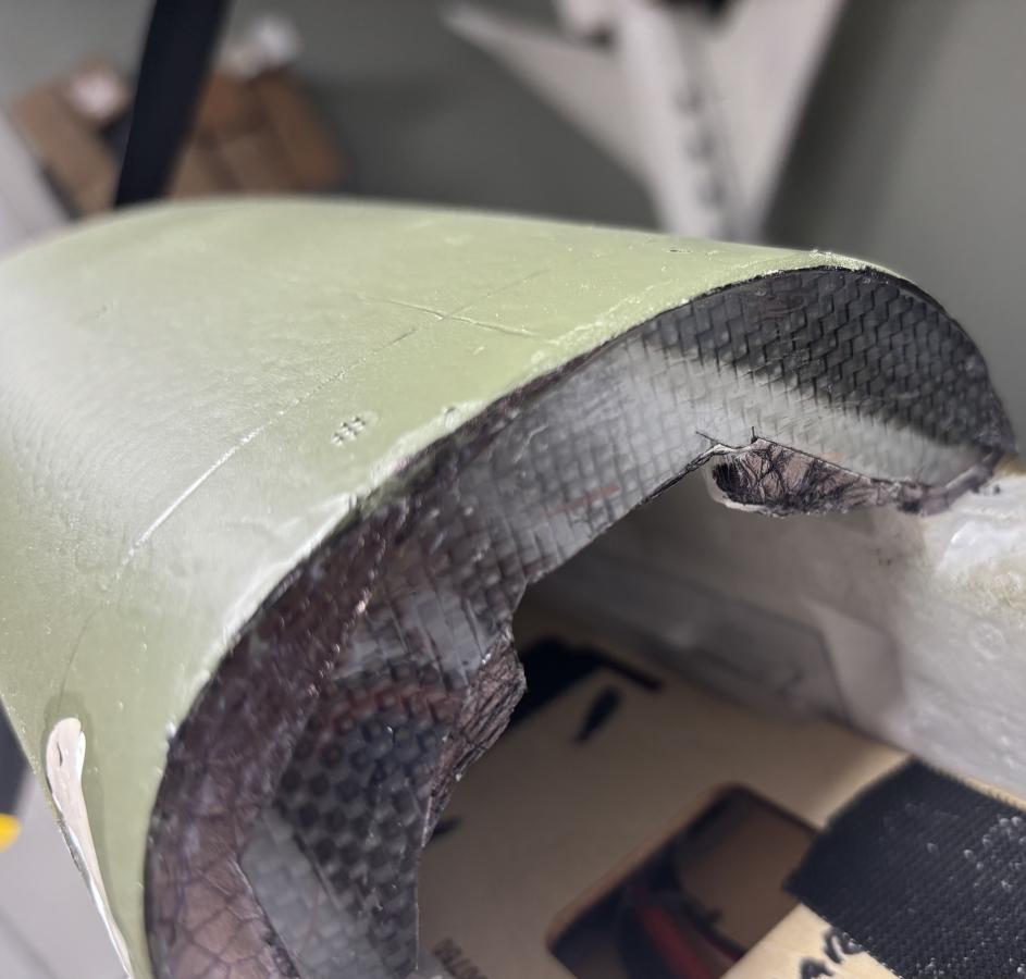

                Cosmetic tip….
                After many flights, I noticed the fuselage foam at the (pilot right) front of the canopy well was compressed. A gap between the front right side of the canopy assembly and fuselage had formed. Hmmm….
                Was I putting the canopy assembly on without checking alignment? Nope.
                After paying attention to my battery removal and installation procedure, I found that my fingers were compressing the foam.
                To prevent this, install some thin plywood or carbon fiber sheeting layered onto the front side of the canopy well. Fat fingers won’t compress this tough layer! If it is thin enough, the canopy fit isn’t impacted.
                After gluing on a thin sheet, I then filled the gap of the compression, sanded and painted the filler.
                If you get ahead of this, you will avoid the fill/sand/paint step.

                    #349
                    Cosmetic tip….
                    -GG
                    could you share a photo of what you did please?
                    • GliderGuy
                      • 1416
                      #350
                      Click image for larger version  Name:	IMG_0643.jpg Views:	0 Size:	66.6 KB ID:	448678
                      Sure…Not pretty, but I had an odd sized piece of thin carbon sheet.
                      The important side to sheet is the right side. This is where your fingers will compress the foam.
                      A black Sharpie pen was handy and quick way to paint the rest of the white foam not covered by the sheeting. I intend to redo better with black paint, soon.
                      -GG

                        #351
                        -GG
                        great thanks looks aren't everything. wonder if i could print something with pla. i don't have carbon or balsa sheeting around but a dab hand with my 3d printer
                        • GliderGuy
                          • 1416
                          #352
                          Why not? Keep it thin! Needs only to be a thin, stiff layer that keeps your fingers off the foam.
                          Balsa will compress, so if you use wood…needs to be a thin aircraft grade plywood.
                          No harm done it the added material prevents the canopy from seating….sand on it where it is binding.
                          -GG

                            #353
                            Cosmetic tip….
                            -GG
                            a thin layer of epoxy may well be a simpler way ?apply with finger wearing nitrile glove
