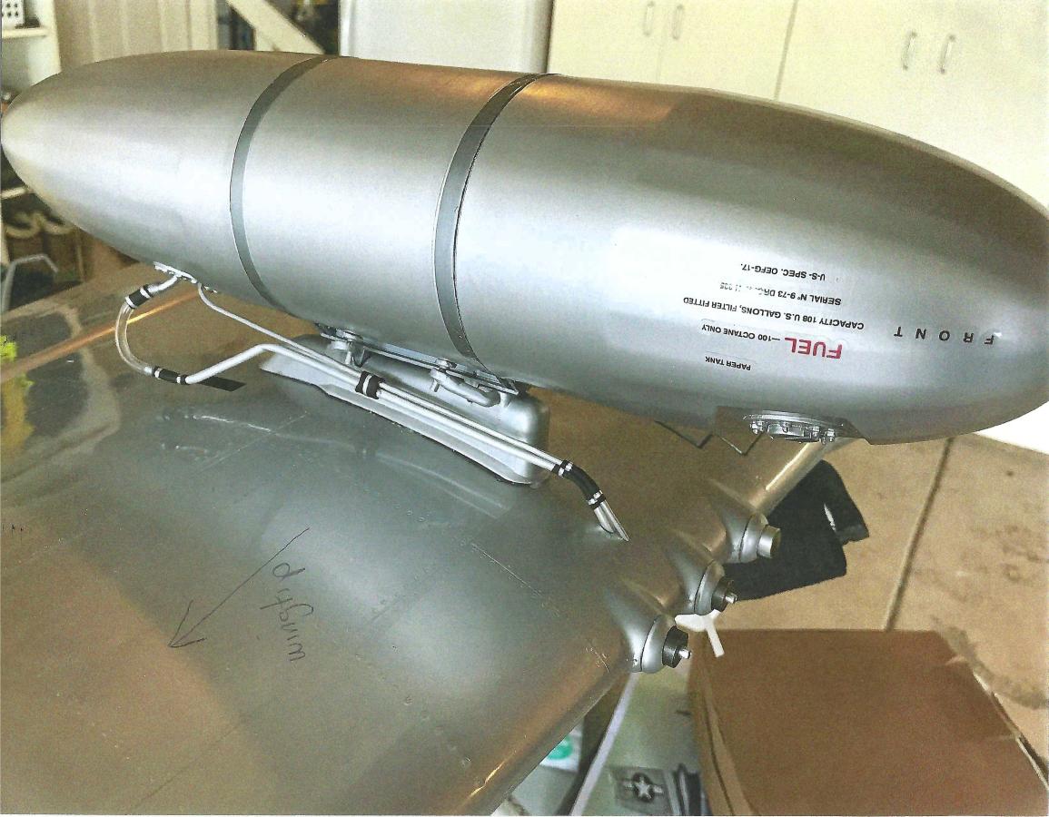

          Below is a photo taken in 2018 while I was building a CARF 1:4.5 scale P-51D for the Mighty Eighth Air Force Museum in Pooler, GA. I was commissioned to build a permanent display of the USAAF Scouting Forces in WWII. These were former bomber pilots who volunteered to fly these special missions after they had completed their combat tours and could have gone home. I had a good friend no longer with us, Lt. Col. Bill Getz, who volunteered after he had flown 31` combat missions as a B-24 pilot. The model plane I built is painted up in his colors, Saucy Shirley, after a girlfriend who promptly dumped him after he left for war!
          I plan on adding this scale piping detailing to my model I flew yesterday. It's all scratchbuilt, as is the printed tank from a friend of mine. One interesting thing if you look at the tubes near the back of the tank is a clear section. That on the real plane was glass (clear vinyl for my model) to ensure that the tank would break cleanly away from the airplane when jettisoned in flight. I thought that was pretty heads-up work for 80+ years ago!
          In memory of Lt. Col. Bill Getz and all the 100 Scouting Forces members in WWII. Bill was the last one standing, and he wanted a permanent reminder of what all the Scouts did in WWII. He passed away a couple years ago at 99 years of age.

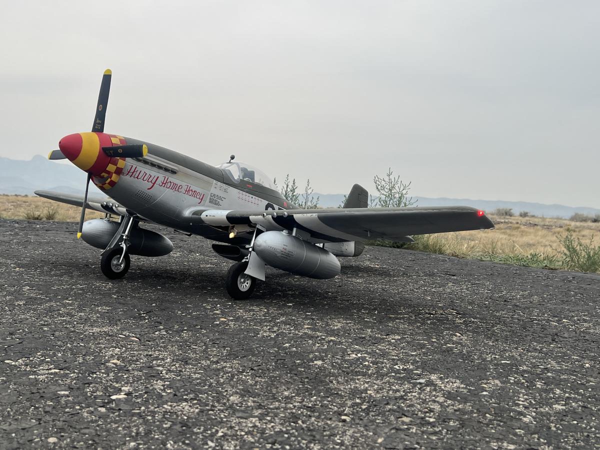

                          Got another test flight in with the big "paper" 110 gallon drop tanks today. Got a late start, and the weather and winds were closing in fast. I decided to try to get another test with the drop tanks on, and made it in, by the wire. Started to rain after I got back down.
                          Regarding the test of the tanks, they did great, and last night I added a rectangular wood piece glued in at the bottom of the tank and extending up to where the rear plunger on the pylon would compress on it when the tank is installed. That worked perfectly this time, with both tanks landing within 3 feet of each other. One tank was undamaged in the fall, and the other broke up some, especially the center tube section which is pretty thin. I think we'll print another center section that is a bit more robust, but not too much heavier than what I have been flying. I think the tank can be repaired and used for more testing. The other one is good to go. That makes 21 flights so far on this new airplane.

                            But... breaking up is scale!

                              Should have filled them with AvGas for the full effect!!

                                Dave,
                                Print those parts (domes) that require infillwith 10-15% Adaptive Cubic Infill in the slicer program.
                                Adds decent structure with minimal weight.
                                If it is a simple cylinder, increase the wall thickness by a .25mm with each succesive reprint until breakage is no longer an issue.

                                  Thanks, Elbee. It’s mostly the middle cylinder that is weak. I saw this just handling it, almost like an egg shell that could crack if you applied minimal pressure with your fingers.
                                  I"ll try your suggestions on a new tank. The conical forward and aft ends are quite a bit stronger than the middle. I"ll start working on strengthening the middle section first.

                                    Hi Elbee: I made the changes on my Prusa menu and the new tank that I printed today feels definitely stronger when I push in on it with my fingers. I have a couple parts I need from MRC first, so within the next couple weeks I should be able to test the V2 model in flight. We'll see what happens. I think if the other one had dropped onto a soft grass field instead of hard packed dirt, rocks, snd sagebrush, I think it might have survived the landing. For whatever reason the other identical drop tank suffered no (zero) damage landing just a few feet away.
                                    Thanks again for the tip.

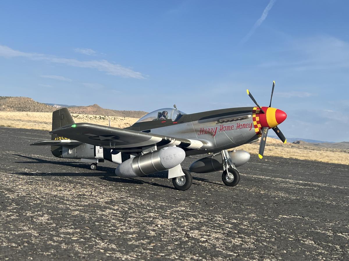

                                          Took up my HHH Flightline P-51D for drop tests using the printed bombs and then another test dropping the printed 110 gallon tanks that Danger Dan designed. First, The P-51 performed beautifully, and I got my 25th and 26th flights on it this morning wth the drop tests.
                                          Bomb drop went much better. I set up lawn sprinkler flourescent pink flags on steel wires in the ground in a line to help me orient myself when I wanted to drop the bombs/tanks. This helps as I do this alone and can't divert my attention for more than a second seeing where the bombs/tanks fell, which was right in the area that I wanted to. I also installed an Estes electronic altimeter inside the fuse to get an idea of how high I was flying. The first drop test with the bombs max altitude was 98' above the ground. Second test with the drop tanks, it was 151' max altitude above the ground. Interesting information, for possible future use, I don't know.
                                          Results: 500# bomb drop worked great, the two bombs landed within 2 feet of each other. No damage.
                                          110 gallon printed tanks flew captive perfectly, released beautifully and dropped to the ground in a realistic manner. Unfortunately, both tanks were damaged when they hit the ground.
                                          A couple thoughts: one, I might have Craft Cloud print up some stronger tanks, even after I had reinforced mine in the printing thickness.The one I had them print for the Hairless Joe P-47D was built like a tank, but still light enough for the airplane to handle ok. Another idea would be to find someone who could make me styrofoam tanks, using my printed tanks as a mold to make them. Don't know who would do that, but I think that would work well and be much lighter. If anyone has any leads on someone who could do this, please let me know.

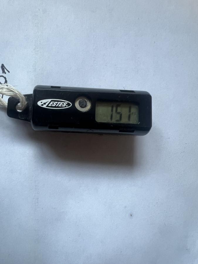

                                          Below is the test Estes electronic altimeter, which worked beautifully. A pic showing the module after the second flight test, 151 feet altitude.
                                          Also, a pic shortly before takeoff for the HHH carrying the printed 110 gallon tanks. A new silver section has been added to the right tank. All three parts of that tank were modified for a bit thicker structure. It didn't hold up this time, but there are several options for future tests.
