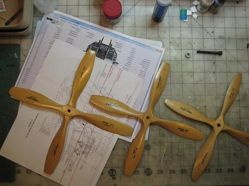

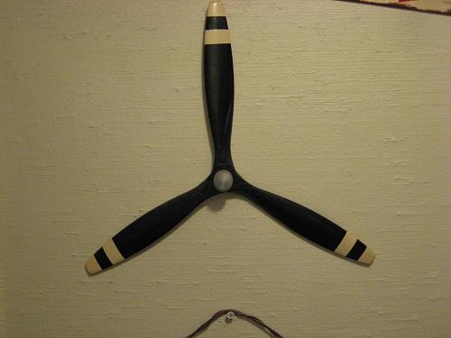

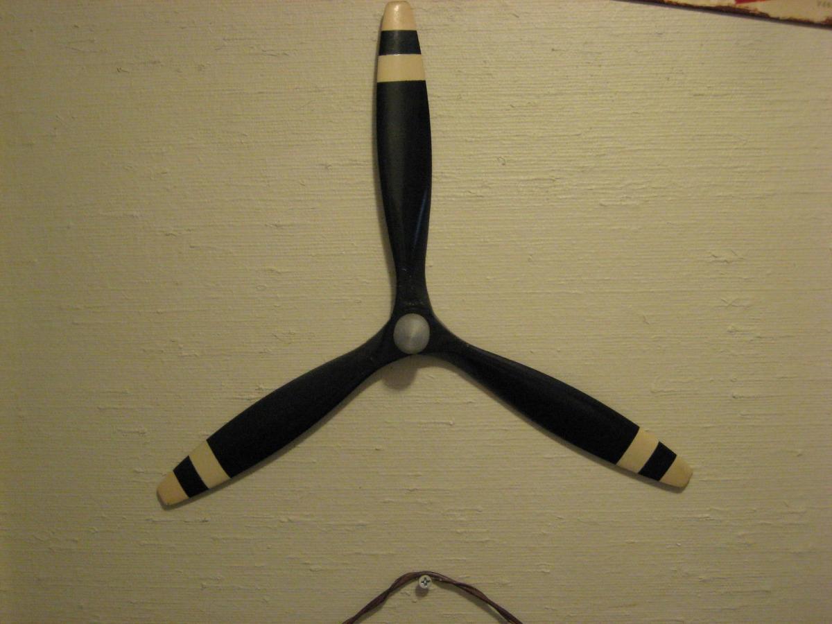

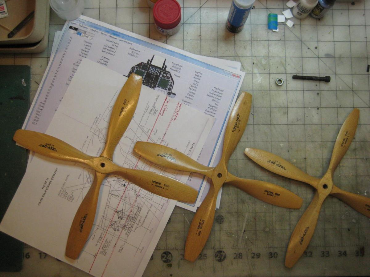

          Makes sense, it would seem reasonable to think one could build props, even scale sized props, given current technologies.
          As stated, we used to build 'em from maple 2-bladed props.
          I still have a 3-bladed and a few 4-blade props I made from those days.
          Best, LB

            • 8766
            #365
            Those home made 4-bladers are spectacular.

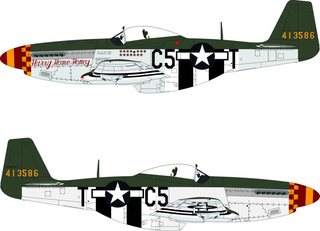

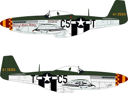

                  I just pulled the trigger on a new P-51D 1600mm model. I like the basic 357th FG paint schemes offered with the kit, but I will be changing it to an early D model without the tail fin fairing. I'll probahly use one from Pete Peterson's Hurry Home Honey aircraft paint schemes.Below is the proposed look of Pete Peterson's airplane, or one of several that he flew in combat. The picture below shows the top four aces of the 357th FG. From left to right, Richard " Pete" Peterson, Leonard "Kit" Carson, Johnny England, and Clarence "Bud" Anderson.
                  Davegee
                  Click image for larger version  Name:	HHH-2-1024x741 (1).jpg Views:	0 Size:	96.6 KB ID:	449201 Click image for larger version  Name:	357th-Ftr-Gp-Top-Acesjpg.jpg Views:	0 Size:	159.4 KB ID:	449200

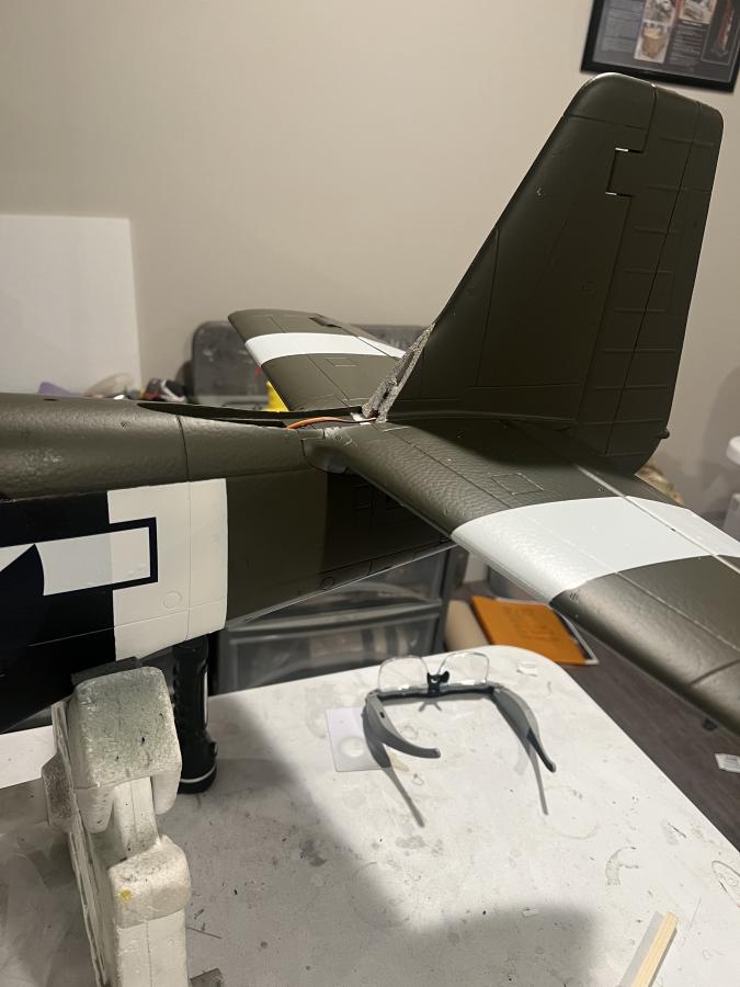

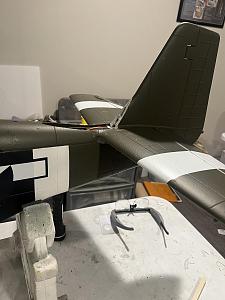

                        My new Fligthline 1600mm P-51D arrived in good shape yesterday. I immediately took everything out of the box, and was fairly impressed. A minor annoyance is the thin waterslide decals of the fuselage where the underlying colors of the invasion stripes show through. I'll have to repaint over those in time, but no big deal, for now.
                        I started working on the tail modification to make it an early D bubbletop before they added the vertical fin fairing or strake. They soon found out, as they did on the P-47, that cutting down the spine of the razorback on both airplanes exposed a new problem with longitudinal control of the aircraft. Kits were sent to airplanes in the field to correct this, and North American changed the production lines to include this fin, which solved the problem.
                        I have modified three different E Flite 1.5m P-51 models to this early D "finless" model for scale likeness to the real thing. There was absolutely no negative impact that I could tell in flying them with my mod. So, I'm going to try doing that with this new Flightline model. I started cutting on the leading edge of the vertical stab yesterday. I'll rebuild the scale looking part with balsa or bass wood. If all works out, it will look great, I think. But if it doesn't, I'm only working on the rudder/fin, and if I screw that up, I'm only out $30 as I get a new part from MRC and do a slightly "newer" version of the airplane with the strake on it as the model comes with it. I sorta look at it as the "free return" trajectory that the early Apollo missions did that would return them safely home to Earth if their plans didn't work out. I'm reasonably sure I can pull off this mod without having to do the "free return" mode and buy a new replacement rudder part. We'll see.
                        Cheers

                          Great News, Davegee. Looking forward to the mods. As well as the Corsair was constructed is the P-51 light years ahead in improvements?
                          My club mate has been flying the heck out of his FMS P-47 so when the winds calm down I will start flying mine. They can't all be hanger queens. LOL
                          Best Regards, Rex

                            Hi Rex: The Flightline Corsair was and is a great rc model. I have had mine since 2019 and it has been great. I flew it 4 times the other day, just a few minor glitches that were easily corrected, like one of the flap sets on one of the wings did not extend for landing, so it flew a bit goofy until I got it on the ground to find out what the cause was. After playing with it a bit and a few more flap cycling on the ground, it worked again. Go figure...
                            The new P-51D I am still learning about but it does have a lot of improvements like the wing extensions and the push button locks, although I have heard a few complaints about them. When I get to that point, I'll see what is going on with them.
                            Flying wise, you've probably read in HS numerous glowing reoports about it being a stable flyer not subject to some wild takeoff and landing rollouts, like what the EFlite 1.5M plane has, for instance.
                            I'll be sure to post any good or bad points that I see as I put this thing together. I have several mods that I plan to do, including the cockpit area, so it will take awhile. But I'm looking forward to eventually flying it, for sure!

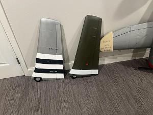

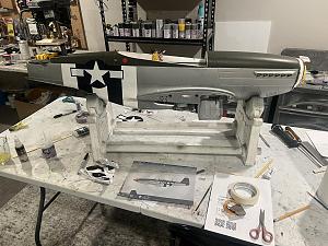

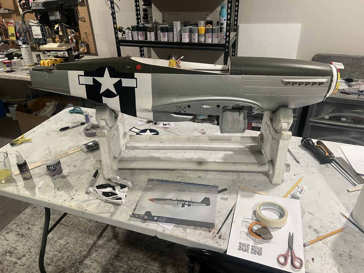

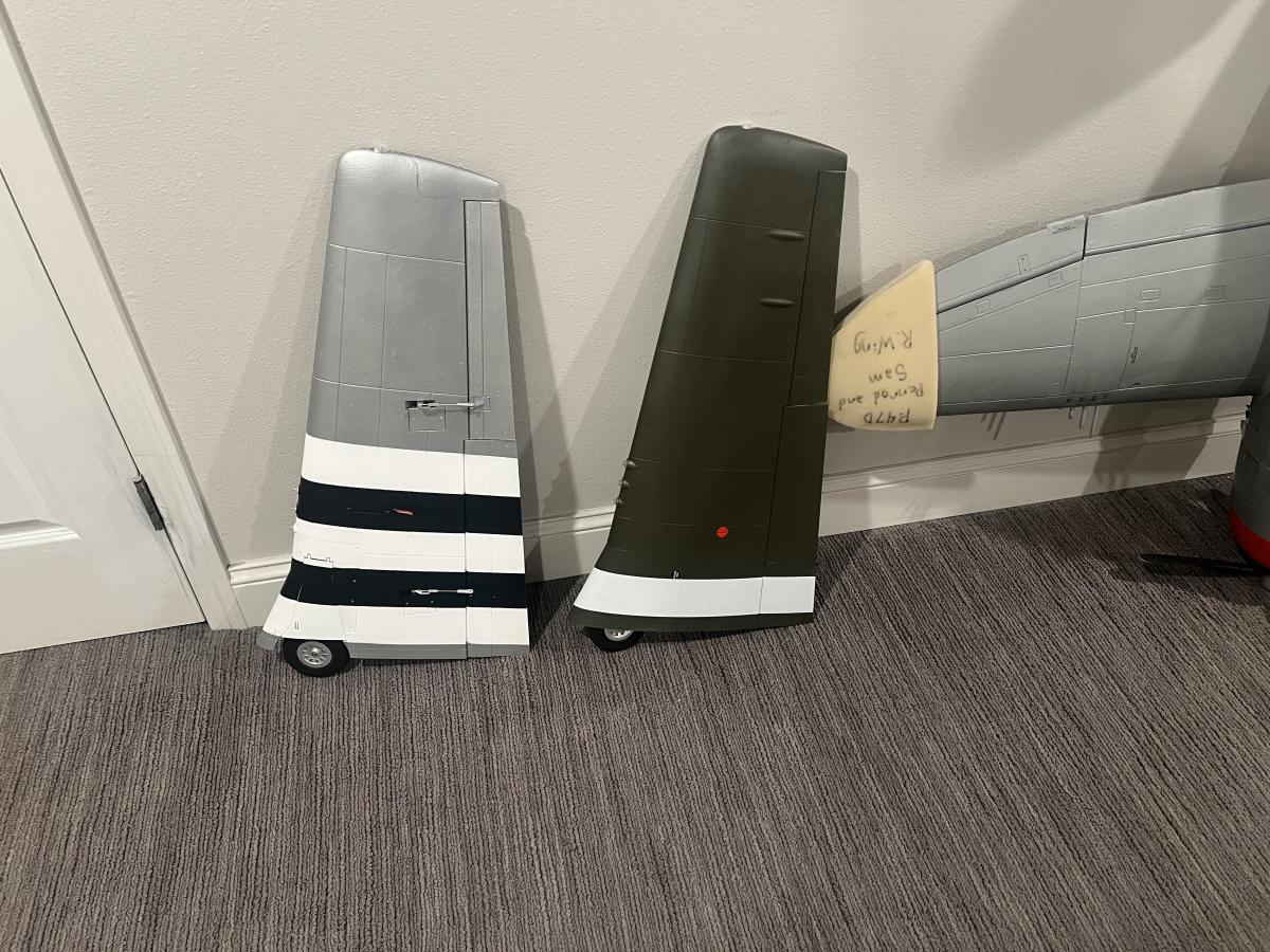

                                    I made some progress on the P-51D makeover during the weekend. Still working on refinishing the vertical stab (minus the foam fairing that was amputated by razor saw) and will be painting it today, probably.
                                    I'll attach a couple of pics of the fuselage and wing redo, spraying silver paint where the grey parts were. This is a version (paint scheme) that was a little later than the scheme MRC has on their Mustangs, with the exception that the first D bubbletop models that came to the unit did not yet have the fairing installed on the vertical fin. These "finless" models were later field modified with kits that came from NA in California when they discovered the controllability problems cutting down the spine on P-51s and P-47s. The aluminum fairing seemed to fix the problem. The P-47 used a smaller, longer fairing that extended from the vertical fin to near where the bubbletop canopy stops when it is fully open.
                                    Cheers
                                    Davegee
