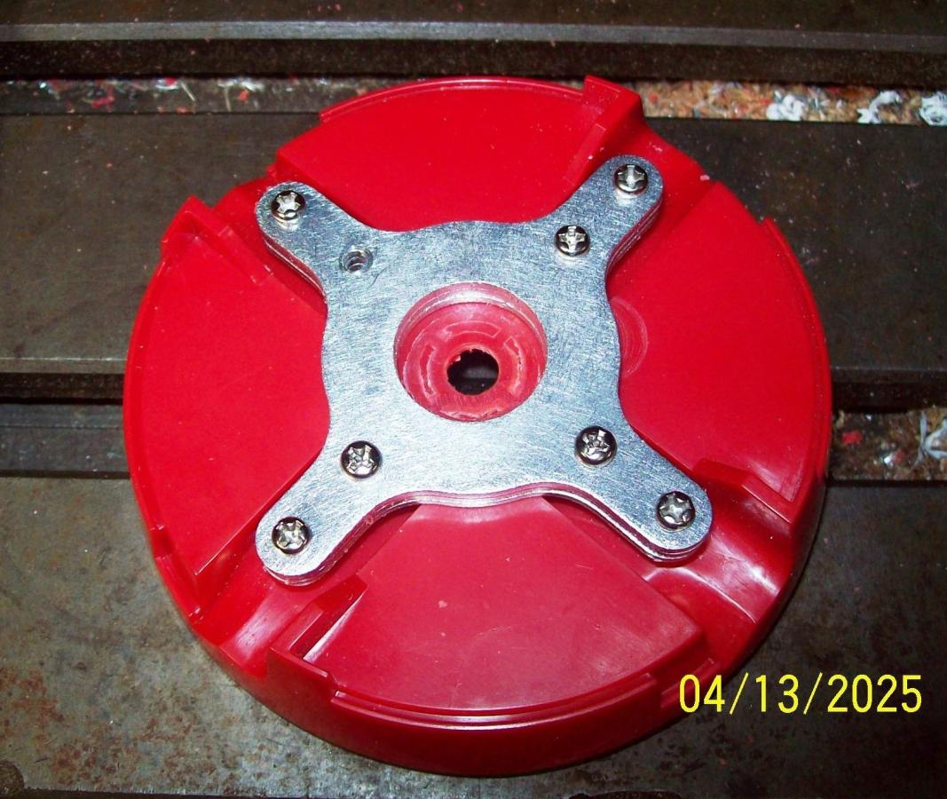

        Scale Diameter Propeller progress:
        After botching the first attempt I finally got a nice spinner backplate. I first machind the knob on the front face, then attached 3 prop retainers so that I could chuck the backplate on my lathe.
        The hole that was originally meant to attach the backplate to the propeller hub was opened to 32 mm dia. so that it fits on my Hacker C50-13XL motor.
