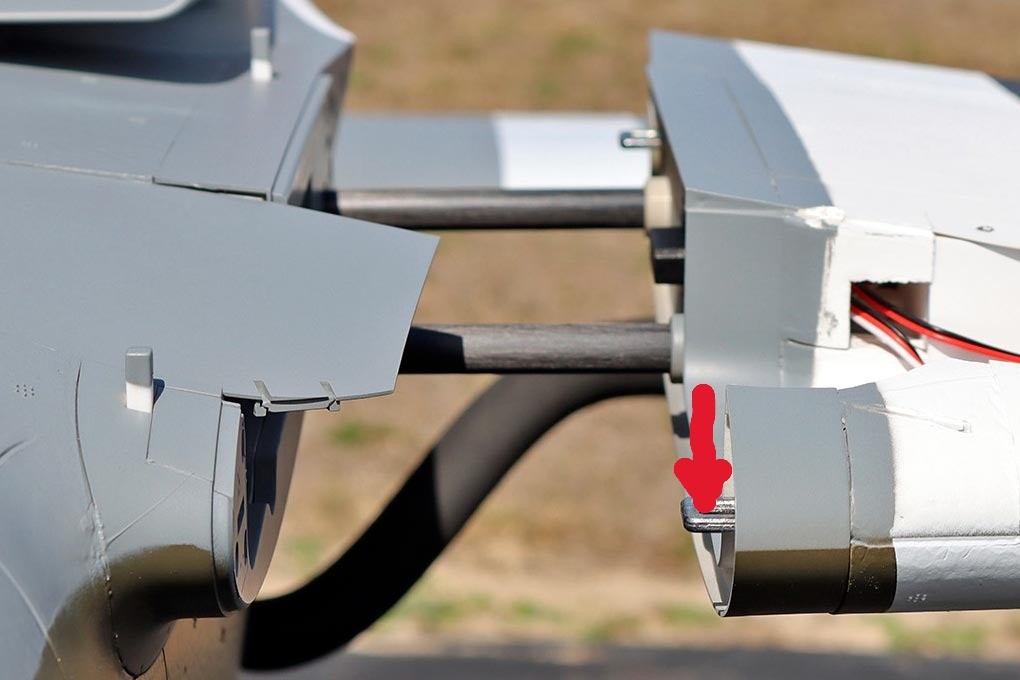

    Originally posted by GEH
    I’m having difficulty with the wing lock buttons, specifically the right side lower button. It will not lock. I removed the wings and worked the button, and it moves freely. One other button is difficult, but it does lock. Any suggestions?
    Mine were tight, as well. Only a couple gave the click lock sound. One of the non clicker ones would not release after pushing it in. I decided to monitor and not mess around and possibly damage it. It’s staying in, so far.
    That’s my experience. If they are in, they appear to be secure. But check often.
    -GG
    • GEH
      • Oct 2022
      • 5
      #242
      -GG
      Glider, thanks. The one button won't go in at all.
      • GliderGuy
        • 1408
        #243
        With full scale sailplanes, inserting wing spar pins is sometimes a fraction of a mm tolerance thing. Letting the glider warm up or chill down can help.
        Set your bird outside and let the parts cool down for an hour. Then try again.
        if that fails, next try some silicon lube. If that fails, a gentle hammer tap while pushing hard together.
        Last, you may need to trim gently some material.
        -GG
          • 8205
          #244
          Mine also were difficult to lock/unlock. I found if I pushed the wing in as tight as I could, the lock would function better. You can't have even the slightest slop when trying to lock/unlock the wings.
            • 8750
            #245
            GG mentioned about "tolerances". This is also applicable to model planes, in particular, these wing locking mechanisms. I have several planes with these locks and some do, in fact, start off being very tight or seemingly impossible to operate.
            Examine the lock mechanism and see how it works. Look inside the hole (on the fuse side) where you can see (use a flashlight) what happens and what moves when you work the pin down and up. Now cross reference that to the metal bolt where the hole is. You should be able to see (or visualize) that the moving part of the "pin" goes into the hole in the bolt. It's not hard to conclude that the bolt doesn't quite fit into the hole. It "catches". That is to say, the pin is NOT totally centered in the hole of the metal bolt. Most likely because the wing is NOT pushed in far enough. You may need a 2nd person to help here. Have one person push that part of the wing root firmly into the fuse while the other person tries to activate the pin. Does it go? Or just goes? This should tell you that the pin is "catching" on the outer part of the metal hole. Generally, after several activations, enough is worn off the pin itself (or the metal hole) that it should get easier and easier to function.
            If this does not happen, you have an option................. grind away a very minute part of outer side of the hole. (It's not possible to grind the inner suface of the pin mechanism because it's hidden away from you.)
            You just have to be a bit analytical. It's not rocket science.

              I'm going to say this quietly as there could be negative unintended consequences.
              Mine were almost impossible to latch and have gotten no better after many flights. I really have to push the wings towards the fuselage and to the point I was worried about damage. It was worse on the port wing. The Starboard wasn't nearly as bad. I took the small metal tabs off the port wing, two screws hold each one on. I cut a piece of paper 0.1mm thick and put these behind the metal tabs and put the tabs back on. Wa la, perfection. I still need to push the wing firmly against the fuselage but the latches are easy to latch and unlatch.
                  I can't see anything negative coming out of that. It's a solution that resolves this problem when they simply will not lock easily, ever. This just shows that the production and assembly of certain bits of this (and other) planes is NOT uniform or consistent. This is a better solution than to grind the hole bigger on the outer side.
                                Evan, brillant solution. I used 0.12mm thick paper for all four button locks. No longer fighting the push buttons, they work perfectly. Thank you for posting. Glyn
