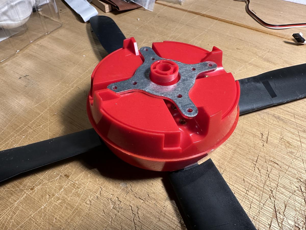

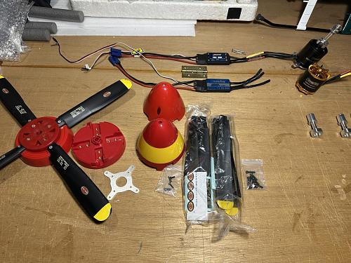

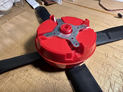

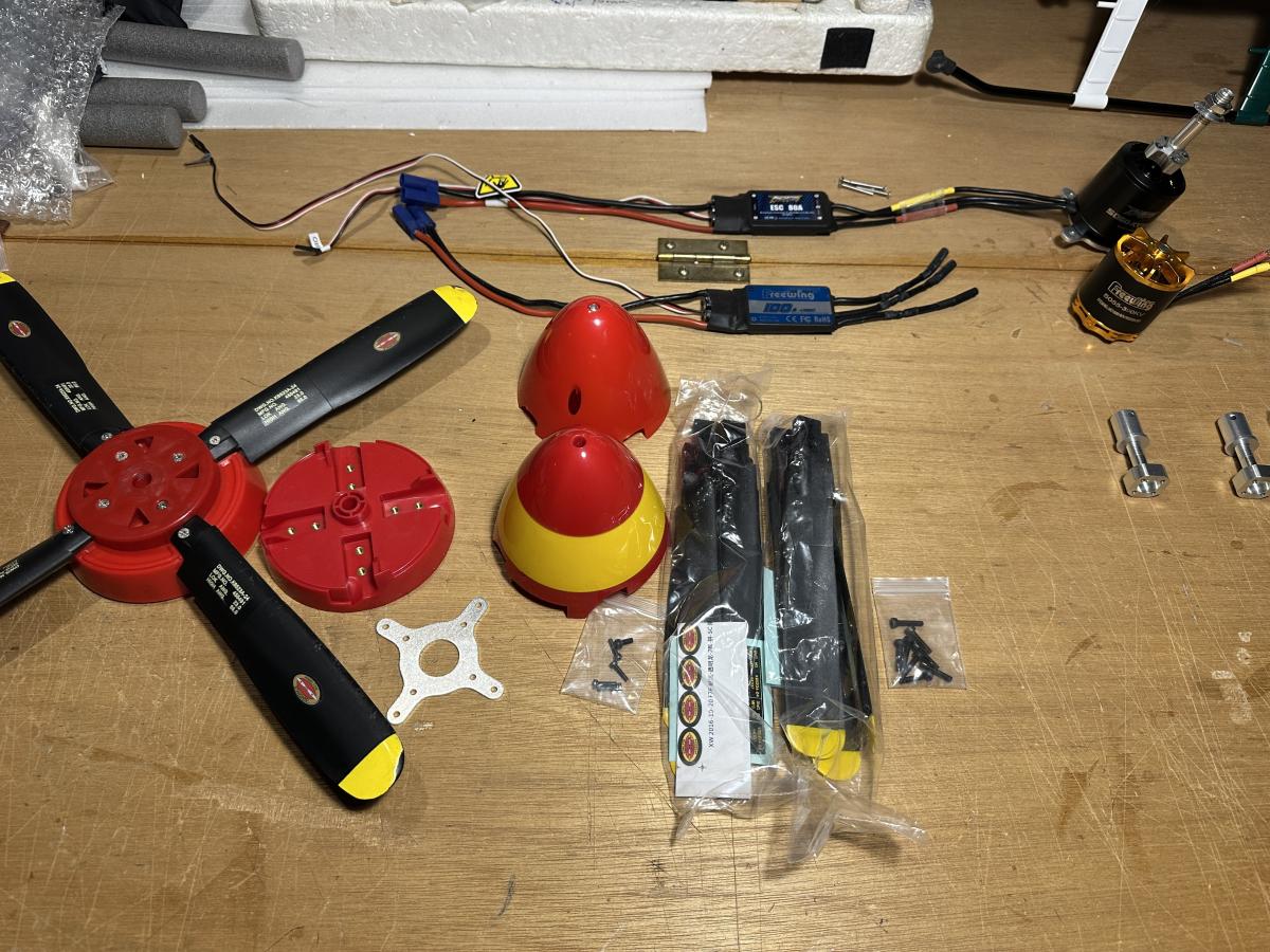

                                    Got the parts today. The 2 prop adapters are IDENTICAL, so I could have gotten away with just ordering the 1600mm Spitfire motor. I guess I'll have a spare prop adapter.
                                    Continuation of my journey to make an FMS 1700mm/FL 1600 P-51 Mustang hybrid (from post #106) ....................
                                    Here is a couple of pics of all the old parts from the FMS and all the new parts from the F/L P-51. The difference in length of the motor/prop adapter is 4mm (the X mount is 1mm thicker on the F/L), so I'll need to bring the F/L motor forward 4mm. As you can see, the diameters of the 2 prop base plates is minimal, the F/L one being a couple mm smaller, so barely noticeable. The biggest problem I see is in the X mount plate. The outer hole distance across the motor center is quite a bit smaller on the F/L. I'll have to figure out how to make new holes in the face of the FMS motor mount. I may use a 4mm thick ply plate and attach it to the motor mount. That'll also take care of the need for standoffs. (I do love a challenge.)
                                    New data ...................... The F/L motor and X mount needs to be brought forward by 15mm. The FMS prop adapter sits on TOP of the fat part that screws into the motor. Only the small hex part goes inside the base plate. The F/L prop adapter completely fits INSIDE the prop base plate. I will use both X mounts and a 1/2" ply spacer to achieve the required motor placement. The outer holes in the F/L X mount will need to be reamed out slightly so the 2 X mounts can be stacked together.
                                    Click image for larger version Name:	IMG_5732.jpg Views:	30 Size:	193.2 KB ID:	446480 Click image for larger version Name:	IMG_5735.jpg Views:	27 Size:	185.1 KB ID:	446481
                                    Got a chance to fly the hybrid P-51 this moring.
                                    The FMS 1700 with the F/L powertrain doesn't look any different than stock except for the nose cone. It even sounds exactly the same. Flight-wise, the climb performance and vertical are much improved. Loops are very easy and without having to dive it first to make sure it gets up and over the top. However, ultimate top speed has only marginally improved, perhaps be a few mph more. So, not a significant, eye popping difference. Nevertheless, the improved "pull" gives a better low end feeling of security. Was it worth it? 50:50. If I didn't already have the 1700 Red Tail, I would have just bought the new Flightline. Anyway, it's a keeper.
