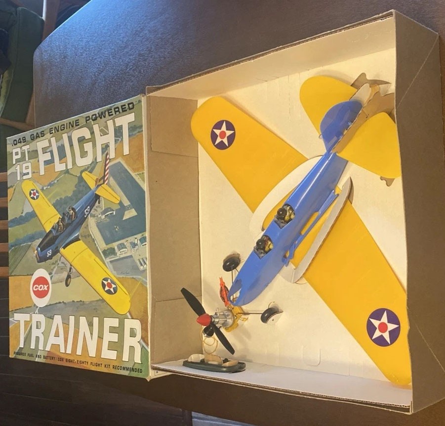

    Even down under my brother and I had numerous cox 049 control line plastic models. Mostly crashed of course was fun
      • 4873
      #162
      Seems I must have always run mine too lean, flame outs were the norm.
      Most frustrating time of my aviation career.
      The other part was plastic cement would not fully repair the broken bits, so mine all ended up as shelf models that dripped spent fuel.
      In the end most were blown up with fireworks at some point in my misspent youth.
      The PT-19 below is from the early 80's; asking price from eBay is $425.
      If memory serves, I also had the Cox Thimble Drome P-40 but all that CL rage was in the late '60's or early '70's for me.
      I discovered 'girls' about that same time and my lifes' priorities became noticeably skewed from that point onward.
      Best, LB

        Oh wow, Elbee, me and my cousin had the PT 19 and I had the Cox Spitfire too, which my dad tried to fly and, well lets just say it didn't go well. I flew the PT 19 under power a couple of times until one string detached and it became garbage fodder.
        Little did I know that 40+ years later I'd have what I have now, I remember dreaming about owning a 'Galloping Ghost' radio system!! And enviously watching the guys at the local club with their Kraft radios.

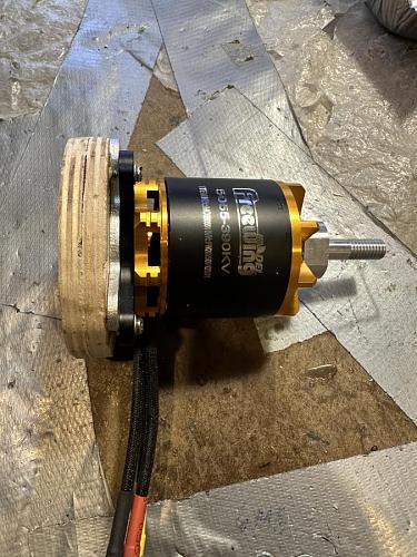

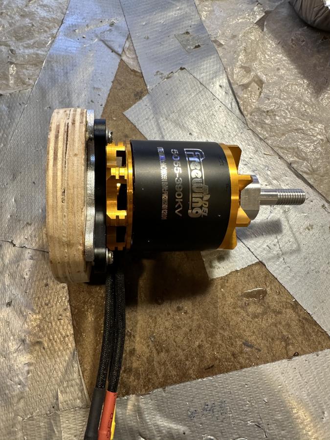

              Continuation of my journey to make an FMS 1700mm/FL 1600 P-51 Mustang hybrid (from post #106) ....................
              Here is a couple of pics of all the old parts from the FMS and all the new parts from the F/L P-51. The difference in length of the motor/prop adapter is 4mm (the X mount is 1mm thicker on the F/L), so I'll need to bring the F/L motor forward 4mm. As you can see, the diameters of the 2 prop base plates is minimal, the F/L one being a couple mm smaller, so barely noticeable. The biggest problem I see is in the X mount plate. The outer hole distance across the motor center is quite a bit smaller on the F/L. I'll have to figure out how to make new holes in the face of the FMS motor mount. I may use a 4mm thick ply plate and attach it to the motor mount. That'll also take care of the need for standoffs. (I do love a challenge.)
              New data ...................... The F/L motor and X mount needs to be brought forward by 15mm. The FMS prop adapter sits on TOP of the fat part that screws into the motor. Only the small hex part goes inside the base plate. The F/L prop adapter completely fits INSIDE the prop base plate. I will use both X mounts and a 1/2" ply spacer to achieve the required motor placement. The outer holes in the F/L X mount will need to be reamed out slightly so the 2 X mounts can be stacked together.

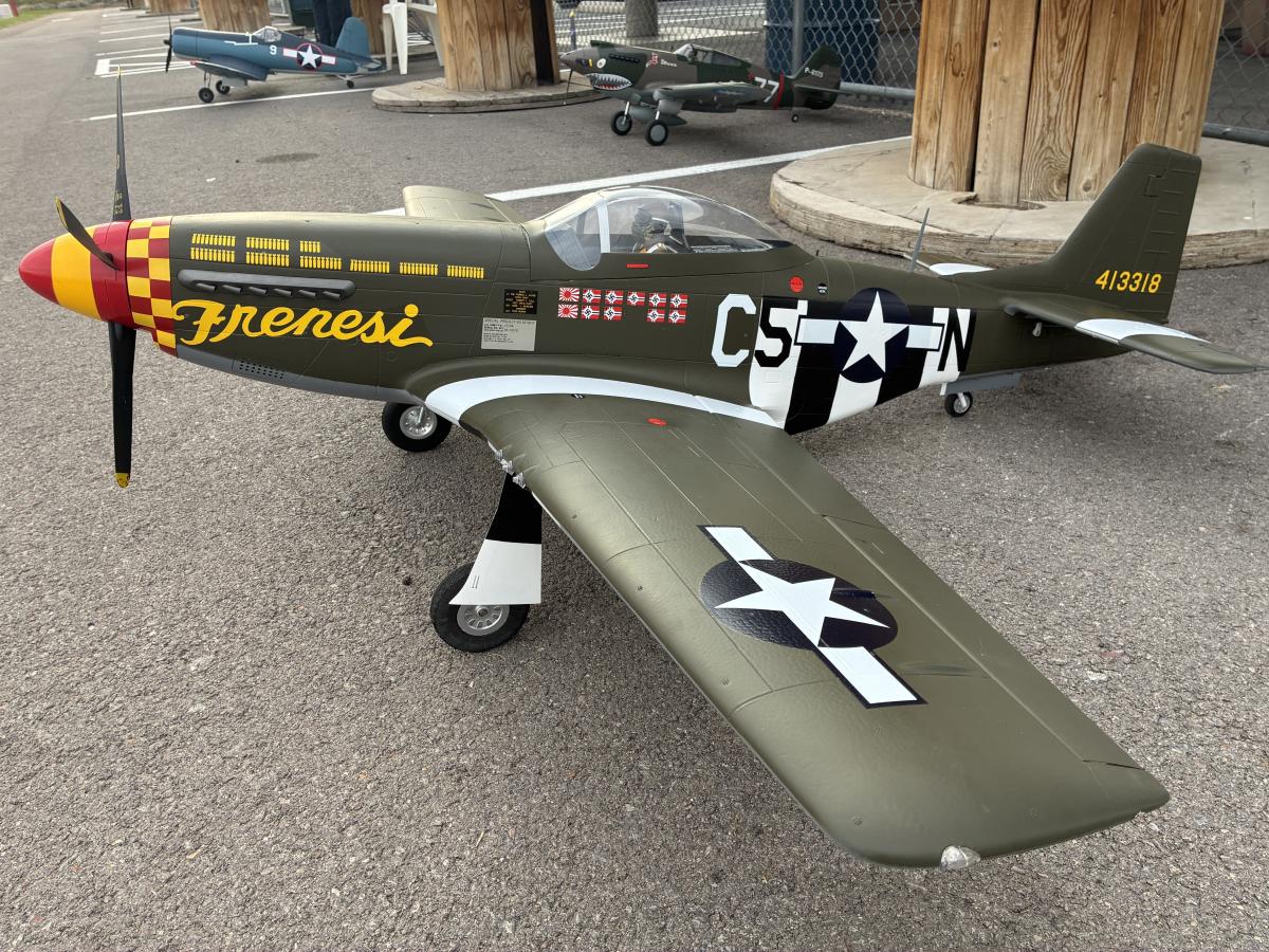

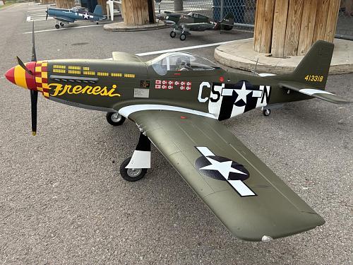

ID:	446534 Another amazing day at the field and another dozen fights on Frenesi! I had Callie Graphics do me up some kill marks to complete the look!
                              I can’t say enough about the way this thing flies. It just keeps getting better and better!

                                Glazier808,
                                She is a beautiful thing.
                                Glad to see the corrected markings, too
                                Best, LB

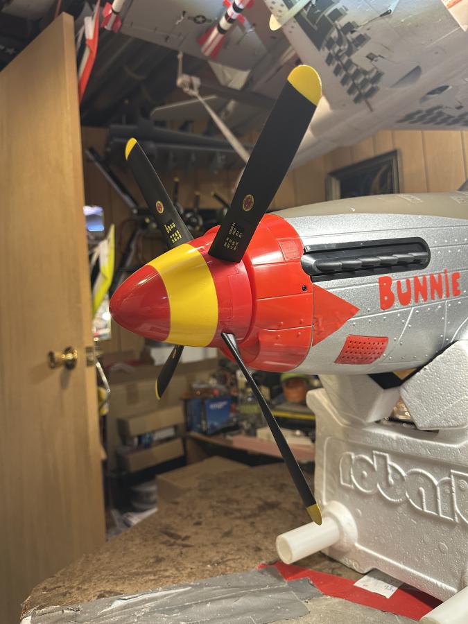

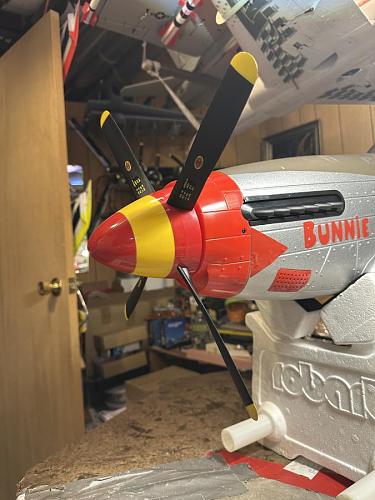

                                      Finished the transplant. Need to wait for snow to go away before test flying.
                                      Had to make a 1/2” biscuit and use both X-mounts to achieve the proper gap between the cowl and prop base plate.

                                        • 4873
                                        #179
                                        xviper,
                                        Very nicely done, Sir.
                                        Best, LB
