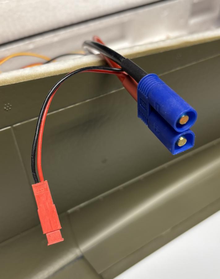

                                  Mine arrived in perfect shape. HOWEVER….the UBEC is nowhere to be found.
                                  Disregard…see next post.
                                  See photo as to my confusion…no UBEC was attached where I am used to finding it…just this open ended connector.
                                  Click image for larger version  Name:	IMG_0377.jpg Views:	0 Size:	41.2 KB ID:	445612
                                  -GG
                                    • 5399
                                    #77
                                    Umm all the newer FreeWing come with that power tap. For afterburner on jets. The ESC has a internal BEC.
                                    • GliderGuy
                                      • 1409
                                      #78
                                      Umm all the newer FreeWing come with that power tap. For afterburner on jets. The ESC has an internal BEC.
                                      Ok…now I know! Thanks…
                                      Yep…works fine just as it came. Power to RX is supplied via the throttle connection from the ESC to the RX.
                                      WORD OF CAUTION. Very early in the instructions the prop assembly is screwed together and attached to the motor shaft. WAIT WAIT WAIT to attach the prop until you bind the RX and calibrate the ESC and get the motor running correctly.
