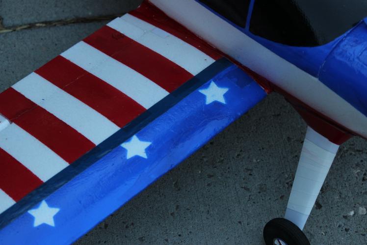

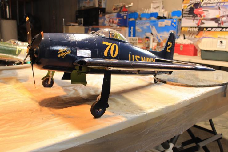

          Hey guys, been reading all this info on RCGroups about this cool plane. Just wondering if anybody has had any luck with the black color. I want to do one in the gloss black as in Big Boss Man and I understand there has been some success using the Minwax clear spray, 3 coats, over the blue with no gatoring but just wondering about the black. I'm all ears!! Brad
            • 7340
            #705
            Hey Downwindleg,
            A lot of us started out using Minwax, but found Varathane Spar Urethane to be a superior product. It's water based, made for the outdoors and has a UV protectant in it. If you are going black on your bird, remember to keep it in the shade and real hot days may still be a problem as with all dark colors. I keep my Bearcat in the shade until I'm ready to fly her just to avoid the sun damage.

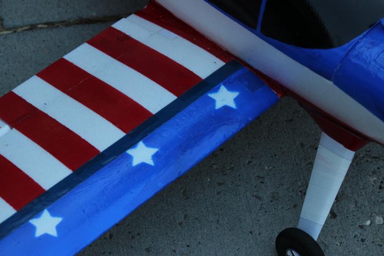

                              Hey Grossman 56, Thanks very much for the info on the varathane. I'm wondering if they make a rattlecan version and would love to see some examples of the finished product.
                              Thanks Again, Brad
                                • 7340
                                #715
                                I'm not sure on the rattle can situation, I apply mine by brush, so....
                                But here are some examples, before and after on the Bearcat, My Little Gal I and after repairs on the Pandora.

                                  • 7340
                                  #716
                                  Here' some links to the product.
                                  • Sky Wolf
                                    Flying Ant

                                    #717

                                    Wow...what an awesomely noticeable difference using the Varathane on that Bearcat. I'll have to try this on my Tiger cat whenever I decide to assemble it.

                                      #718
                                      Hey Grossman56,what he said. The Varathane finish makes all the difference in the world!! If what I've read in RCGroups is true, this finish should also make a big difference in the gatoring effect. Hope so but it's going to have to wait 'til I get the A-10 bought and payed for. I'm guessing you know how that goes, Thanks Much, Brad

                                        #719
                                        Hey Grossman, I noticed on the Bearcat that the wheel fairings are also darker. Did you use the Varathane on those as well?
                                          • 7340
                                          #720
                                          Yep, All the blue got painted. I also painted the struts with Model Mater Chrome and painted the wheel hubs in Sea Blue. Used some left over Flite Metal in the exhaust ports as well.
