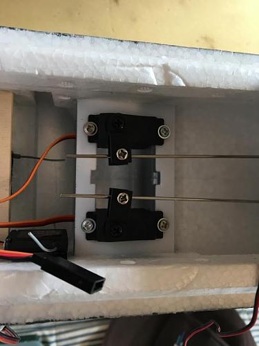

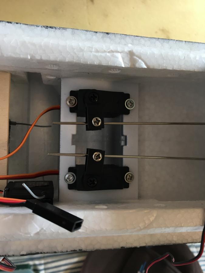

                          I'm not sure I'm understanding your question Tony, but if you set in a 2mm up elevator to your "neutral" position (setting the rods inside the fuse), and use the outermost hole on the elevator control horn, you should have no problem achieving the 27mm low rate of travel, or the 33mm high rate. If you do, have you checked your travel adjustment settings? Those should be set before you go to dual rates. I set the travel adjust to achieve the high rate of travel, and then in dual rates I have high rate as 100% and adjust the low rate to whatever travel I want. I hope this helps! Rob Click image for larger version
