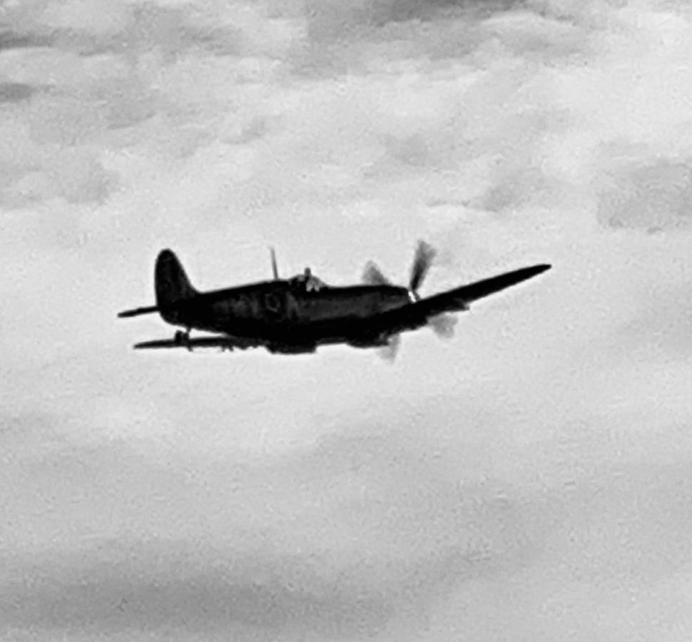

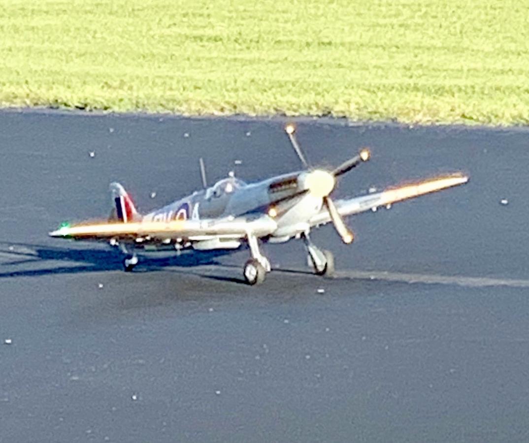

                Flew the Spitfire for the first time yesterday. What a great flying airplane. No issues and looks great in the air. Ground handling is very predictable, and landings are no problem. The flaps are very effective. Great job on this one Flightline.

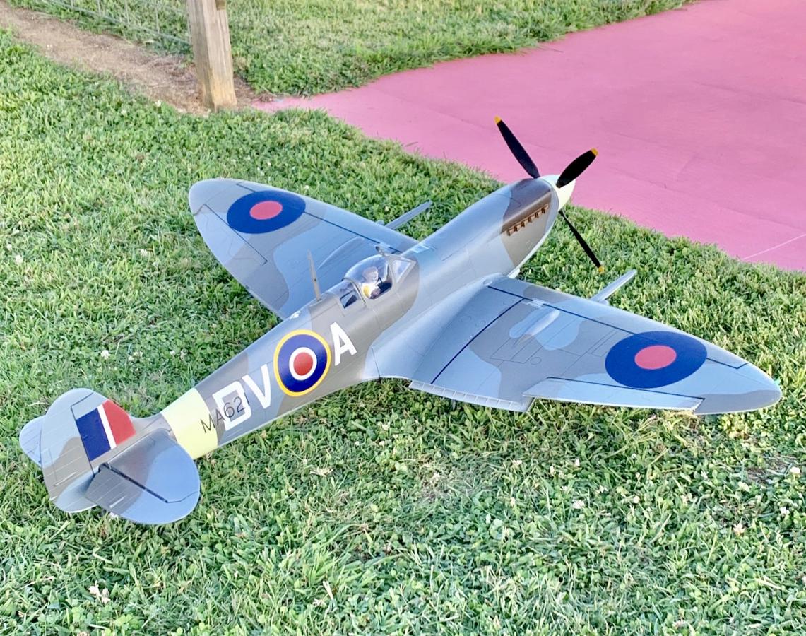

                        Thanks guys! I put two more flights on the Spitfire yesterday and really got it dialed in. I keep increasing the flight time, last flight was 8 minutes and still landed with battery left on the 6s 5000mah. Very impressed with the Spitfire!
