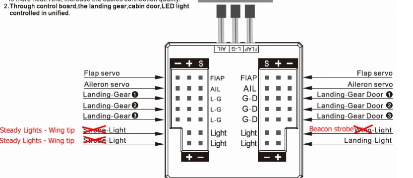

                              I just got my spit, very dissappointed with it.... Damaged horizontal stab, Roundals in decal sheet misprinted they look like slanty eyes.. and retracts dont work.
                              yes I tested blue box with spare retract from old eflight spit so I know it works tries all three positions and found out there is different delay in each
                              removed retract from wing in case it was just binding. no movement what so ever. tested both retracts in this manner. Not sure if lights work properly last I tried one wing light lit as expected the other was in strobe mode, and the led light on top wasn't on at all. Not going to proceed any further untill Motion RC decide what they want to do with it.

                                Have you opened a ticket?
                                  yes I am awaiting response from Tech Support. I guess they were off for a long weekend and I don't blame them for that

                                    Does anybody sell replacement LED for the Spit, or is the only way to purchase new wings...seems a bit extreme...
                                      TT, Check the MotionRC site for wired LEDs first; however, the LEDs can also be purchased online in packs of 10 units for about $5USD. Search: 2.2-5 watts High Power SMD LED COB Chip Lights (White Red Blue Green RGB UV) Lamp. Check the voltages and watt limits as differing colors have differing requirements. I burnt out 2 red LEDs building my Spitfire by hooking those directly to a battery pack instead of through the little Blue Box. Very bright and pretty for about a nano-second. LOL Best, LB
                                        I purchased my Spitfire as a scratch and dent kit. The Red LED was not working. Easy fix by removing the plastic lens cover cut the glue holding the LED to the wing. De-solder the LED and solder the new part or tie a kit string to the wire then pull it out of the wing. Use the string to pull the new wire back into the wing and glue the LED and Lens back into place.
                                        Only power up the LED using the Blue Box light port or you will burn it out. The red LED is only rated for about 2.2v
                                        I purchased these from MRC which gives you many options:
                                          Hey Tony:
                                          The three different retract inputs are for gear doors and landing gear, I had mine wired so that the one side retracted before the other, more for a scale look, but decided to go back to the 'proper' way of inputting the gear. As for the lights, the manual is wrong! Here's the correct way for the light to be wired...
                                          Click image for larger version  Name:	Capture2.PNG Views:	0 Size:	158.9 KB ID:	205185
                                          Also, I tried working my landing gear using a servo tester. No go, there isn't enough power in a servo tester to retract both gears. I had the boys on the line they suggested to bind the plane, plug in the battery and try it that way. Worked like a charm!
