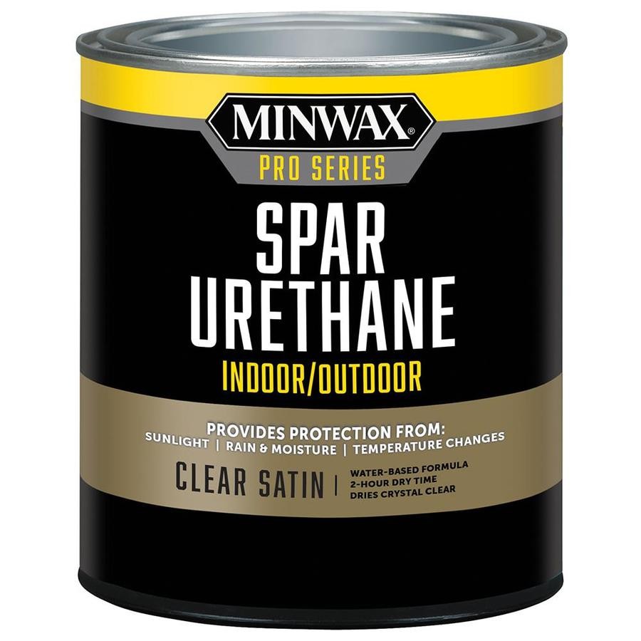

    Very nice, did you coat it with a polycrylic or urethane, and if so did you use satin/semi-gloss or gloss?:spitfire
    Thanks Hugh. I have coated the model with gloss Cabot's Cabothane clear water based polyurethane. This product is readily available here in NZ and Australia. This is to give a good surface for the decals to stick to and to prevent the silvering that others have experienced when putting them onto the as delivered paint. I am using the Callie decals by the way. Once I have finished the decals I plan on coating again with Matt or a mixture of Matt and Gloss (to give satin). This will also seal the edges of the decals.
      • 7359
      #2302
      Hi guys, RodgerC, it looks like the same result I get with Minwax Pro Spar Urethane, here's a picture of the can the one I have says Gloss but it looks the same.
