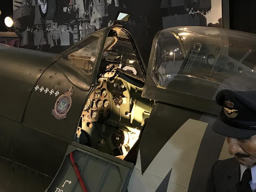

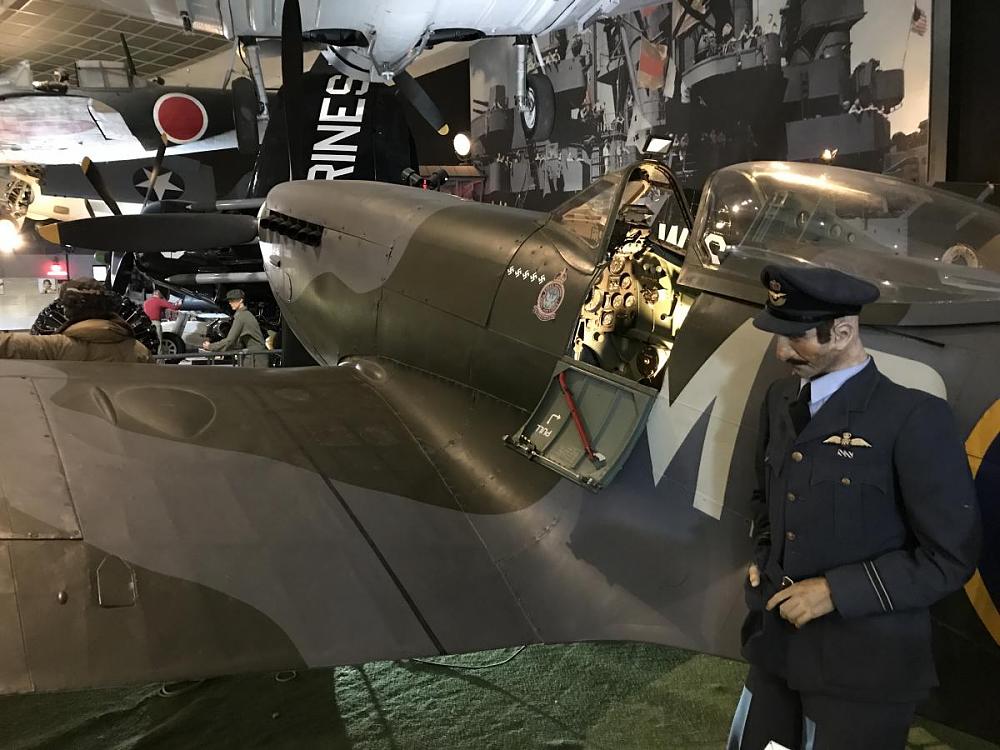

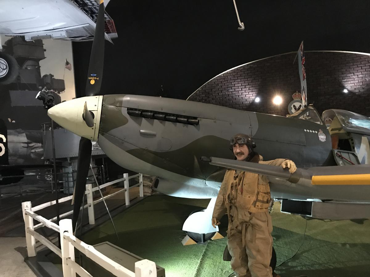

                    I found some scale detail photos that I took a couple of years ago at the San Diego air museum.

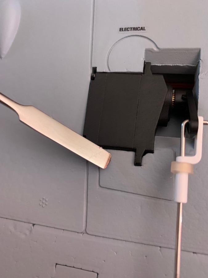

                      #2290
                      Just plugged in my servos for the first time and noticed the LH aileron servo falters at a specific position along it's travel. If you hold the stick at this position the servo vibrates/jitters. Has anyone experienced this? I have asked RC Castle (where I ordered the model) for a replacement servo as I don't think it's worth taking the risk.
                      How hard is it to remove this servo??

                        #2291
                        that is a pot (potentiometer) problem. should not happen with a new servo. I replaced the elevator servo in my spit because it was not holding center. the flap servos are scheduled for replacement because they "turn off" and the wind resistance pushes them back to clean position.

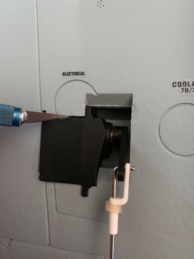

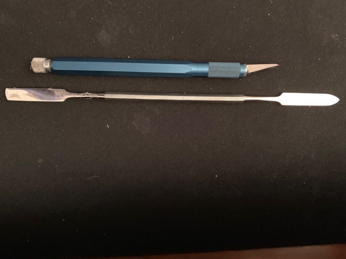

                                    Hi
                                    I did not see anyone answer you. Yes, replace this bad servo with a new one.
                                    The servo is lightly glued into the pocket with silicone (stated by MRC support). Use a hobby knife to carefully relieve the bond to the servo. I have a spudger tool (iFixit) to help clean the glue away from the sides and then pry it up. Use your stainless wire tool to the end of the servo wire connector. then pull the servo out of the slot while the wire tool is connected. Connect your new servo wire to the tool and then pull it back through the wing.
                                    Hope this helps you.... it is pretty easy and just take your time.
                                    Rich

                                      #2298

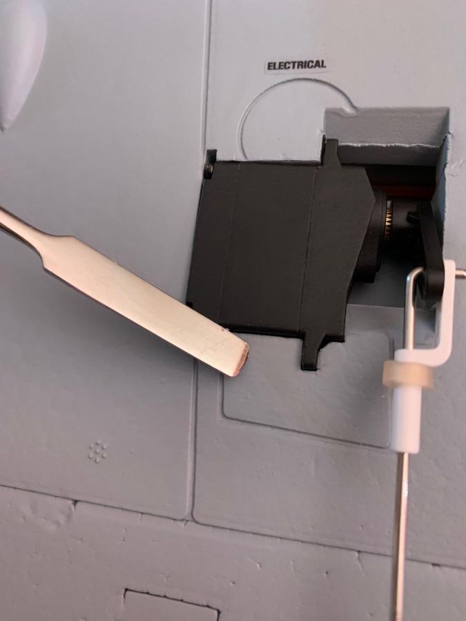

                                      full view of tools

                                        #2299
                                        Originally posted by RichJ53
                                        Hi

                                        Thanks RickJ. I managed to remove the servos out OK just like you described. I have now replaced both Aileron servos with HiTec HS5085MG's that fit perfectly. To hold them in I wrapped the servo case with blue masking tape and then glued in with hot glue. Seems very secure.
