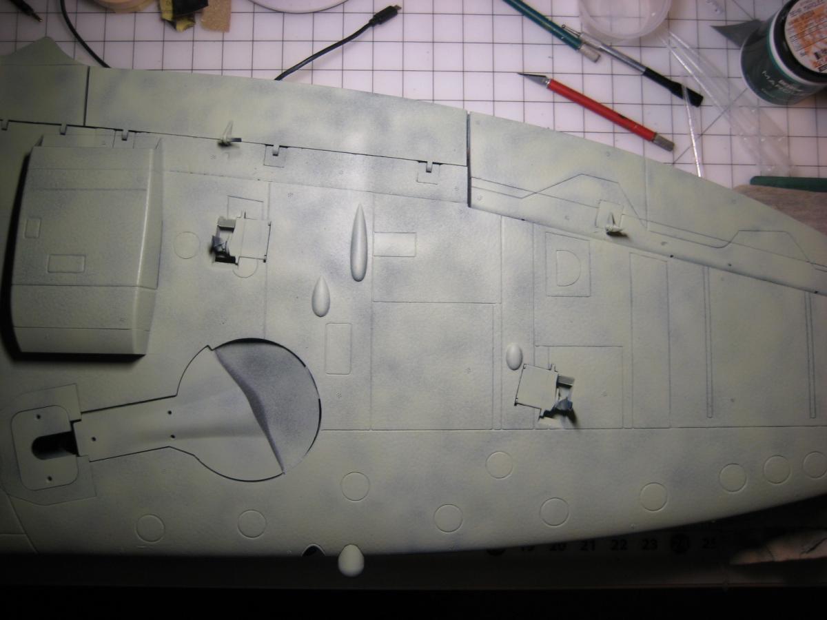

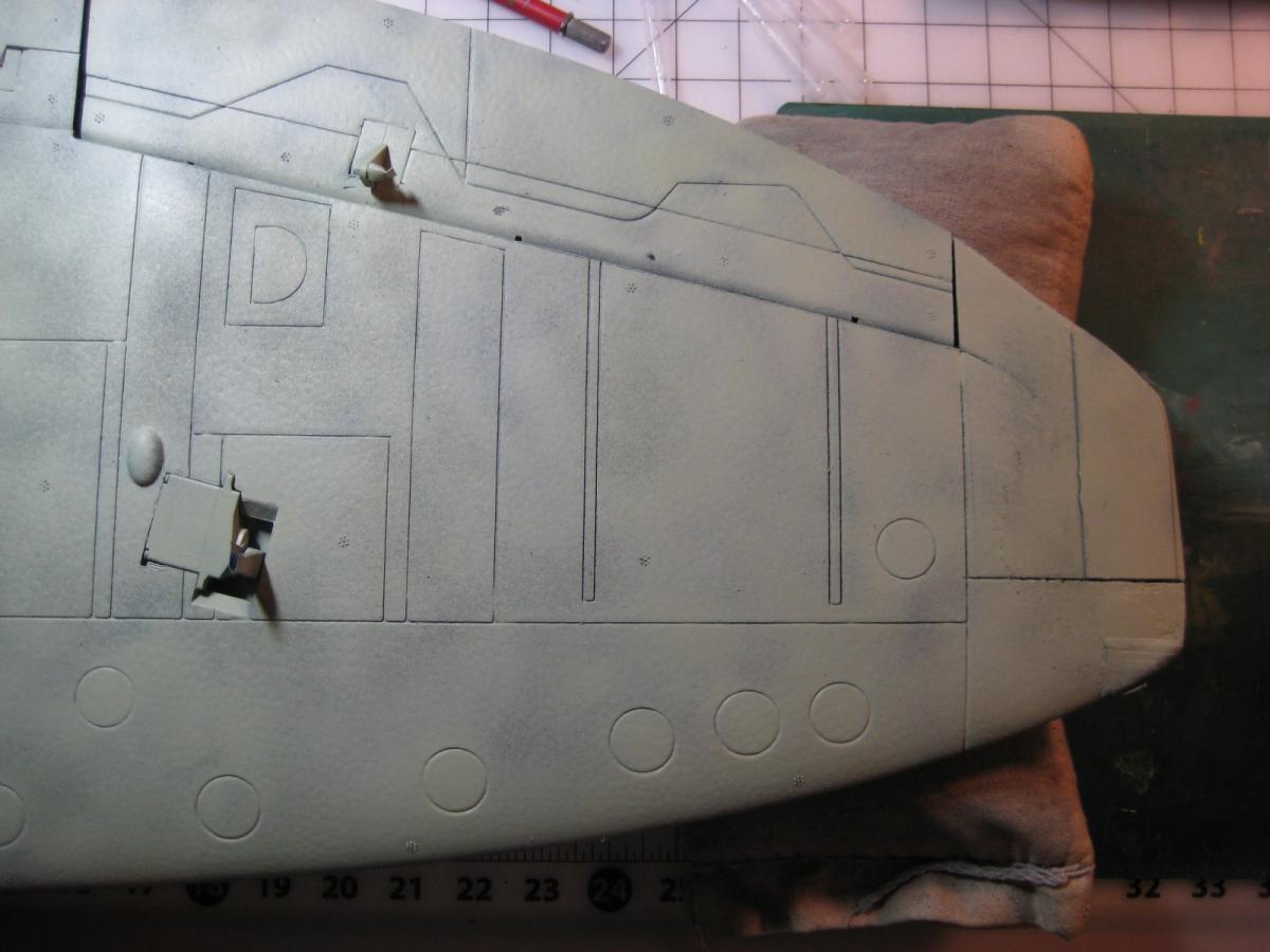

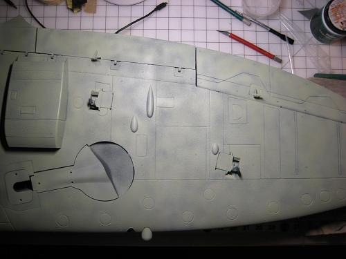

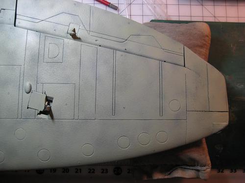

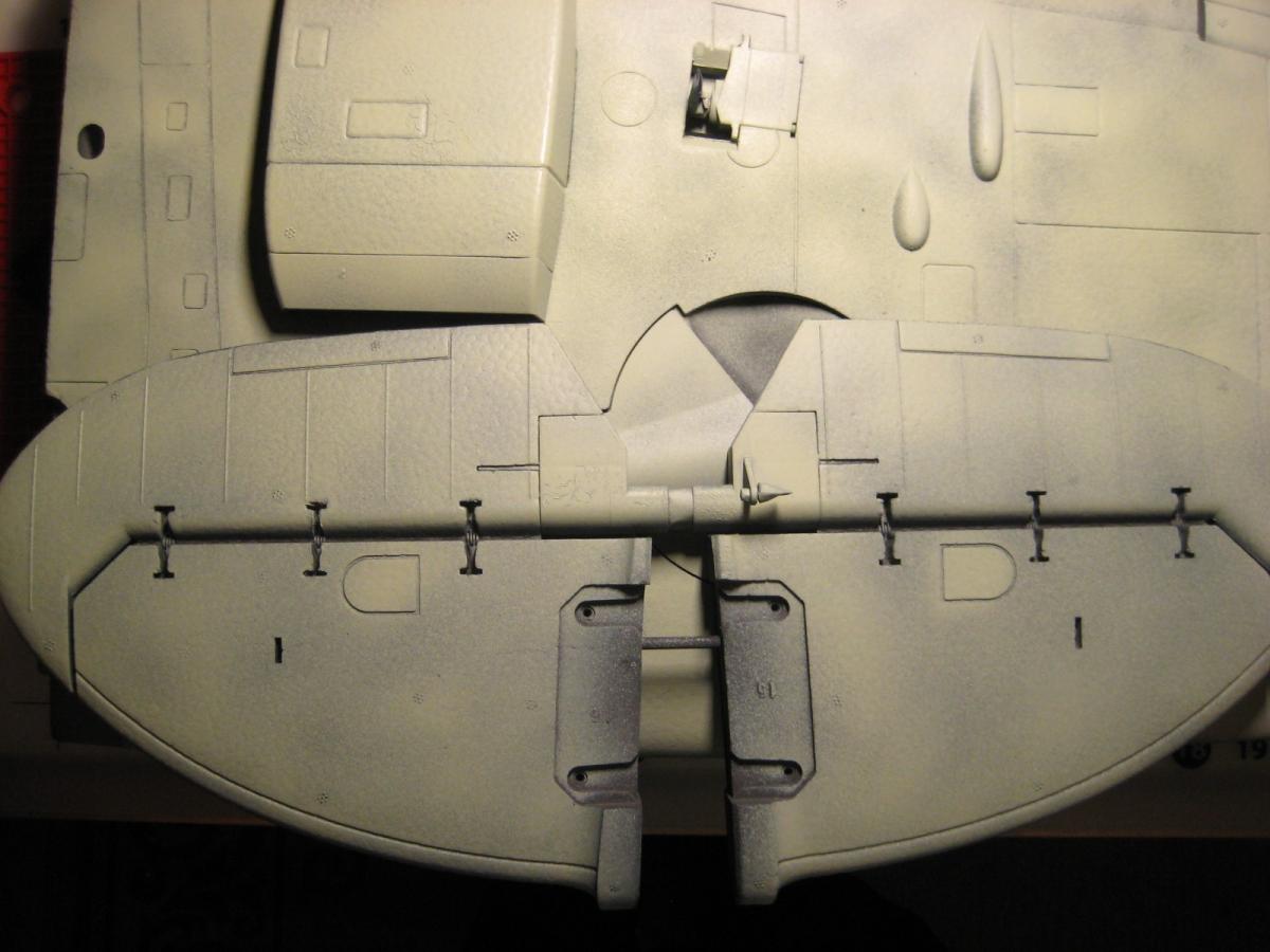

                                      Hey Y'all, Need some help here. I am trying a different painting technique called 'Black Basing'. I have primed in black and I am now shooting several layers of color for the Seafire. I cannot tell anymore whether I am getting a 'distressed look' or whether I am just painting the darn thing very slowly. I have shot the paint dark to light in shades, but this looks like there is just too much pigment and I am not accomplishing and weathering. I will paint one last coat of almost white thinned the same 50% thinner & 30% Flotrol to 20% paint. Pressure is 20-25psi with a dbl-action airbrush. Any ideas or should I simply weather it after all is painted? Humbly, LB
ID:	161433Click image for larger version
ID:	161434 ​​​​​​​ Click image for larger version

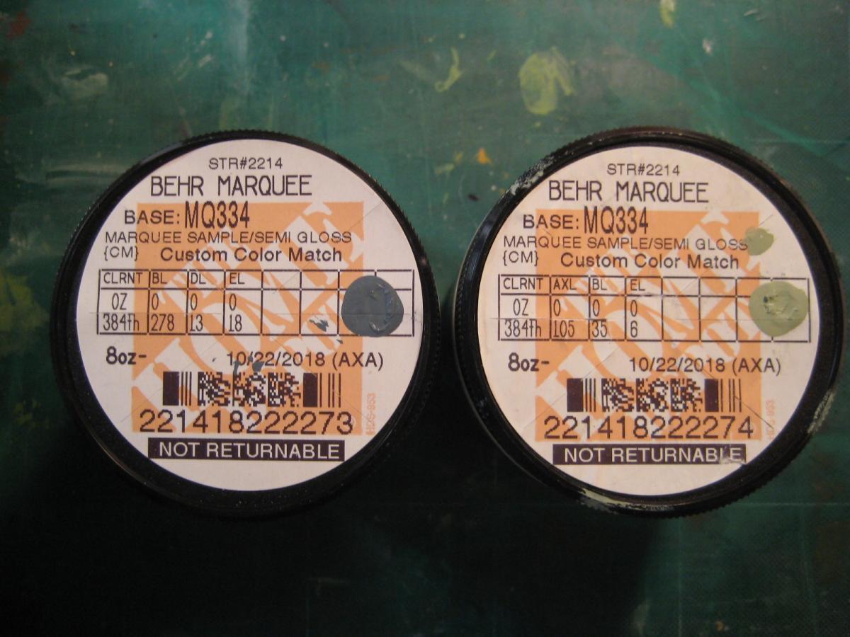

                                        Color Codes:
                                        Picture of Home Depot Color Codes for RAF Sky Type S (Under) and RAF Ocean Gray (Upper) Seafire Variant typed from Tamiya XF-21: Sky and Tamiya XF-82: Ocean Gray 2.

                                          #2100
                                          I like it...…. carry on! :Cool: And sure, after you are done, buff it with something.... 0000 steel wool works great, but will stick to ANYTHING metal or magnetic... 1200 grit Wet Dry works... Anyway, buff it lightly in the airflow direction, then do a little more panel line highlights and chipping... :Cool:
