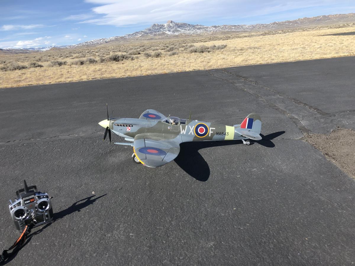

            Hi ICM: I can only relate what I use on my Spitfire. I have had it 5 years now, have a ton of flights on it. Banged it up a bit on occasion, but still all original parts. Haven't had to trade out any of the major parts yet. I have only flown it from hard surfaced runways, never on grass yet.
            I CG at the book value of 90mm.
            For what it's worth these are some of my settings:
            Aileron: High 80 Mid 75 Low 46 Expo 20%
            Elevator: High 80 Mid 70 Low 47 Expo 25%
            Rudder: High 110 Mid 100 Low 90 Expo 20 %
            I usually use low rates for my flying, and mid to high for rudder.
            On my flaps, I use full flaps at the scale position of 85 degrees down (almost straight down.) I have a mid-flap position, about half of that amount that I use occasionally, but I almost always land with the full 85 flap down position, with some power and almost always use a wheel landing, but if I mess that up, I can either go around if it's a real bounce, or just reset up for a three-point, which works well, too.
            In my Flap System on my Spektrum DX18, I use a flap to elevator mix of: flaps up: -7%, Mid Flap: -20%, and full flap -20%.
            That's just my particular settings that I use. As I say, this plane is still around after 5 years of flying, so it works for me, and looks fairly realistic. I always try to fly all my warbirds in a scale fashion, and fly only maneuvers that they were capable of and expected to do in flight and combat (NO 3D stuff!).
            These settings might give you some ideas how you want to fly your plane. I think for the maiden, we used the stock book recommended values, and I think you'd be fine there for your first flights,, to adjust as you wish after you feel comfortable with it.
            Good Luck!
