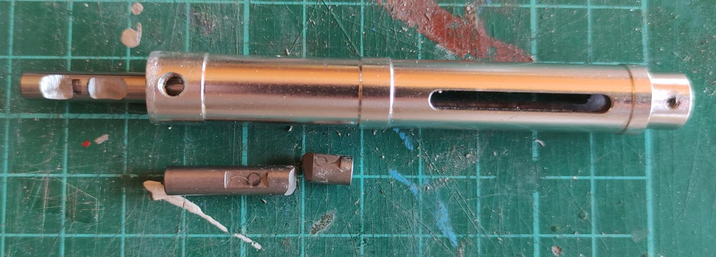

    I'm not sure that you can go through to the pin as you are attempting. Sorry not much help, maybe a smaller diameter rod?

      jeffco, there is a slot on the left side of the strut in your picture. in that slot is a pin, removing that pin and the strut comes apart. that pin is press fit into place so to get it out you will need to drill a hole in the right part of the strut to drive the pin out. or get a pair of pliers that can grab it tight enough to pull the pin out. being it is in the landing gear the press is going to be pretty tight so at that point the strut is trash.
      Joe
        • 5385
        #2983
        My understanding of the picture is he's already taken the strut apart and that the drift is in the lower part. Good point that he may have to drill through to the pin.

          i was just guessing. that's all that is left to take apart, though the mushrooming of the aluminum at the top of the strut puzzles me. must be from the mishap. if he is trying to remove the broken pin from the top i would slit it with a Dremel cut off wheel enough to let me spin it. then once it spinning i would use the cut off wheel again through the set screw hole (thats why i never throw out my used up cutoff wheels) to give me something to put the punch on to get it moving in the right direction. i dough its glued, there is a peace of the break that is holding it in if it does not fall out, its harder than the aluminum so correcting that will be difficult.

            Thanks for your advice. I'll have one more try but then order a new leg. I've only just seen the spares list for the first time and I'm impressed, it's all there and at fair prices. I'll buy prop blades too.

                But my leg is now repaired and ready to fly again.
                I had trouble getting the pin out because the drift was too thick and I was hammering against the shoulder. It came out easily by using a pointed 3mm drill bit as a drift and the pin was not glued in as others reported.

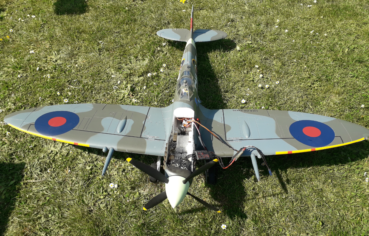

                                  Click image for larger version  Name:	SpitfireBurnt.PNG Views:	0 Size:	2.56 MB ID:	310717Hello,
                                  I have a question, apologies if this has been discussed.
                                  Is anyone using the BEC that came with the ESC of the plane? I had a separate BEC that caught fire and burnt the plane & the BEC battery.
                                  I have fixed her and wanted to go fly her again but I don't have a BEC battery and was thinking of using the BEC that came with the ESC.
                                  thank you for your advice/opinion,
                                  Cédric
                                  ps: If so, should I put a ferrite around the wire coming from the BEC?
                                    • 5385
                                    #2997
                                    Any idea why it caught fire? I assume you had a BEC properly rated for the expected load?
                                    I would think most that buy the plane use the stock ESC with internal BEC. There are a vocal select few that say they always run separate BECs or other power for the radio system. I've always used the stock system unless, in the rare case, I have a reason not to. Reasons would be major changes to the aircraft, servos, lights, etc or a specific technical reason such as it came with a linear BEC and not a switching BEC. The way I look at it the ESCs internal BEC when used within it's rating is less likely to cause issues than a separate one with extra connections, wire, and power source.
                                    I usually leave the ferrite rings on ESCs that have them but sometimes I need the extra inch or two of wire and remove them. Never had a issue either way.

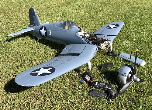

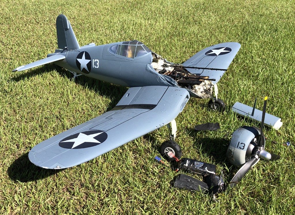

                                        @Fluffy78 In your initial post about the fire you stated your "battery" caught fire. Just to clarify was it the separate BEC battery or the main power battery? Or was it the BEC itself that started the fire?
                                        I've only had one fire in an electric airplane and it was due to snugging the fully charged battery down and letting the metal ring of the battery strap dig into the corner edge of the battery causing a very dramatic instant fire. This was about a year or so ago. Since then I have been very careful about how I strap in batteries. This was an expensive mistake. The only thing that survived was the gear, most wing servos and the empennage. I really hated loosing the almost new battery too.
                                        I mention this encase your main battery is what caught fire and maybe you had strapped your battery in with the metal ring at the battery edge and your last landing may have been enough to make it dig in and cause the short.
                                        Like many here that have flown these electrics and mainly FLRC/Freewing planes for some time if you leave them pretty much stock and don't abuse them too much they are trouble free. As much as I can 100% determine I have never had an an electrical failure due to the built in ESC/BEC. I would reserve judgment on the blueboxes though....
