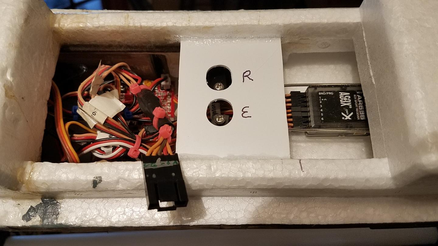

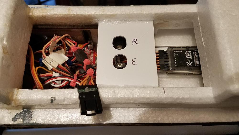

    Guys, could I trouble someone for a picture of their RX location please, im using a AR636.
    Many thanks in advance.

      Necroscope I've got my AR636 just behind the Rudder and Elevator servo upside down with the antenna traveling towards the back of the fuselage. In the photo below I hope you can see the location as things are kind of cramped in there. The photo has the fuselage upside down with the forward section to the left and the aft towards the right. I also have the Mr. RC Sound card (the older version V4.1 because the newer Aspire Board was a little too large) crammed into the area forward of the servos, also upside down. To complicate it further, I connected all 3 wing servo wires (gear/aileron/flap) into a locking 5 pin connector so I don't have to plug and unplug as many wires (now only one) when transporting the bird and assembling at the field. The white styrene cover over the servos is only to keep the connecting wing wires from tangling in the servos when attaching the wing. Hope this gives you an idea on where to locate your receiver. I did have to slightly re-bend the Rudder and Elevator servo control rods around the receiver so they did not interfere with operation.

        Very interesting Hugh, thank you, I never thought of that.
        My original intention was to ship with the wings off, but she will just go in the car in one, so i will ship her like that and save the faff at the field.
