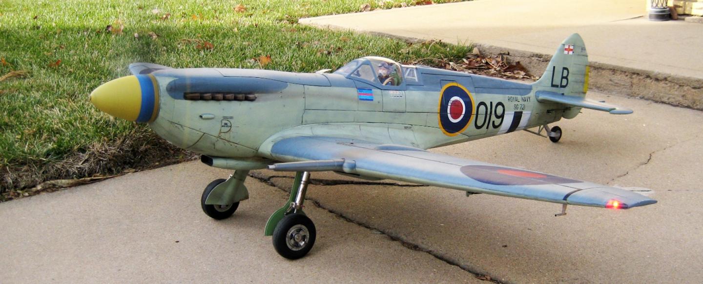

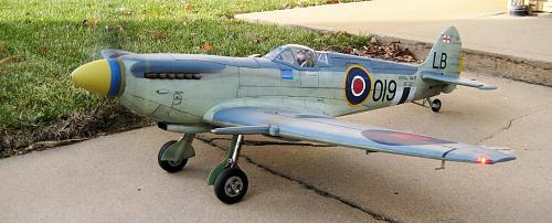

        Splat Thanks for this link. I fly Futaba 8J, so I am unaware of option for slowing a servo's motion. Also, ya gotta get a Spittie. Great flyer and IMHO the most beautiful design in aviation. Best, LB

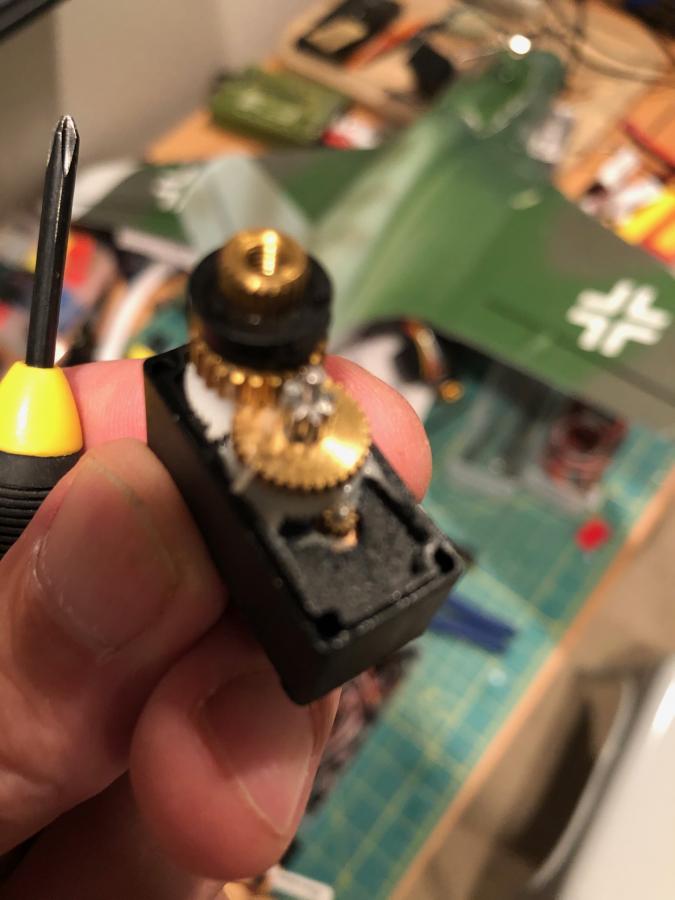

                  #2828

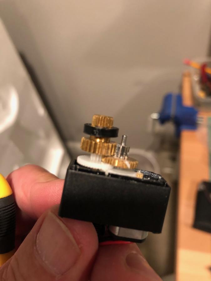

                  Maiden flight of the Spit today, what a great flyer she is! Nose over on landing but will get that sorted. No bad tendencies really!
                  Got a second flight in and afterwards was mixing in some up elevator with the flaps. Checking the throws, I heard a weird screech, moved the
                  elevator a few times and the elevator servo started whirring continuous. At home I confirmed stripped servo! Thankfully this happened on the ground!
                  I also found that these metal geared servos have plastic cogs as well as metal....checked elevator movement and rod/tubing to make sure nothing was binding that could
                  have caused this servo strip, all ok.
                  I must have been unlucky with this particular servo as I have not read anywhere else in forums this is a major concern.
                  Ordered a replacement today so hoping that is in before next weekend!
                  She hangs now with her little brother (flitetest version) awaiting the new servo.

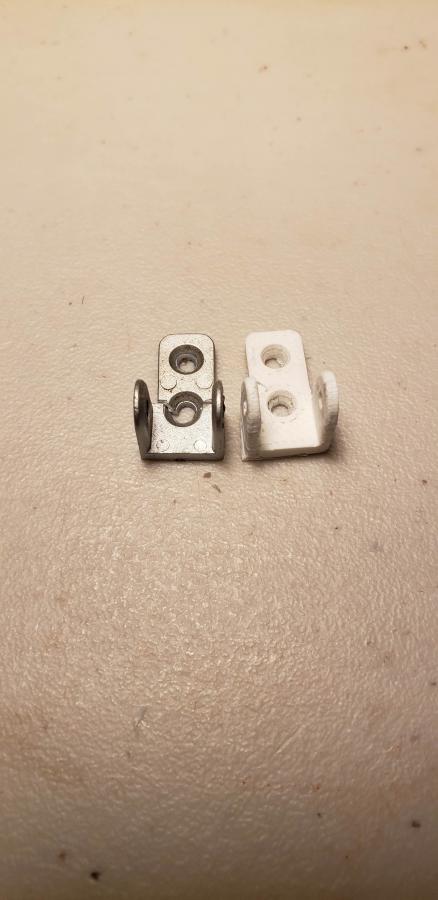

                    #2829

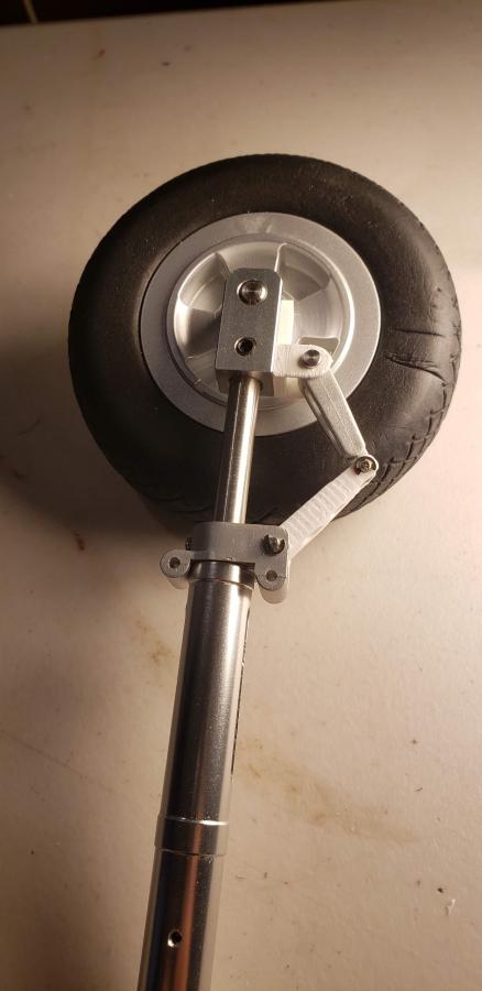

                    Scissor Link?
                    Greetings, I broke the link on one of the struts and by mistake ordered the wrong side replacement, I tried to disassemble the gear to move the links and broke the new one in the process. Is there an alternative to ordering the MLG again? I found this old post, does anyone know if these work? https://www.motionrc.com/products/fr...ear-damper-set
                    TIA,
                    Santa

                      Originally posted by santanig5
                      Scissor Link?
                      Greetings, I broke the link on one of the struts and by mistake ordered the wrong side replacement, I tried to disassemble the gear to move the links and broke the new one in the process. Is there an alternative to ordering the MLG again? I found this old post, does anyone know if these work?TIA,Santa
                      S5, Not certain about the P-51 Strut Brace. There is a 3DP alternative. Here are two designs (don't have the author's names, but kudos) that have been posted before. The French Version has a notch for the strut. Both designs are not the MLG side, however Best LB

                        #2831
                        [ATTACH]n268954[/ATTACH]
                        Thanks for the reply, I have this file, but need its mate piece. Also, broke the piece on the wheel hub in my attempt to swap.

                          #2832
                          Originally posted by Alpha
                          Hi CDN_Iceman, sorry to hear about that issue. Unfortunately, that small part isn't available as a separately purchasable spare part; frankly this is the first I've seen it requested in the world. I suppose there are two feasible options, neither super easy but both at least possible.
                          The first option would be free from us, which is always nice :) I could send you an .STL file of that linkage for you to 3D print yourself or have 3Dprinted locally. It's a small plastic cosmetic non-load-bearing part, which is an ideal candidate for 3DP. I'd be happy to convert and send the necessary file to you. I did the same process for Stuart the other week when he lost his Spitfire's stock plastic cannon. Quick and easy!
                          The second option doesn't require a printer, but would require patience: You could contact our tech support team at www.motionrc.com/support and ask them to enter this part in their New Parts Request form. From there, the request would be sent to the factory and they'd take the necessary time to evaluate, issue a new part number and price, advise a production time, then we'd order it (and a bunch of others since we can't order just one of something on a mass production line), then they'd ship it to us, whereafter we'd be able to sell it and ship it to you.
                          Fingers crossed you have access to a 3D printer... otherwise, contact the tech support guys and they'll do their best to get your request into the process.

                          Hello Alpha,
                          I have broken my scissor links and found that one was created for 3D printing but not its matching piece. Did you create it? Can it's matching piece be created or direct me if it already has.
                          Thanks,
                          Santa

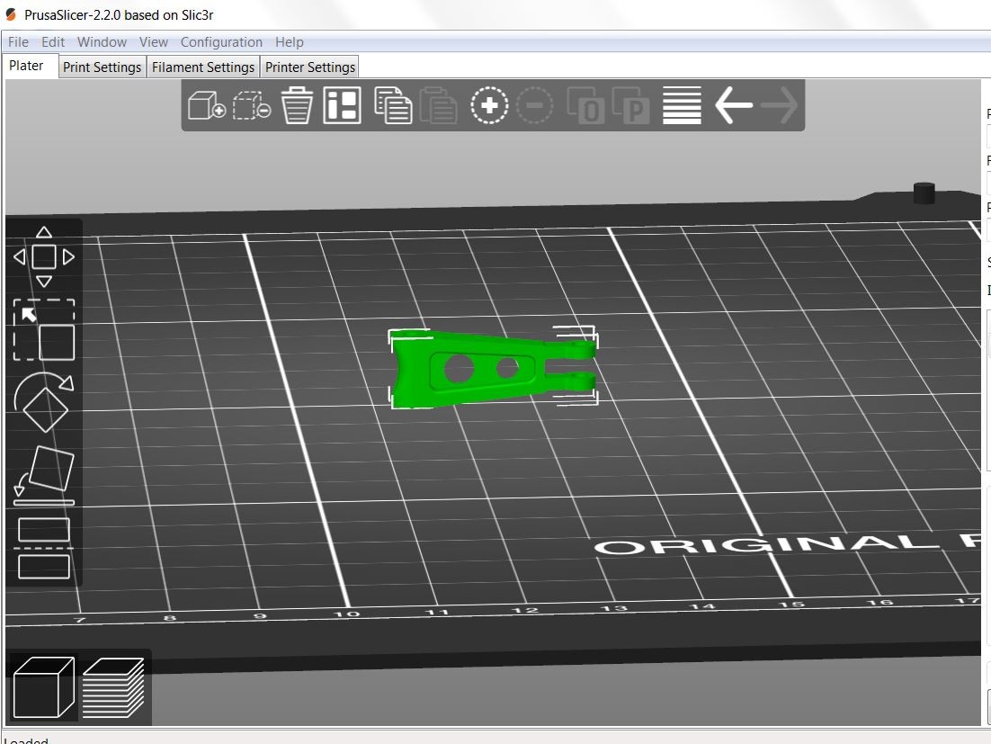

                            #2833
                            Unable to find what I needed, I designed my own, now if someone more skilled than I can design the other part of the scissor link we will have a complete set.
                            https://www.thingiverse.com/thing:4571900

                              • 4869
                              #2834
                              Unable to find what I needed, I designed my own.L]
                              S5, Thank you for your STL FIle and I presume you are talking about the "lower strut arm" then. I have the Spit, just haven't flown it much this year. I will look at it, I have a Hornet to finish, but I'll put it on my to do list, if someone else doesn't step up in the meantime. Best, LB

                                #2835
                                Did my 217th flight this morning and I encountered the same problem (elev servo stripped). Unfortunately, it happened in flight resulting in a total destruction of my spit, motor included (bent shaft). However, the Spitty remains a very good model and I'm up to order a new one but I was wondering if elev servo of the Flightline Spit has the same spline than an hitec for instance (to keep the so handy flightline servo arm) ? I also checked the other servos and the rudder one is about to be stripped as well. Could this strippings come from the crash and the lost of control originating from another cause ?

                                    #2837

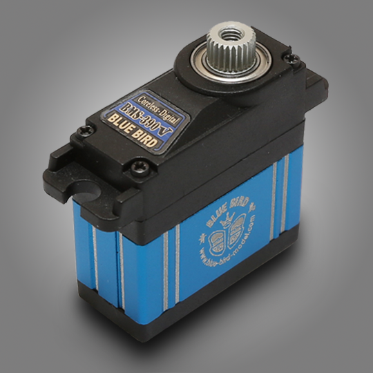

                                    Hi all. Got my "new" Spitfire since the former one has been written off by a faulty elevator servo. Nevertheless, I was really happy of this plane (she died during her 217th flies and all components were stock with the exception of a spinner and some props). At present, I have only recovered the two retracts and the sound system (surprisingly both speakers stuck in the under-wing radiators remained intact). Even the wood battery plate has burned in the crash as Lipo battery ignited on impact .
                                    Hope the new one will bring me the same satisfaction. The built quality is a bit off compared to before with spots, scratches, lacks and over-thicknesses. A slightly gatoring level (for want of a better word) a bit higher as well. Nothing severe but annoying, maybe we become demanding when we are used to FL quality. However, there's an improvement with the engine fixing on the support : actual screws and nuts instead of the previous self-tapping screw in the plastic.
                                    Unfortunately the same scrappy hybrid servo but I've already ordered a more serious one and thinking over a double elevator push-rods, the second not being that difficult to set (output just above the rudder one, on port side).

                                        Asuka what servos did you order?
                                        • Asuka
                                          • Aug 2020
                                          • 12
                                          • South of France (Provence)
                                          #2840

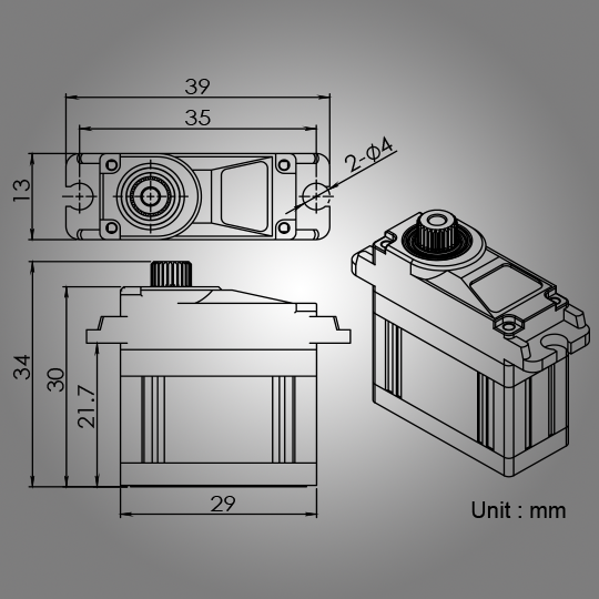

                                          Blue Bird Digital Mini SERVO BMS-390V. Size should fit perfect in the FL Spit support, same 25 T teeth spline (Futaba like) allowing to keep the so handy FL servo horn but with full metal gear, HV / DS / Heat Sink and last but not least 5,4 kg / 0.11sec / 22.5g.
                                          . Click image for larger version  Name:	20170925150309odog43.png Views:	0 Size:	279.5 KB ID:	272820
                                          Click image for larger version  Name:	20170822084353r8nsu1.png Views:	0 Size:	364.6 KB ID:	272821
                                          You can order it at HK as I did under the TGY label https://hobbyking.com/fr_fr/turnigyt...sec-22-5g.html
