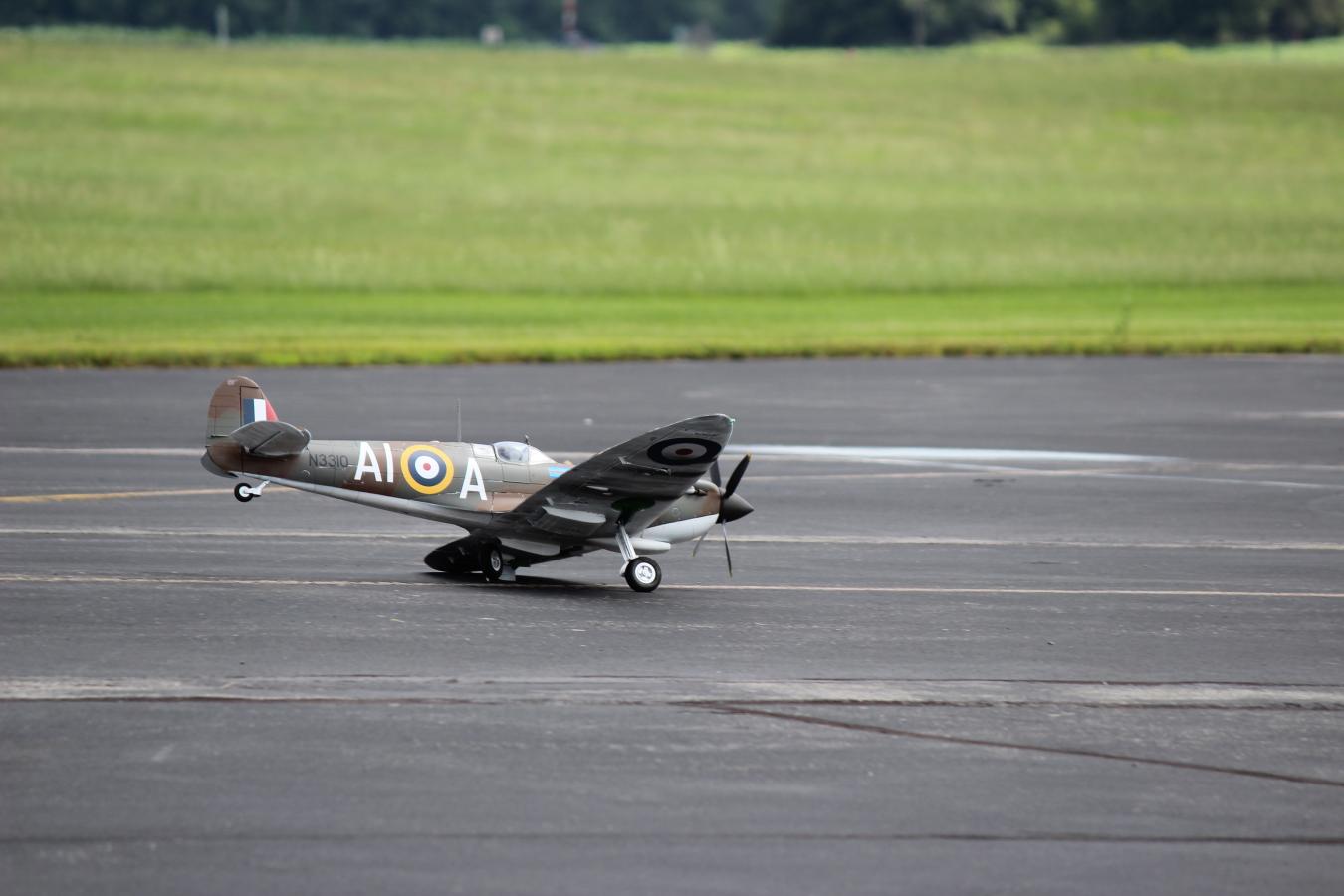

      I am new for RC and In Europe you can order the spitfire 1600mm. I just ordered one and it looks very good. Great quality. I had a probIem with one aleron servo and motion RC helped me great.
      I bought some decalls from Callie graphics so that the spitfire looked a littlebit dutchie. I put them wet on the plane. I set the plane up with As3x / Safe 6ch receiver.
      Love the plane.
      The forum is great to surch information. Thanks

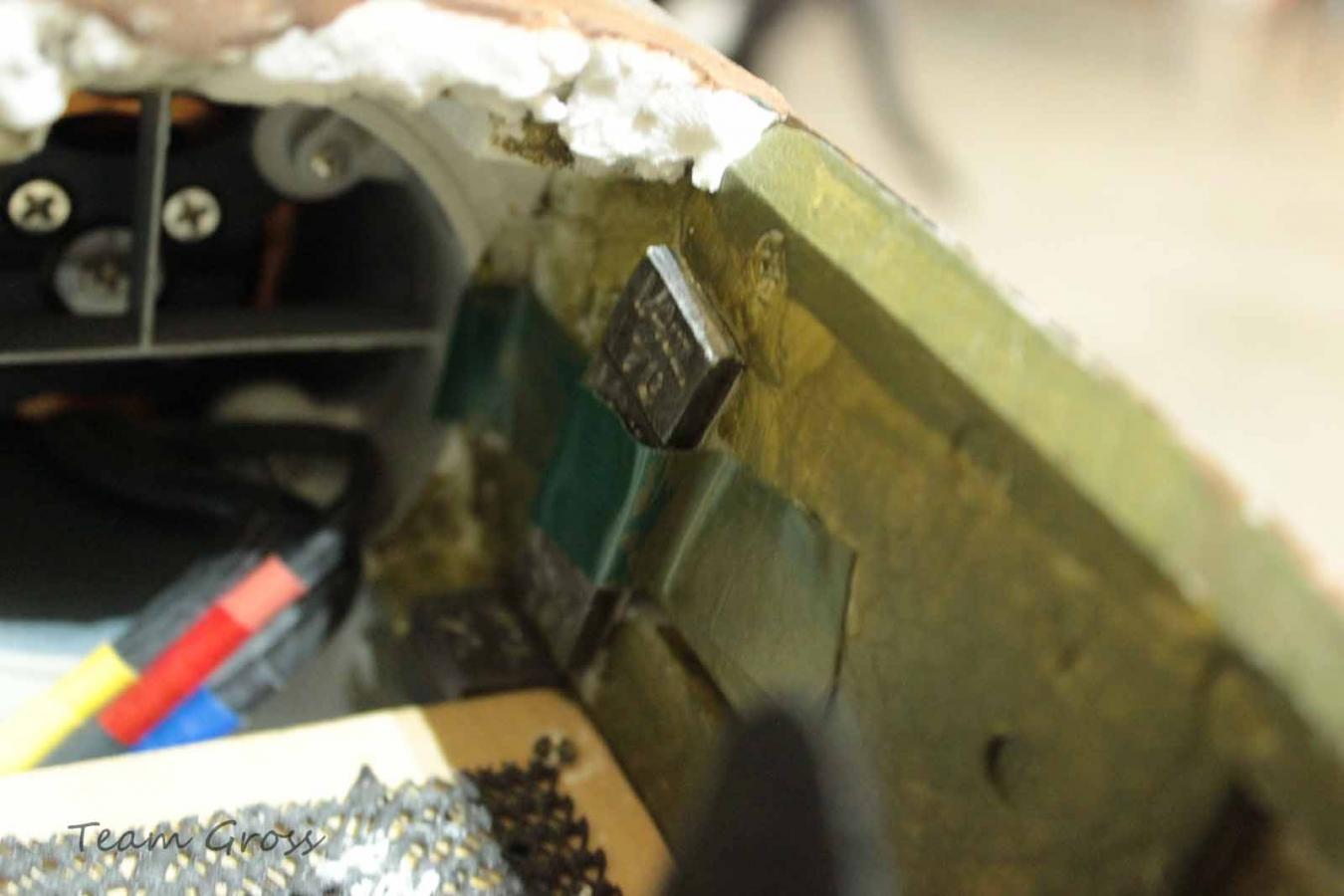

                                Hey Guys! Seems that for some reason, some of the Spitties were tail heavy and my CG needed to be corrected from the stock point. Mine had a tendency to fall out of the sky and landings always resulted in landing gear popping out. Here she is at Nefi trying to do a Summersalt on landing Click image for larger version

                                It would literally swap ends. I commented to a friend of mine as we watched her lawn dart once again that maybe to CG is off and she's nose heavy.
                                Time after time until the fuse split and major repairs were needed. Finally, I said screw it and added 2.5 oz up front. Click image for larger version

                                So now, I put my 4500 6s all the way forward and my 5000 6s about 1/4" forward of the aft edge of the wooden deck. Flies like a dream!! Totally different airplane, she lands like a lady, sort of, you still have to be prepared to add in right rudder which is in keeping with the real airplane (actually, I believe they add left rudder to the real Spitfire because the RR's rotate in the opposite direction to the Packard Merlins). The fellow who did the European Spitfire demo on the Motion RC videos mentioned the same thing, if you refer back in this thread, you can find it. Don't know why, some fellows have had great success with the stock CG right out of the box, but some of us, well not so much.

                                  My revelation came at post #2438 continuing on #2461 and 2462. Here is Stuart's video confirming what I suspected.
                                  Makes a world of difference with a difficult Spit

                                    Hey Guys! Seems that for some reason, some of the Spitties were tail heavy and my CG needed to be corrected from the stock point. It would literally swap ends. I commented to a friend of mine as we watched her lawn dart once again that maybe to CG is off and she's nose heavy. Time after time until the fuse split and major repairs were needed. Finally, I said screw it and added 2.5 oz up front.
                                    Same here with mine. Book CG is 90mm if I remember and I ended up flying Spitfire #2 at 94mm, but had to add 1 ounce of lead to the nose and I'm using a relatively heavy 5000 weighing 755 gr, pushed all the way forward. I'm getting 10 minutes of flight time on that battery! It still is a bit tail heavy there but I like the way it handles a little better, even if it is a bit pitch sensitive. I also installed the MR RC sound system with the transducers forward of the CG line which no doubt added a bit of nose weight. With my first FW Spitfire, I ended up with almost 2 ounces of lead in the nose (but that one is another story where the carbon fiber wing tubes separated inside the wing after some 200 flights during a tight split S and came apart in mid-air).
                                    I've been told that the left turn on adding power at take-off (consistent with most tail dragger warbirds, especially the Corsair and P-51 for me) is from the prop wash circling from the counter clockwise prop rotation and the air circles around the fuselage from prop on right side, then circling counter clockwise under the fuselage and coming up and over from the left side, thereby "pushing" against the left side of the vertical stabilizer (wow, what a horrible explanation-hope it makes sense).

                                      Guess that really is the bottom line trim it to where you like it, personally, I have a bunch of 4500 6s batteries because of the P-40 and they work so well in the RV-8 and the Avanti at a good price point comparatively. Therefore I CG'd it so that they fit all the way forward and the 5000 sits back a bit. I like all my birds to fly relatively the same so the Old Guy brain doesn't have to work too hard and I can sit back and enjoy the flight. The Spitfire has it's own personality because of those unique wings and narrow landing gear but that's okay, you just become a Spitfire pilot for a few minutes. Let's face it, that's what we all do.
