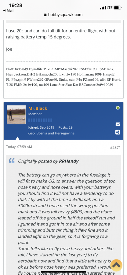

                      #2870
                      Originally posted by bobolos
                      what is the safest c rating of 6s 5000 to use in the spitfire please
                      I use 20c and can do full tilt for an entire flight with out raising battery temp 15 degrees.
                      Joe

                        #2871
                        Originally posted by RRHandy
                        The battery can go anywhere in the fuselage it will fit to make CG, to answer the question of too nose heavy and nose overs, with your batterys you should find it will not have a tendency to do that. I fly with at the time a 4500mah and a 5000mah and I once used the wrong position mark and it was tail heavy (4500) and the plane leaped off the ground in half the takeoff run and I gunned it and got it in the air and after some trimming and butt clinching it flew fine and it landed light on the gear, so it is forgiving to a point.
                        Some folks like to fly nose heavy and others like tail, I have started (in the last year) to fly aerobatic now and find that a little tail heavy is ok as before nose heavy was preferred. I would fly You're nose heavy as it has been stated many times on the forums until you get comfortable with flying any plane it is best.
                        The beacon hobby coat, I have some and have not used it yet till the minwax is gone so I can't say that or if it will works better.
                        Tnx for the reply.
                        Beacon hobby coat is awesome. I coat all my planes, at least with one thin coat. However, on my Night radiant glider, after putting two coats, it screwed my CG so I had to move my battery forward 4-5 centimeters. Fortunatly, I had enough room in the canopy to do just that.
