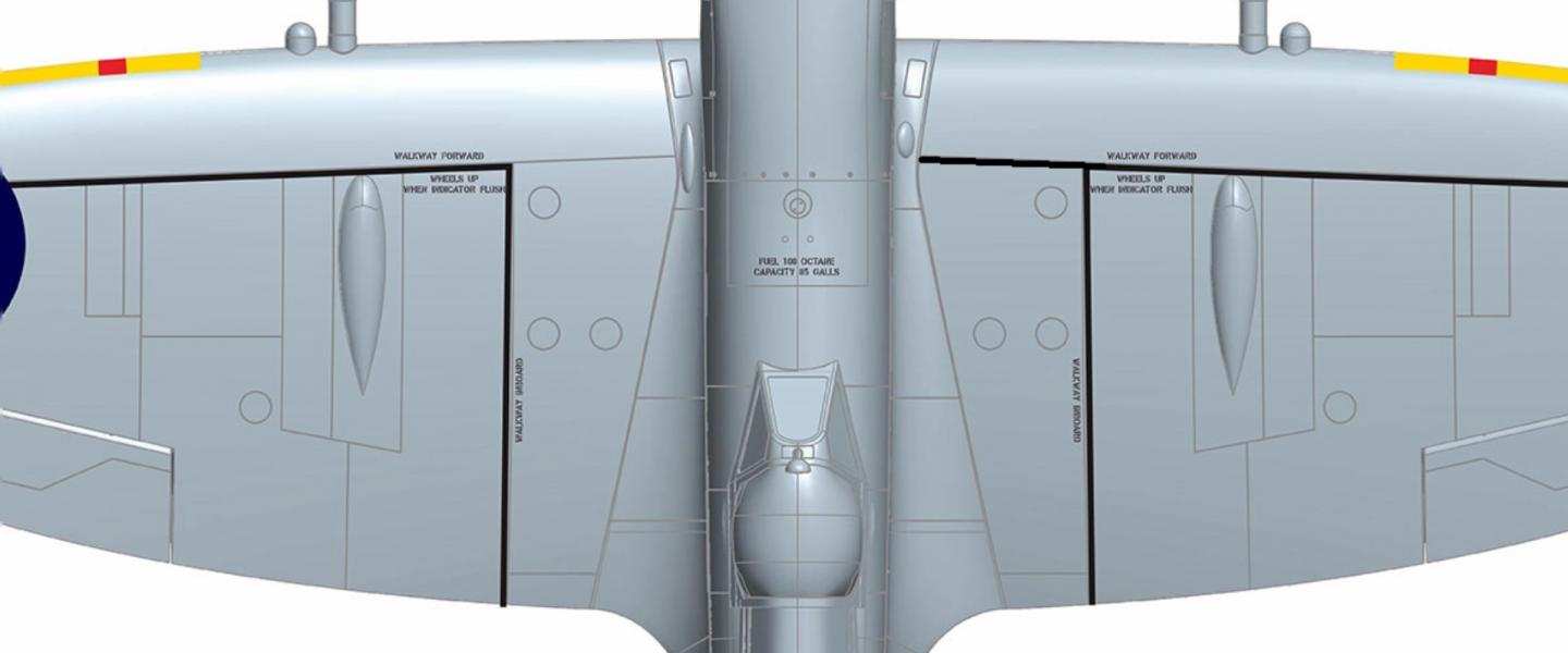

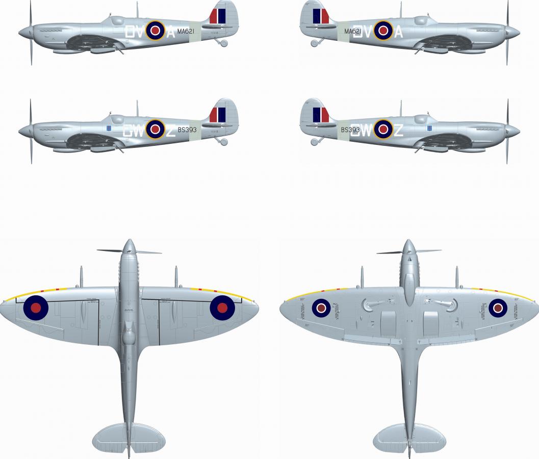

                  Got these from Alpha...Decal placement sheets...

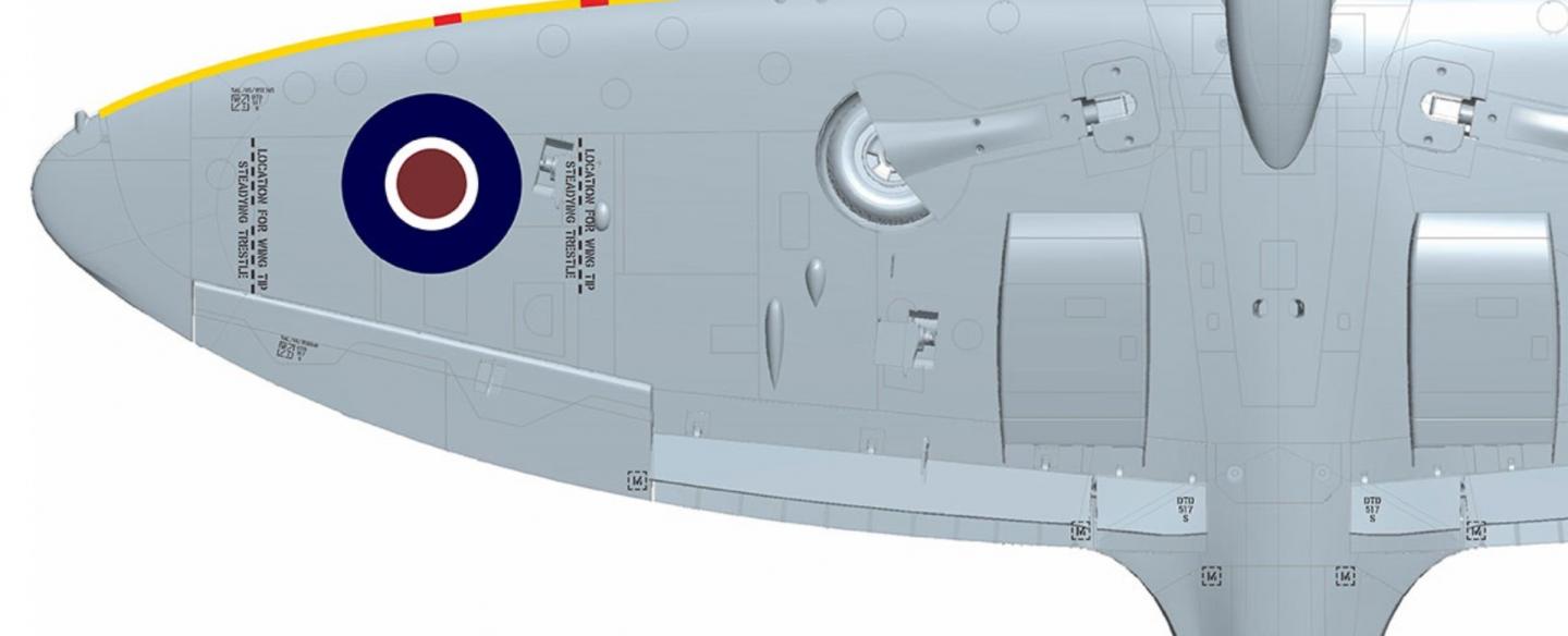

                    #869
                    Haha, simul-post.
                    Here are additional close ups showing the wing text in greater detail.
