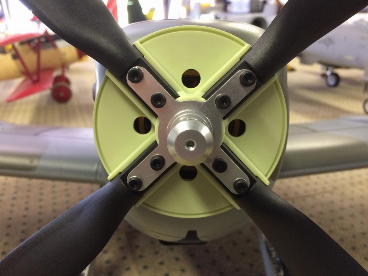

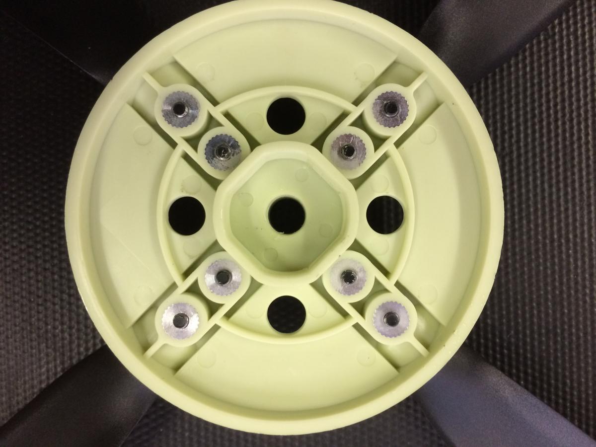

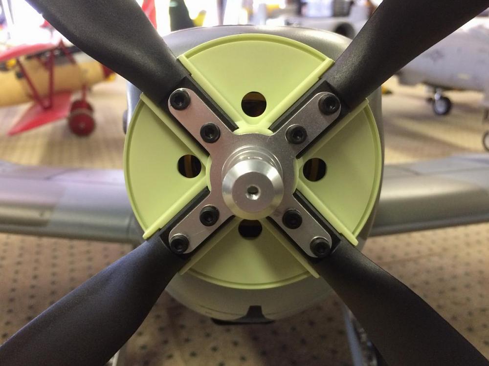

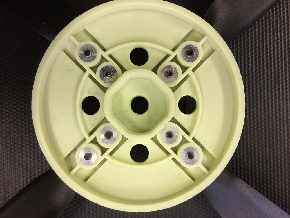

        For those wanting to see how the prop was improved...

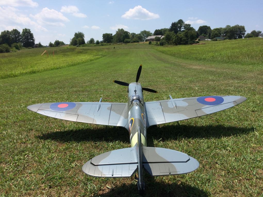

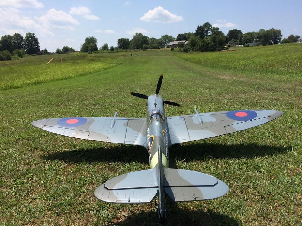

          Maidened the Spitfire today, CG at 90mm, no trim, flys perfect...another winner from Flightline and Motion RC.

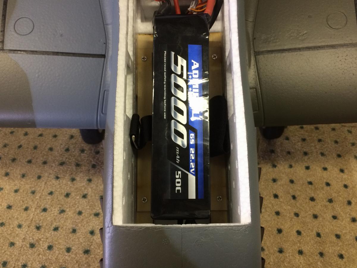

            Did you have to add any weight to get CG?

                TI.....thanx for the pic of the prop assembly. That cross brace is great and finally captive nuts on the back plate similar to like FMS did.
                Would like to buy that cross brace separately (for some mods to my FMS stuff) but it isn't listed nor is it shown with the props or the spinner/hub. What's up with that :Confused:
                I can see it now....... someone wads the prop assembly with a ground strike and mangles the blades/spinner and cross brace.:Scared:
                What does that person do when he orders the props and spinner and has no cross brace :Angry:
                MOTION?????.....:pop

                  What size battery did you use? I think Ryan mentioned in the video he was using a 5000 all the way forward.

                    Hi TiredironGRB , Very useful professional engineering performance...thanks so much.

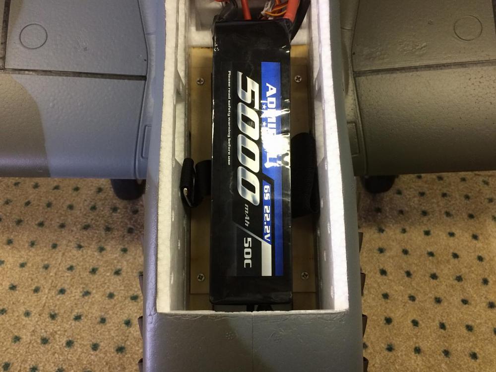

                      Nope, I'm using a new Admiral 6S 5000 and lining up the end of the battery with the front of the hatch opening.

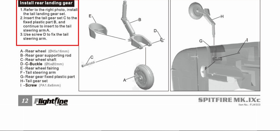

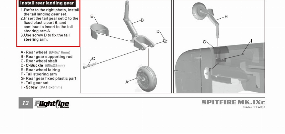

                              Grossman, here's a project for you..

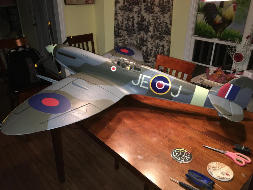

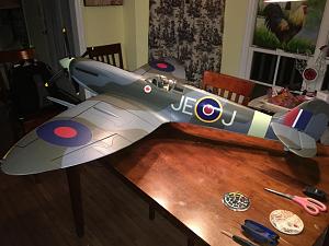

                                        My Spit is now ready for action. I did the Johnnie Johnson JE-J livery. The wrong plane number came with the decal set; so, Callie is making me another one. I don't like water-slide decals. So, I've got a vinyl nomenclature set on order from Callie, too.

                                          Nice pics fellas. Who's going to be first to do some invasion stripes?
