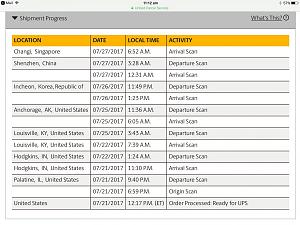

      Mines getting further away! G'day Alaska lol.
      Has it hit Sydney yet mate?

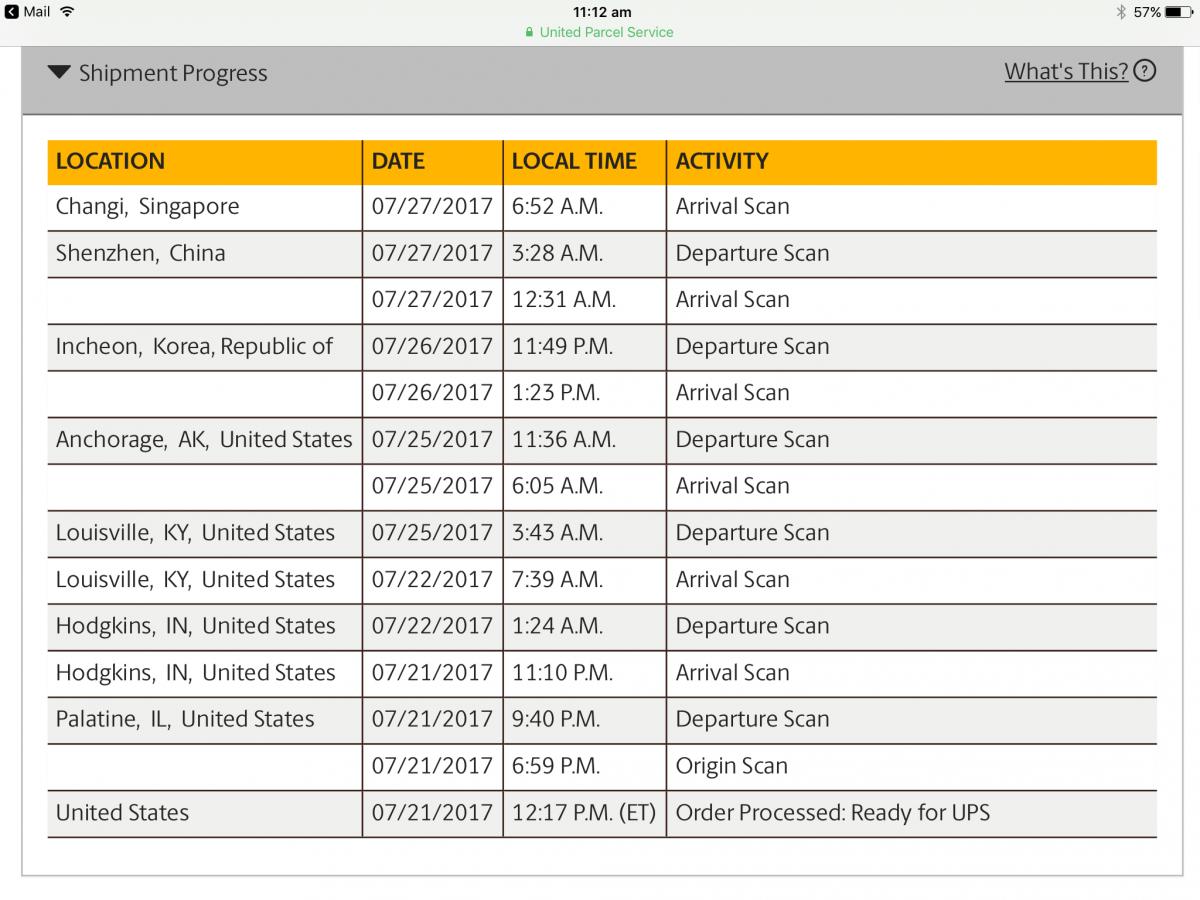

        Hey Phil, mine doesn't go through Sydney, comes to Perth straight from Singapore. (After Alaska, Korea, china). Here's my latest:
        Hurry up Todd lol - pretty sure the stripes are going on mine and want to see how it looks. If you can do the a-10 in a arvo, this one shouldn't take long. ;)

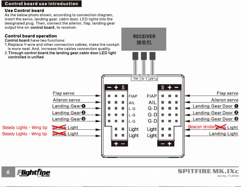

            Anybody else having issues with the "blue box"? I hooked everything up like the manual said and neither gear and flaps and aileron on right side wouldn't work. Also, the lights are labeled wrong in the manual, the steady on lights are on the left side and the flashers are on the left side.
            So, I "Y" connected gear, flaps and ailerons and everything works accept the lights don't work now as there's no power to the blue box.
            I may have to fiddle with hooking things up to the box one at a time and see what is what. Maybe the gear are supposed to be in "gear door"? I remember on the 90mm F-104 the "green board" was mis programmed and it took awhile to figure out what was what.

                Hey Beeg, Remember the polarity mirrors from side to side.

                  Yeah, I made sure of that. Just fiddled with it some more. Hooked the flaps up to the box and they worked. Now I have lights! Then hooked up the gear to the box and they worked! Go figure. Think I'm going to leave the ailerons on a "Y" and go with it.

                    Also, this is what I have for my lights.
                    Click image for larger version  Name:	MkIX_ControlBoard_New.jpg Views:	1 Size:	224.5 KB ID:	89612

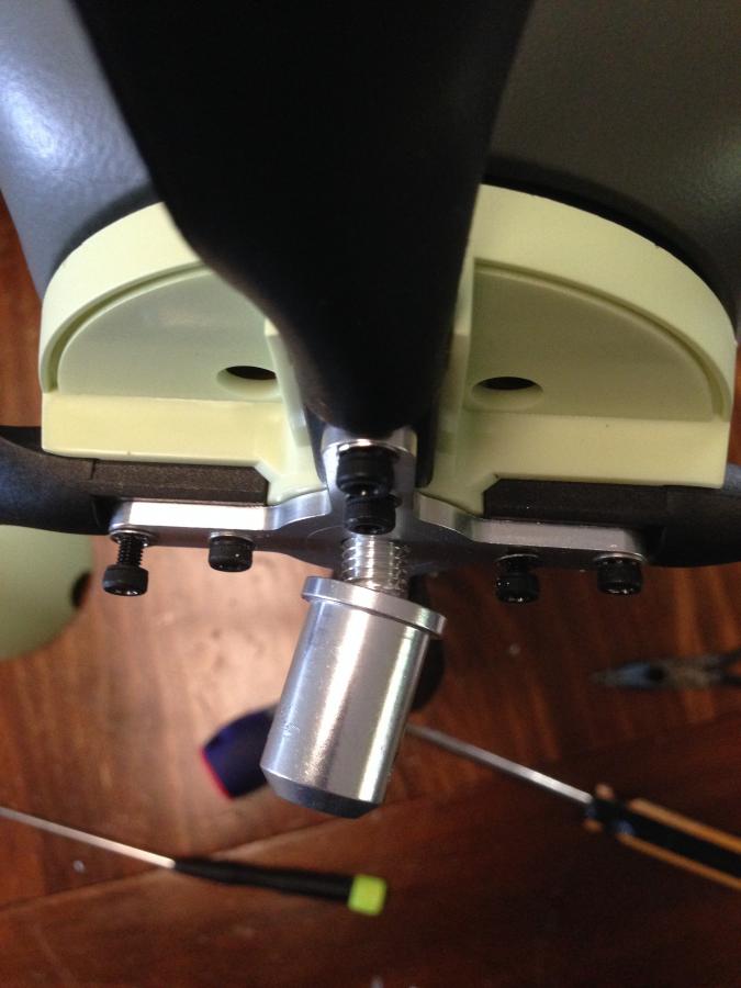

                                    Hey all, i need help, as i was putting the propeller assembly on the motor shaft. I found that that the propeller fixing bolt was incredibly tight, i kept turning it until it no longer moved at all, which didn't make it to the end. I then tried to unscrew it to examine it but found it stripped the rings and now it doesn't go back and forth at all, it just wiggles around! It won't come off at all, no matter how much pressure i apply! The propeller blade screws also got too tight to screw in all the way.
                                    Now i'm thinking i have to get a new motor shaft and propeller fixing bolt
                                      #938
                                      Yes, you will need a new shaft and nut, never force anything that's tight and on the prop screws you should run a drill bit through the other aluminum cross and the blades but be very careful to not let the drill bit touch the aluminum insert in the green backing plate.
                                      If you're nor comfortable doing this I would get with an experienced hobbyist for some help.
